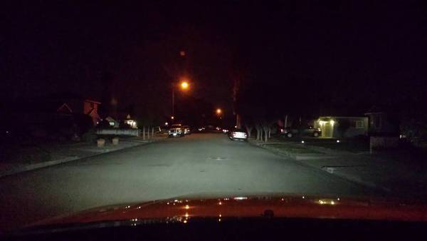

    Sorry, haven't had a chance to get any good pics.
    Here are a few simple pics I took from my phone on my cul-de-sac. One picture is just lows, the other is highs.
    As you can see, when the highs are on, the car on the right becomes well lit, the sign reflects like crazy, and the house on the left (which is the upper corner of the projection) is also lit pretty decently.
    I do not at all believe the highs are only 3000LM, unless by chance the rating means that turning high beams on increases output BY 3000LM, that I might believe. The lights are easily 2X as bright with the highbeams on.

    Maybe its just that set of pics but output doesn't seem worth cost. Here is a picture of my low beams in a similar setting and lighting area as your pic.
    Your bulbs have more brightness (assuming we are both aimed the same) in the center of the truck but my light coverage is much better across the road at a minor loss of center beam brightness.

    The output far exceeds the stock headlights, I wish I could show that somehow.

    I should also point out that the 2012+ and 05-11 housings are different and you get different results from the same bulbs.
    It's really hard to compare two different photos from different phones/cameras/etc. However, if you notice, your "glow" from your street lamp is larger than mine, which would suggest your camera used a combinations of settings that resulted in a brighter photo, which would also result in your headlights appearing brighter.
    I'm not at all comparing these to other headlights, since I haven't seen those in person. All I'm saying is that for the price, how they have performed so far, install cleanliness, and in comparison to the stock bulbs on my truck, I am happy with them.

    Finally, remember that these are 6K, which is quite blue (one of my dislikes about this kit - I wish it were more white). Assuming you are running stock bulbs (which it sounds like, based on your last post), you have a rather yellow light output.
    When you compare a more yellow light output to a more blue light output the yellow will always appear brighter.

    That's from me not holding still and my phone not focusing well with the lack of light. No camera trickery. If anything, its a darkened picture. Don't have my DSLR with me, just my S4.

    You're running a $65 set of halogens that last like 100 hours but these LEDs aren't worth it? Interesting concept.
    And no, that is not motion blur. The entire photo would be blurry if that was the case, but the rest of the photo is decently sharp - that blob is exactly the result of overexposure at that part of the frame.

    I'm twice as close to the street light as your picture shows you. I'd be interested in what your camera shows in brightness of light output and street light exposure at a similar distance to my picture.

    I'll take more photos, sure. I'll also post the settings I use and you can take a photo with the same settings - ISO, Aperture, Shutter Speed, and White Balance. Different cameras probably but it should be pretty similar. I have a 5D2 and a 7D - what do you have?
    What I don't understand is this, you come in here with a photo where the camera settings clearly result in a brighter overall photo, then claim that your bulbs are brighter and therefore purchasing the LED setup doesn't make sense, and at the same time suggest that my setup is less reliable than yours. And really, you have no evidence to back up any of your claims.
    Your street lamp is MUCH further away than mine. Look at the Prius parked under my street lamp - it looks huge. The full sized truck parked under your street lamp is so small I can't even identify the make. Yet, despite that, your overexposed blob is far larger than mine - indicating you had more aggressive camera settings resulting in a brighter photo. This is exactly why YOUR basis for your conclusions are, well, baseless. Posting your photo and saying "mine is brighter" is ignorant.
