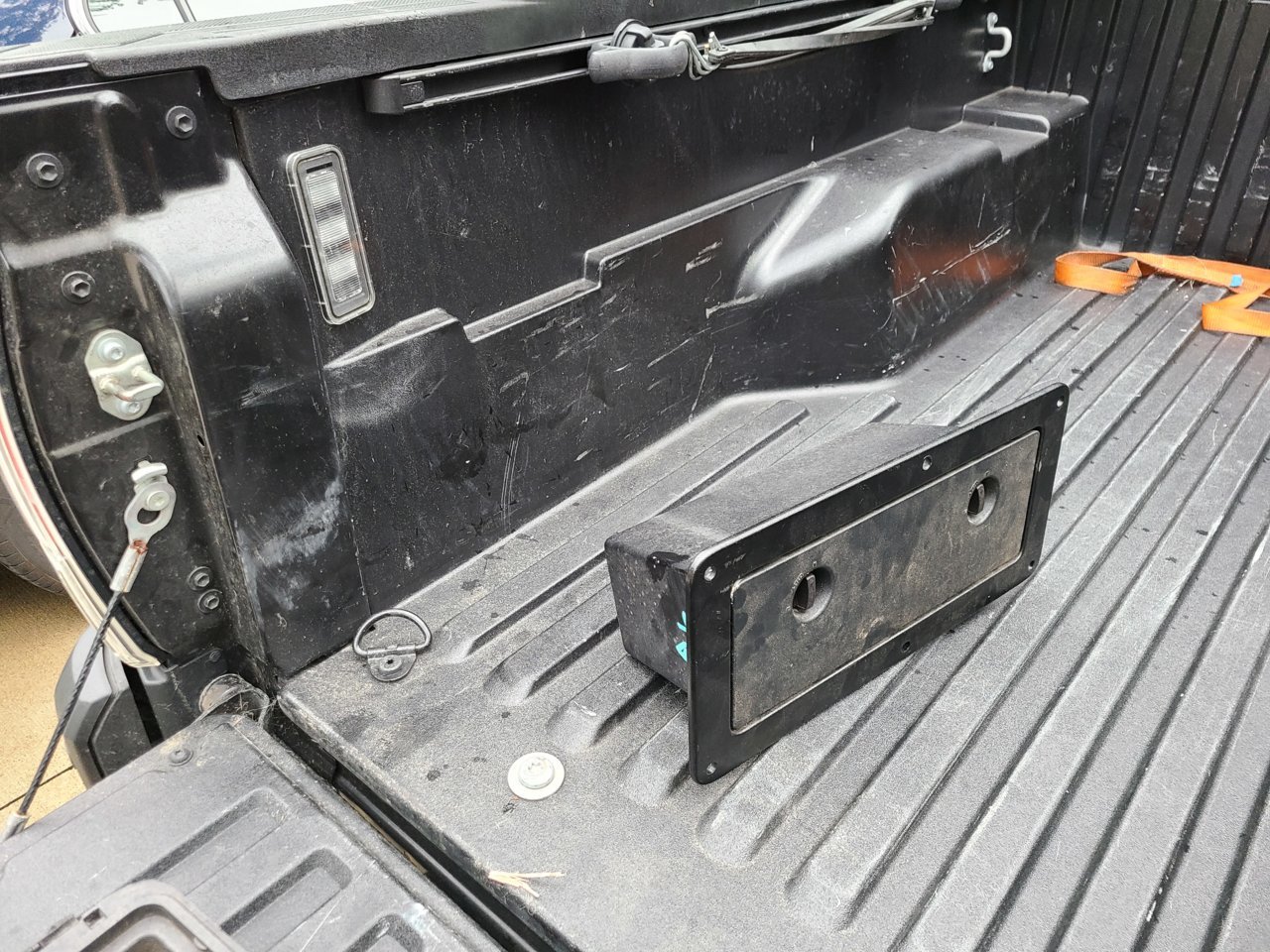

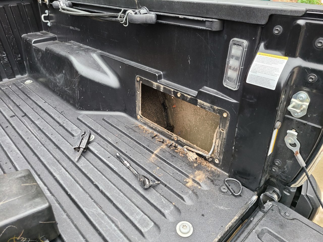

    Decided to share how I brought back the storage box on my 2020 Tacoma. I began with finding a guy on ebay selling the OEM storage box for $5 with $45 shipping. $50 is a steal compared to what they are to order from Toyota. I removed the passenger side box and outlet to measure where the hole was located. I then used tape to mask out the hole on the opposite side.
    Now for the fun part, cutting the bed. You're gonna want some good cutting tools because this bed is nasty to cut. Pretty much cutting fiberglass. I would highly recommend safety glasses, a mask or respirator, and gloves.
    I started cutting it with a vibrating multi tool but the composite ended up toasting my blade really fast so I had to move to a sawzall, which didn't cut as nice but still worked. After a really rough cut I opened up the hole until the box would fit. I used 2 1/2 holes on the sides to give clearance for the 2 tabs that need to stick into the bed. I guess I could've also just cut them off the box.
    With the box snuggly in the hole, it was easy to drill out the 6 pilot holes using the box as a jig. For threads, I used rivet nuts as it was much easier than trying to hold a nut on the backside, and it's the way it's done OEM. Final product came out really good, very satisfied with the end result.
