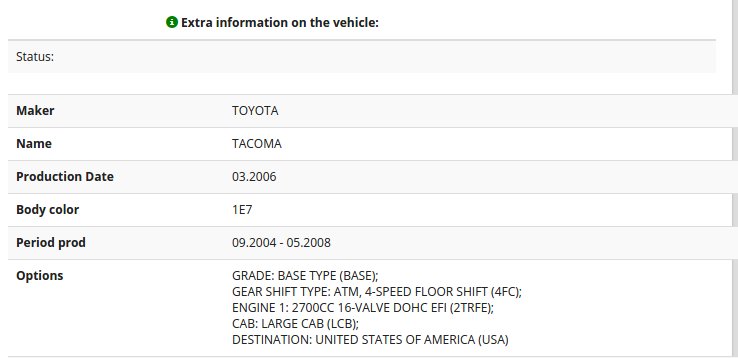

  19. Jul 20, 2016 at 7:53 AM
    #19
    patb4010
    patb4010 New Member
    Jul 19, 2016
    #192395
    4
  20. Jul 20, 2016 at 7:55 AM
    #20
    patb4010
    patb4010 New Member
    Jul 19, 2016
    #192395
    4
    see large cab in options it way more legroom than the trd sport trust me i used to drive one and well i rather walk no legroom especially with workboots on.
