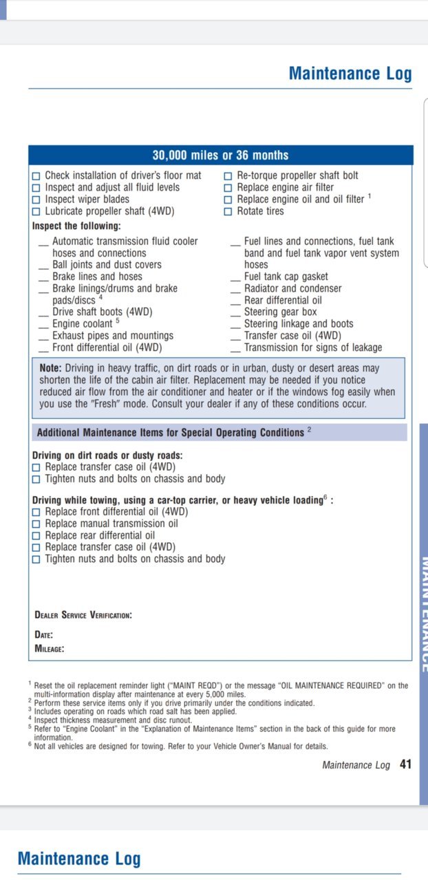

    What am I missing here...?
    eurowner likes this.

    It's my understanding the fluid changes are required because I frequently tow a camper.

    I do as well, but unless it's over 50% of the mileage you put on your truck I think you're safe.
    But toyota doesnt really specify what "special operating conditions" actually means, so your guess is as good as mine. If you want to change those fluids at 60k, go for it. I wont knock it

    Sorry, the 30k was the old fluid swap for the MT.
    But the others still apply for most trucks. Real world application, is it needed? Most say probably not. But that's just the guidance.
    Living on a dirt road qualifies you for a xfer case fluids swap and having a simple roof top carrier qualifies you for transmission... And diffs.... Somehow.
    But if the trucks hauls absolutely nothing more than groceries and sticks to pavement, I probably wouldn't worry about it.
    Except the plugs. They're pretty adamant about the plugs.

    Well there you have it, @TacomaTRDman. Two varying opinions. I tow a camper as well and waited until 100k miles to change tranny, transfer, differentials, coolant and power steering fluid.
    With the condition of the fluids that came out, if I was back to a brand new truck I would have started doing regular drain and fills of the tranny at 50k and changed the front differential fluid at 50k as well. Everything else still seemed fine.
    Neither of us is right or wrong, what you want to do is up to you
    Oh and ps: definitely change the plugs.
