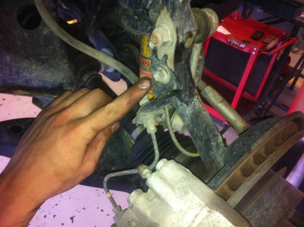

    REMOVE BRAKE LINE HARNESS:
    Loosen the single bolt attached to the spindle that's holding the brake line. Save the hardware.

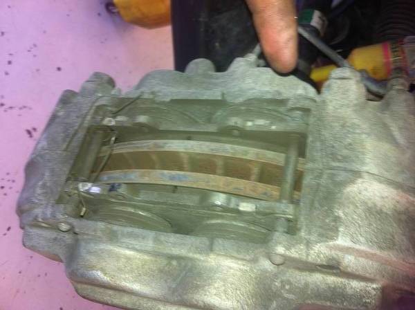

    REMOVE THE CALIPER:

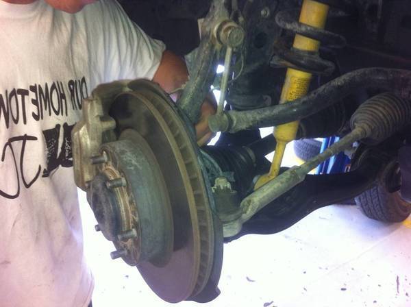

    Remove the two bolts holding the caliper. If you've never used anti-sieze this may be pretty tough as the torque will be hard to break. I used two wrenches and some sorry of trick where you use the box ends of the wrenches to hold onto each other and apply more force.
    What it will look like when removed:

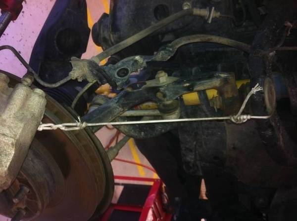

    SECURE THE CALIPERS WITH CORD:
    Pull the caliper off the rotor. Use 550 or "Rigger's" cord or ANY cord to hold the caliper up from somewhere like the UCA with enough slack to work on WITHOUT hanging by the brake line. MAKE SURE once you have it supported it's not being held by the brake line. (I had mine supported but somehow the string came loose and it was held by the line, nothing broke thankfully but do be careful)

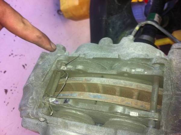

    REMOVING THE BRAKE PADS:
    Remove the cotter pins, Bolts, and the Anti-rattle pin. If you do not have new cotter pins or anti-rattle pins be gentle when removing them since you will be re-using them. Some brake pad sets come with new ones. The top and bottom bolts holding the pads should slide right out.
    I had already removed the pins in these pics:

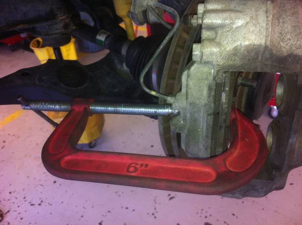

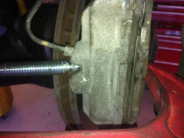

    COMPRESS THE BRAKE PAD ACTUATORS
    Using a C clamp AND the old brake pad, compress the two extending cylinders behind each brake pad (2) until they get as small as possible. Use the brake pad since it's bad and you don't want to harm the cylinders. If you leave one side slightly extended it may be hard for you to put them calipers back on
    EXTREME CLOSEUP WOOAAAAAAAAAAHHHHHH
    Notice how far they are in. They may look like they can go further but If you've got them to here you're good.

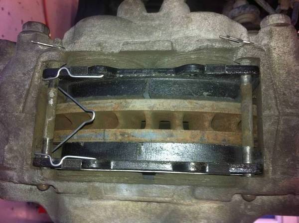

    REPLACE BRAKE PADS, BOLTS, PINS, and ANTI-RATTLE PIN:
    Put in your new brake pads (you can't really install these things backwards, just look at what you're doing. Put 'em in, push in the anti-rattle pin THEN push in the top and bottom bolts. Now before attaching the cotter pins make sure the caliper will go back on and you don't have to compress the actuators anymore.
    Should look like this when you're done:

    great write up but there is no need to remove the caliper

    Thanks! I guess looking at it I could have managed to wedge that C clamp in without taking off the caliper but I feel that wouldve made it a lot harder to work with. I appreciate the feed back though, thank you.

    i didnt need to use a c-clamp to push them in, i just used the handle of my pliers like a lever, very easy

    Actually, the correct way to do brakes is to remove the caliper so you can remove the rotors to have them either turned or replaced. Just slapping pads in can cause problems such as marginal braking or improper bedding.

    LOL first person to agree with me doing that! :eek: I did take them off because originally I was going to get them turned but apparently they we're too thin.

    Using the c-clamp is a better method because you can more easily backflow the brake fluid in a slower, more controlled manner. I've heard of problems such as fluid spills and sucking in air by using some other method.
