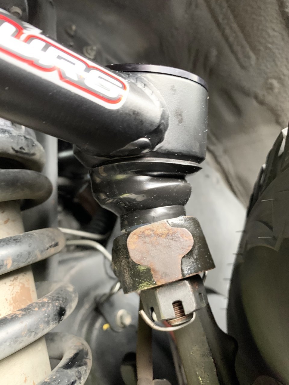

    image.jpg Don't know what to say other than both my upper ball joint boots had torn somehow.
    Hardly any time on the setup before it happened. (Couple days)
    Camburg sent me new boots (moog's) Thanks btw.
    I'm almost wondering if the alignment shop did it. Seemed like the mechanic was having a very bad day. Probably didn't help his mood when I came back to have them adjust the tie rods to get my steering straightened out.
    The holes almost looked like a Philips head.
    ...Mysterious

    Did you figure out why your boots were torn? I just installed mine and noticed that they are both leaking grease. The grease is coming from the fold in the middle of the boot on the tire side of the balljoint.
    I suspect the extended travel coilover is driving the joint to an extreme angle and pinching the boot as shown in your picture.

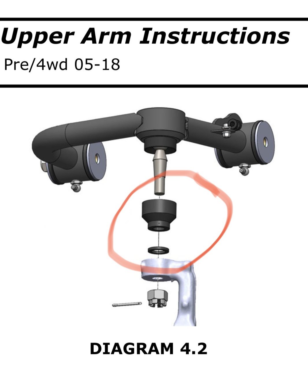

    I finally got around to replacing the torn baloney skins Moog calls boots on their balljoints. Mine have been torn for a while since I wasnt aware that Camburg had a solution for this.
    The picture below shows the Camburg diagram with the Polyurethane boot and a the Delrin washer they use to help seal on the bottom side.
    The boots need to be requested separately if you buy a replacement balljoint from them. I didnt receive the Delrin washers when I ordered mine. But I found Nylon versions at Home Depot that I drilled out to the right size.
    My balljoints were beyond shot and close to failure. There was at least 1/8 inch of travel between the ball end and cup. If you are running Moog balljoints and hearing a clunk in your front end.....CHANGE THEM ASAP!
    Seriously dont wait until the ball end pops out and you end up in a bad accident.
    Below you can see the new version installed. The new boots are thicker and have a slick surface for abrasion resistance. The top side of the boot extends up and over to seal against the upper control arm.
    Anyway I hope this info helps someone out.
