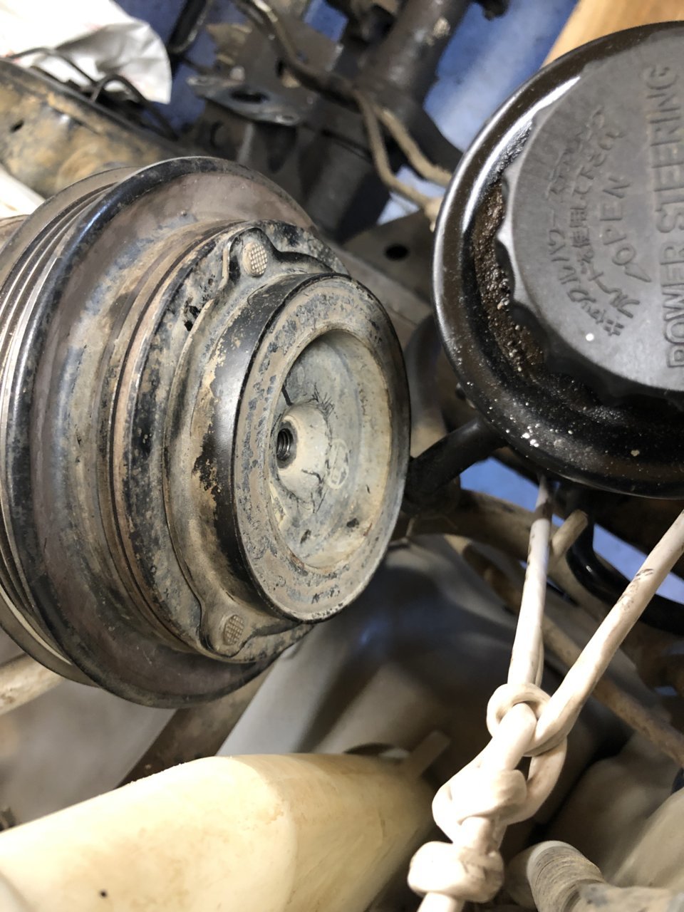

    While waiting on parts for an engine swap we decided to replace the AC clutch bearing. It had been making a grinding noise prior to the engine failure.
    It looks really simple when watching the 1000 videos online, but I'm having a hell of a time getting the pulley/bearing mechanism removed.
    I removed the 10mm bolt from the from of the compressor but can get no further than that. I'm very hesitant to pry on anything as the AC works really good even though the bearing is currently noisy. All the videos show the mechanism coming off, then a snap ring beneath. I'm not having the same experience.
    Any tips? Here is what I'm looking at right now:

    Ok I got it off, turns out you can use a larger bolt threaded into the front piece (wish I knew the name) to tighten up and force the unit apart. It worked like a charm!

    That's called the A/C clutch, the other part is called the pully or hub.

    Both longer and larger in diameter. It's really convenient that the hole in the front of the clutch is threaded for a larger bolt. The 10mm bolt that you remove doesn't actually engage into the threads on the clutch, it engages into the shaft of the compressor. This is super helpful because you can thread a larger bolt (I used an intake plenum bolt) into the clutch and it forces the clutch off the shaft.
    I made a pulley puller to remove the pulley but I need a longer bolt for it, I'll try to post pics tonight.
