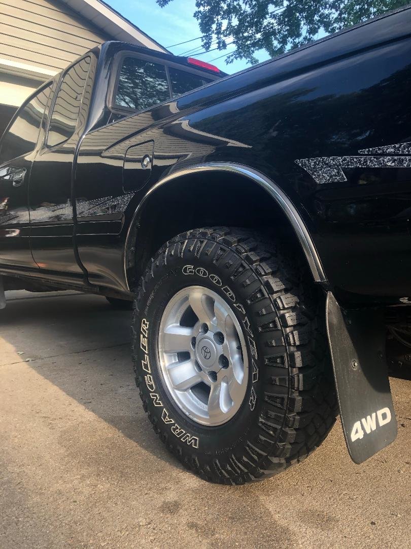

    do you have the chrome wheel arch moldings or flares
    do they look like this?
    i am going to brush some woolWax grease on them and see how well it sticks, I replaced the screws last year
    it would be nice if those screws were made of the same grade as the mudflap ones, those never rusted!

    Yup just like that! Our trucks are very similar. Where did you find the screws? Mine is 1999 4x4 single cab.

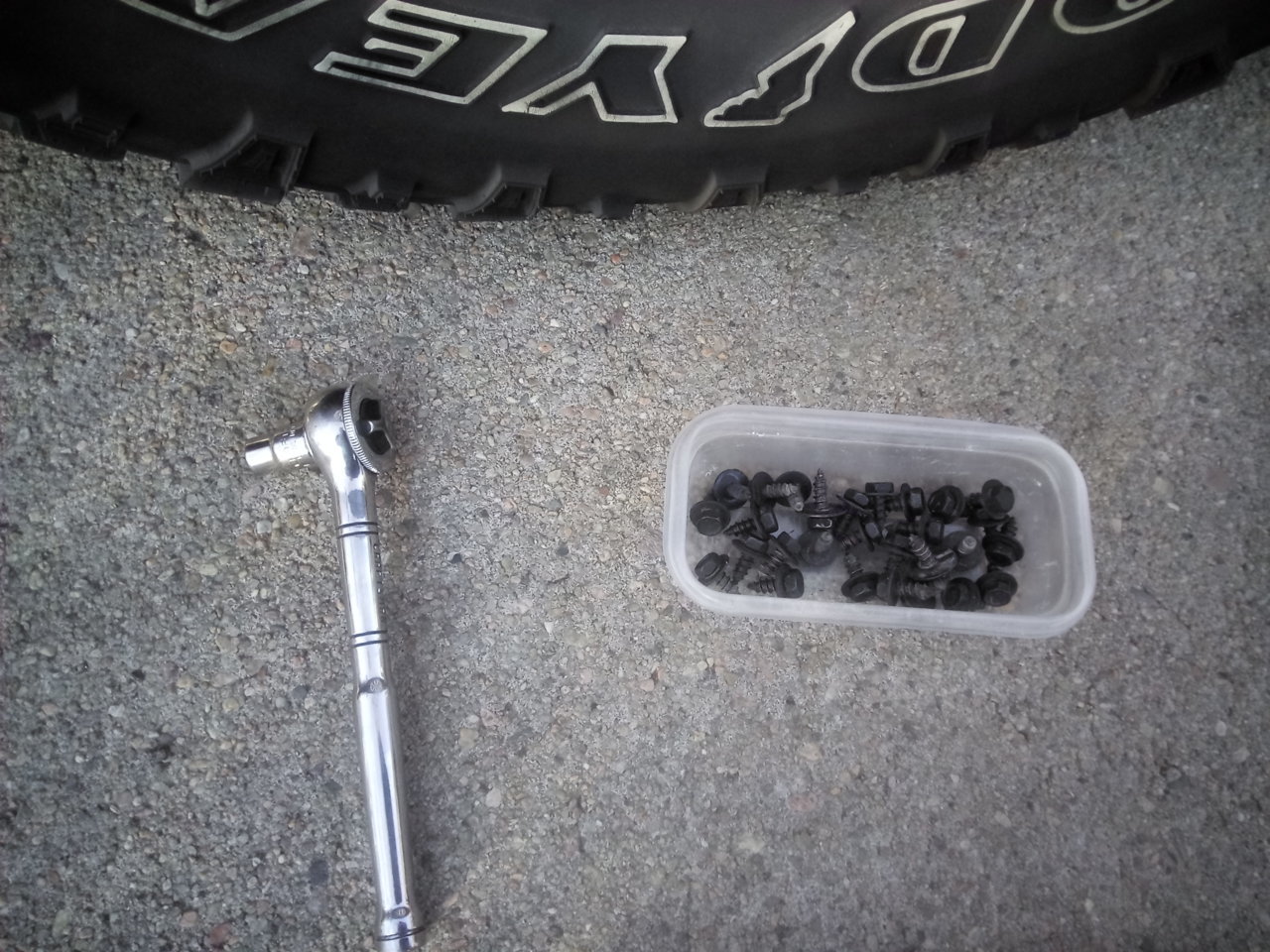

    Minimal rust on a couple after 1year
    Taken off with the utmost care

    This is most definitely not something you need to buy from a Toyota dealer. Take one of the ones you've already removed and go to your local Ace Hardware or auto parts store and match them.
    You can probably buy a box of 100 for the same prices as a dozen you'd get from the dealer.

    Its the black coating and the captive washer that can be a little tricky to find.

    These are called SEMS screws and are automotive specific.
    If you can take one into a Fastenal, they will match it for you. They will probably have to order them in for you though.
