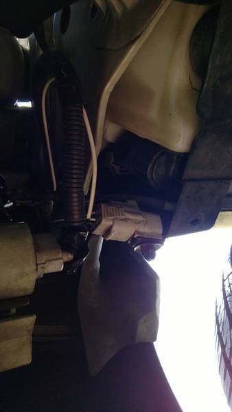

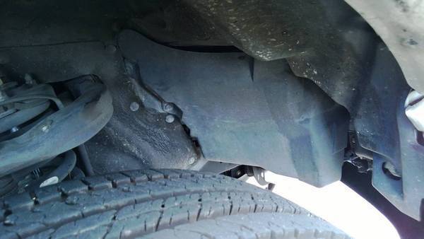

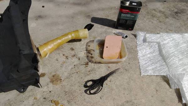

    Finally got around to fixing this. Used the fiberglass repair method. Pretty easy to do, but fiberglass is messy. Use gloves! Access through wheel well, remove 4x10mm bolts, unplug connector, unplug washer hose. Reservoir will drop down. Make sure you clean the neck good and remove dirt. I used 5x2inch fiberglass strips. Working from top down (so overlap doesn't create upward facing pocket) I just layered the strips all the way to the bottom. Waited until cured, then reinstalled. I'm leaving the deckplate on (from deckplate mod of air filter box) so I don't pop a maf code. Will removed deckplate again in a few days. Overall pretty easy to do. It's not a work of art, but it should last the life of the truck.
    Access through wheel well and remove 4 bolts:
    Unplug connecter and hose:
    Broken neck due to cracking. These seems to be a common problem and I could see more cracks forming:
    Fiberglass repair kit:
