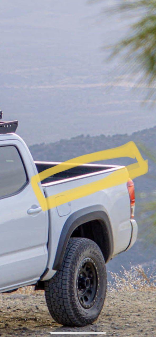

    Similarly, can anyone provide a part number for the plastic piece that sits above the rail along the cab left to right? Without it there's a gap between the bed rail and bottom edge of a topper that is hard to seal. or what solutions have you come up with to level that out? IMG_1967.jpg

    I think that's the truck bed header rail. $56 on Amazon.
    PT278-35100-BH

    Update: This is the correct part
    Truck Bed Side Rail - Toyota (65409-04010)
    2016-2023 Toyota Tacoma - 6540904010
    Just bought it off of Ebay a used one for $120. Use the 5 x T27 torx screws to screw it in.

    That piece is not plastic it's steel or maybe aluminum. There is also a rubber piece that sits on each side of that center rail between the plastic trim. Comes with the factory folding hard cover. It could help seal that area if installing a cap but still needs putty in the area to have a chance of not leaking there.
