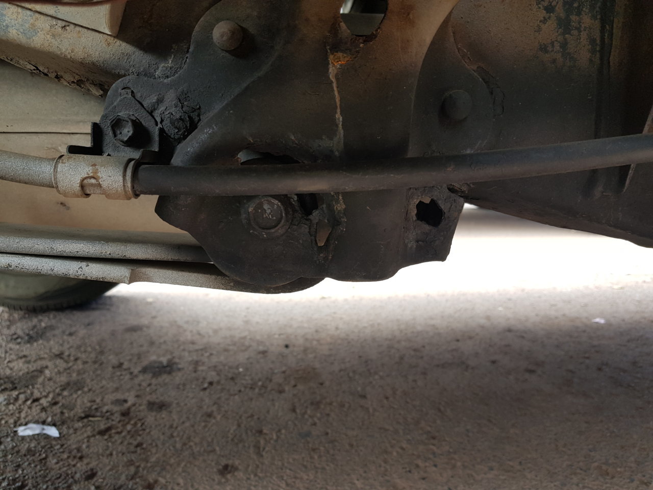

    Hello. My truck has a rusty leaf spring hanger that I am looking to replace. I've attached a photo of the area. I haven't had any luck finding this piece in the parts catalog. Is there any aftermarket part or some other way to replace this section? Unfortunately the truck it too old for a frame recall20190326_114522.jpg
    Thanks in advance

    Thanks a lot! So, now the question is how to replace it? Getting the old one off is straight forward enough, but how would you suggest attaching the new one? Would a bolt/nut combo do the job?

    If the spring hanger is that bad, what's the rest of the frame look like. it looks to me like that would have qualified for a new frame 3 months ago. Too late now though.

    Well the original is riveted on, so ideally you would do that.
    I suppose that you could substitute bolts, but you're going to want to make sure that you figure out the proper hardness of bolts to use -- I won't be able to guide you there. Fine threaded, and I'd be tempted to stick a layer of adhesive between the parts, like loctite.

    My guess as well. At this point it is definitely a matter of applying bandaids to pull just a little more life out of it.

    Not what I wanted to hear since I just bought it, but I had a feeling this was the case. I don't do any serious off-roading so if this fix can give me ~2yrs of driving without fear of the hangar failing I suppose that's money well spent. I appreciate all of the help.

    Have you inspected the rest of the frame?
    What I want you to do, is crawl under the truck so that your head is below the transmission and in between the front cab mounts, and look at the part of the frame adjacent to the cab mounts, but facing the transmission. You should see a rectangular hole that is approximately 1 inch by 2 inch. Is there any evidence of that face being rusted through? Note that there are two layers of steel in that face of the frame, and you can see both layers at that hole. If the two layers are touching each other, that would be a very good sign. If there is a huge gap between the two layers, that is a VERY BAD sign and means that in the very least, the inner layer is rusted right through.

    Look at the frame rails beside the catalytic convertors. If there is a hole the size of a cantaloupe, I would be more worried about the frame folding in half in the middle. Did a shady dealer sell you the truck?

    Crap. One side has a huge gap. I bought it less than a month ago.

    Also, look here. this is a 2006 Hawaii Taco.

    Ok, so basically what is going on right now, is everybody who is realizing that the new frame program is over for the 2005-2010 (there is rumor of it starting soon for 2011-2015) is trying to dump their trucks with shot frames, since they are now basically worthless. You're going to see the prices falling dramatically for 2010 and older having their original frames and significant frame rust. The seller of your truck **may or may not** have been aware of the overall condition.
