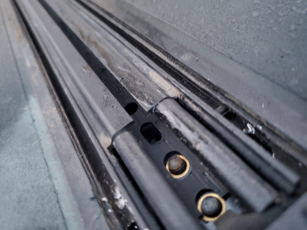

    I replaced the weather seals on my 2017 TRD Pro Tri-Fold Tonneau Cover.
    I made my parts list by looking at other posts, but none was 100% complete. So I am posting what I bought.
    OEM Tonneau Cover Weather Strip Dissolves | Tacoma World
    (384) Toyota Gen3 Tacoma Tonneau Cover Seal Replacement - YouTube
    I purchased through a toyota dealer near me as I could not find any cheaper prices on any 3rd party site. Total with tax and shipping was $195.06.
    Took 16 days to get the order delivered.

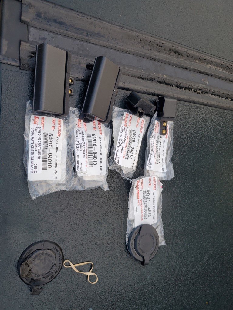

    -Rubber Seals-

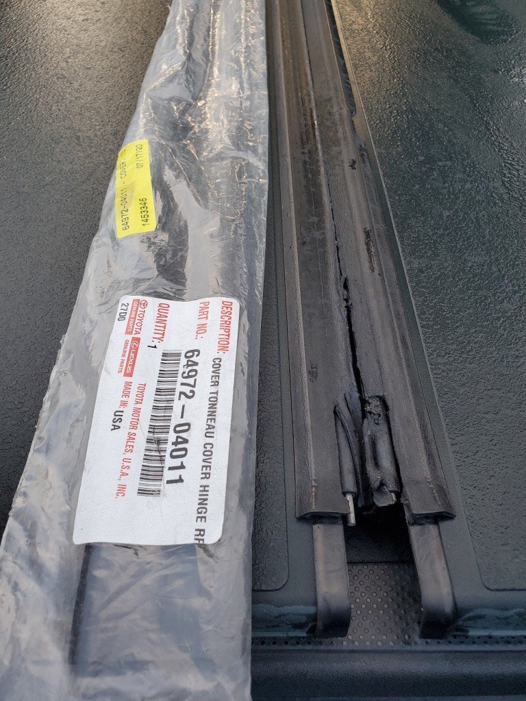

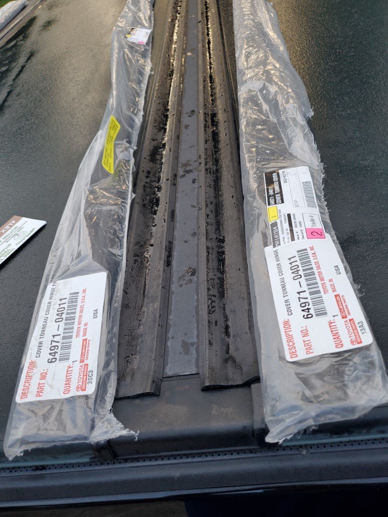

    (2ea) of these 64971-04011 (2 hinges between panels 1 & 2 closest to the cab) = $24.58ea QTY 2 [COVER, TONNEAU COVER HINGE, FR]
    (1ea) of 64972-04011 (the double hinge between panels 2 & 3 closest to the tailgate) = $41.18 QTY 1 [COVER, TONNEAU COVER HINGE, RR]

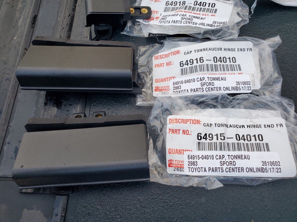

    -Joint side caps [Cap, Tonneau Cover Hinge End]-
    64915-04010 - Front Joint, RH (passenger side, cab side) = $20.57 QTY 1
    64916-04010 - Front Joint, LH (drivers side, cab side) = $20.57 QTY 1
    64917-04010 - Rear Joint, RH (passenger side, tailgate side) = $20.76 QTY 1
    64918-04010 - Rear Joint, LH (drivers side, Tailgate side) = $20.57 QTY 1
    -Security Bolt (if you need to replace)
    M8x53mm
    M8-1.25 50mm bolt + stainless steal washer.
    Toyota P/N 64935-04010
    -Security Bolt Cover Flap-
    CAP, TONNEAU COVER HOLDER, NO.1 = $11.60 QTY 1
    64937-04010

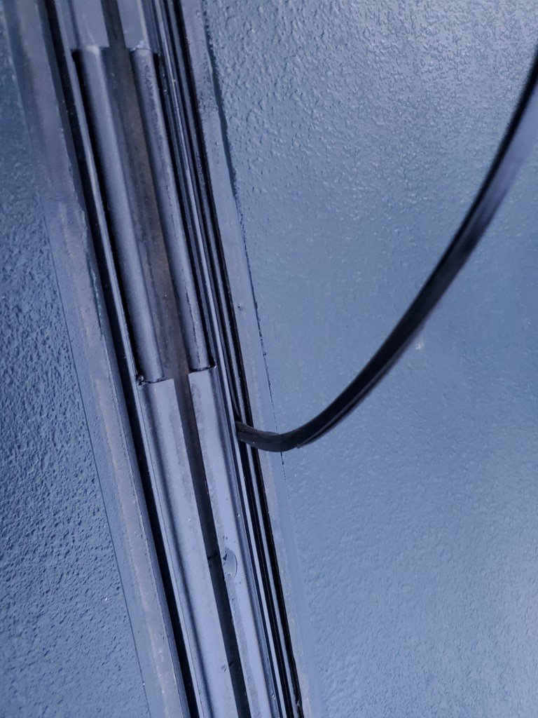

    1. You can replace the end caps and weather strips without removing the cover from the truck. Same as the youtube video.

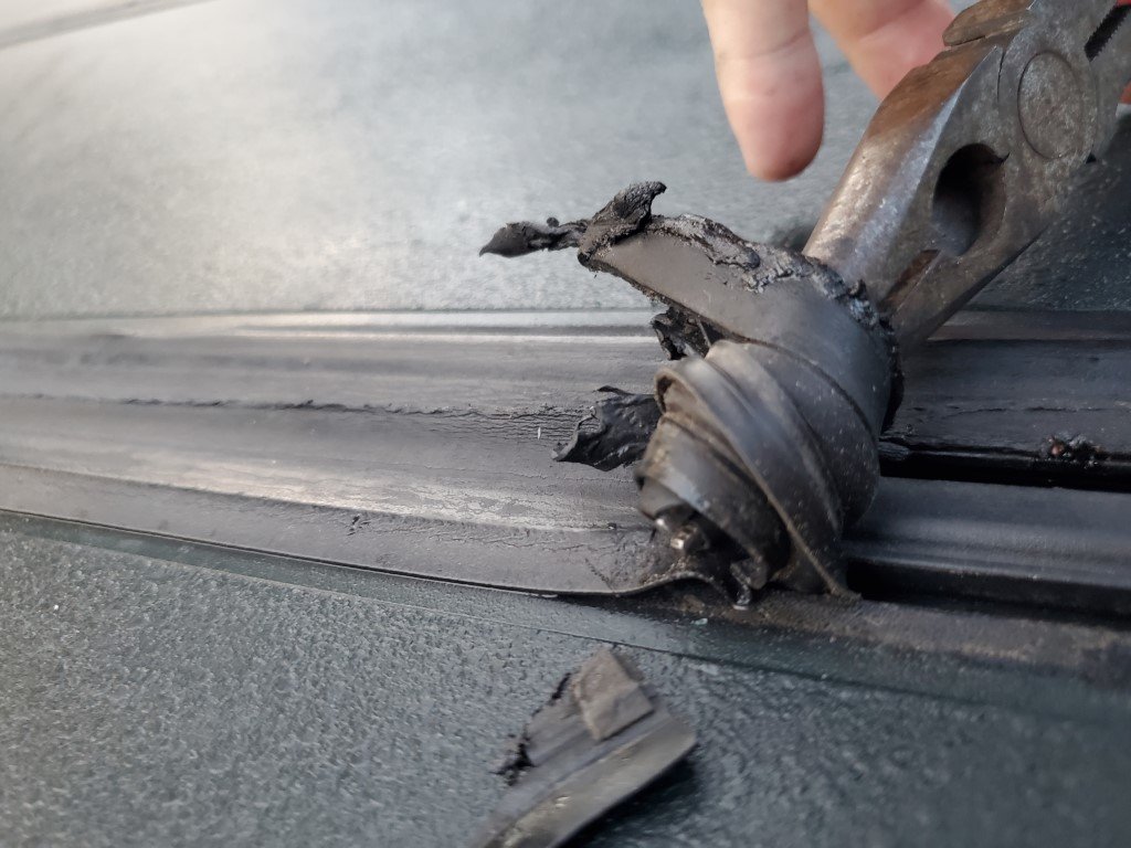

    2. You have to dig out the old seals from the T-Slots with a small pick or screw driver and pliers. It is a pain to remove as parts of it tear off and you have to dig those pieces out separately.
    3. Verify all the groves are clear.
    4. Change the end caps. Each use T-25 torx.
    5. Install the weather strips. They have notches on the bottom that match to a pin at each side in the groove. Line up those notches and just start pushing in. Dont need a rubber mallet, you can easily push in by hand.
    6. To remove the old cap, I used a screw driver and broke the tabs on the inside as I could not get it to pull off.
    Then you line up the new cap and press it down. It was a little hard to press down.

    Here are the notches in the sides of the weather stripping and the bump inside the groove that needs to be lined up.

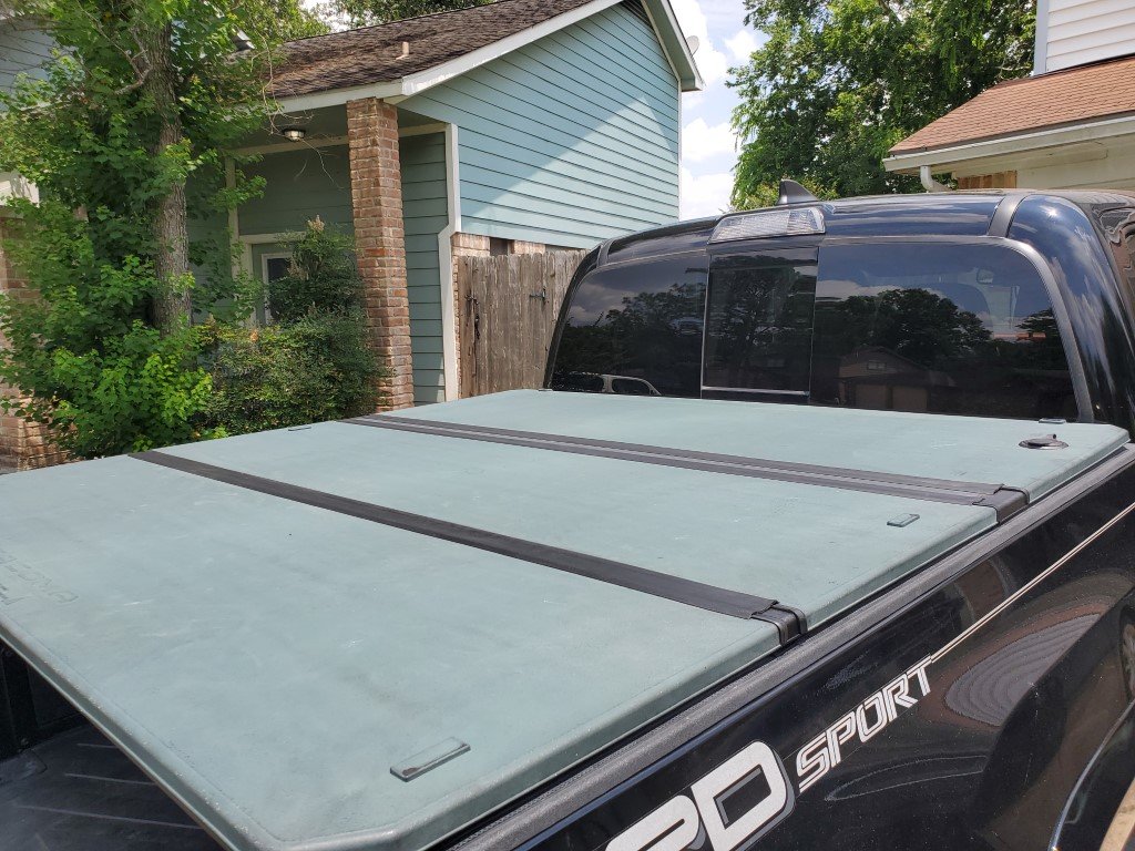

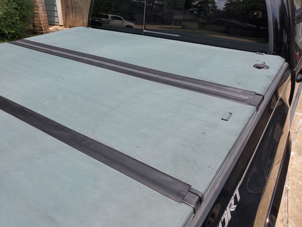

    Here are after pictures.

    Toyota definitely did not use rubber and plastic that are UV and Ozone resistant in these Tonneau covers.
    This really is a design defect for it to be decomposing like this. I have only seen plastic and rubber do this on BMWs. And yes, charging $200 to replace their defective rubber is pretty bad. The parts have to be less than $30 total to manufacture if they are low volume parts, less cost if high volume parts.
