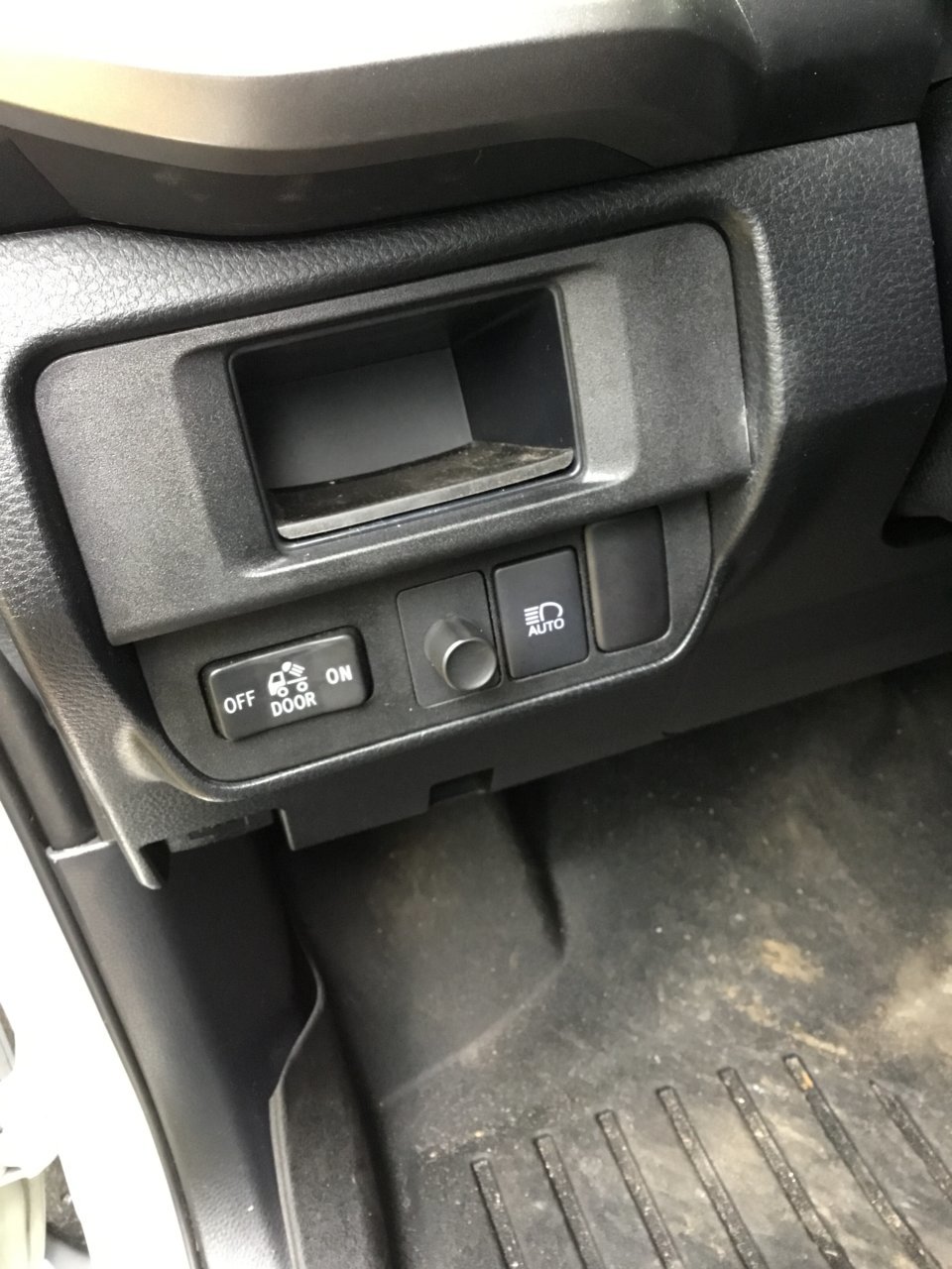

    They're supposed to be somewhere

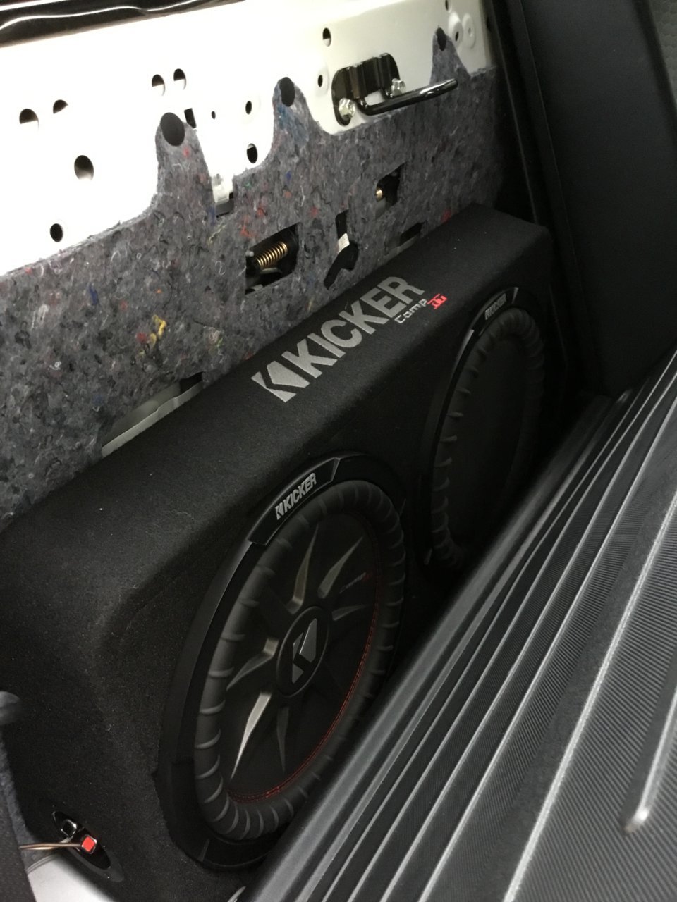

    Not on the factory amp. just the equilizer in the head unit. That's why I am running two amps. a stock amp for the speakers and a Kicker amp for my dual JL Audio subs.

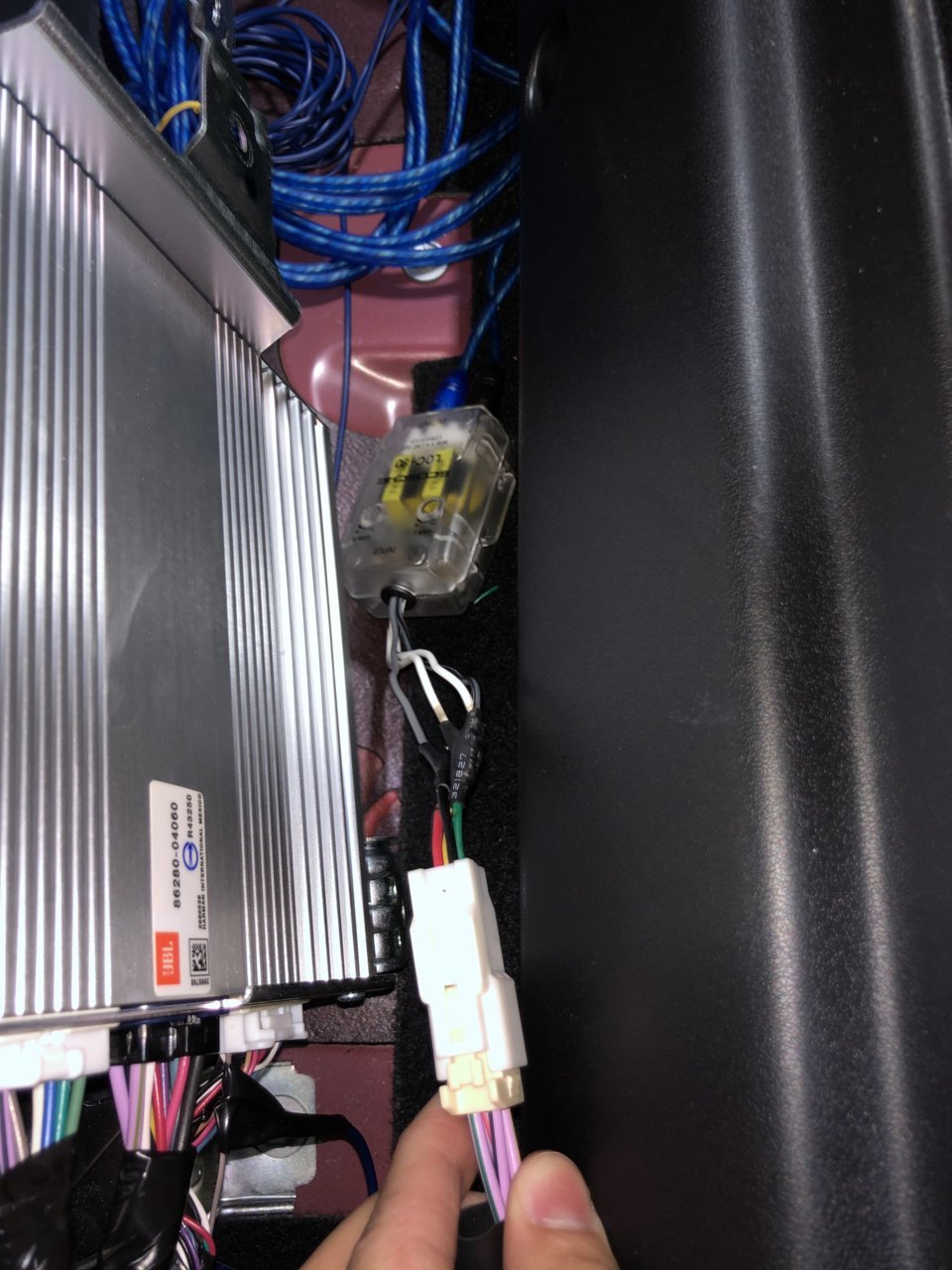

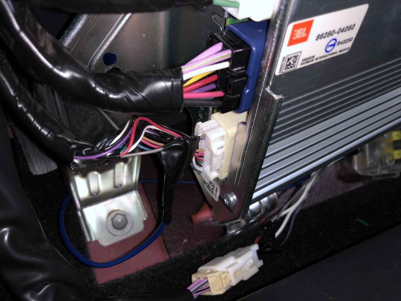

    I found it, and there's no way to adjust anyting.

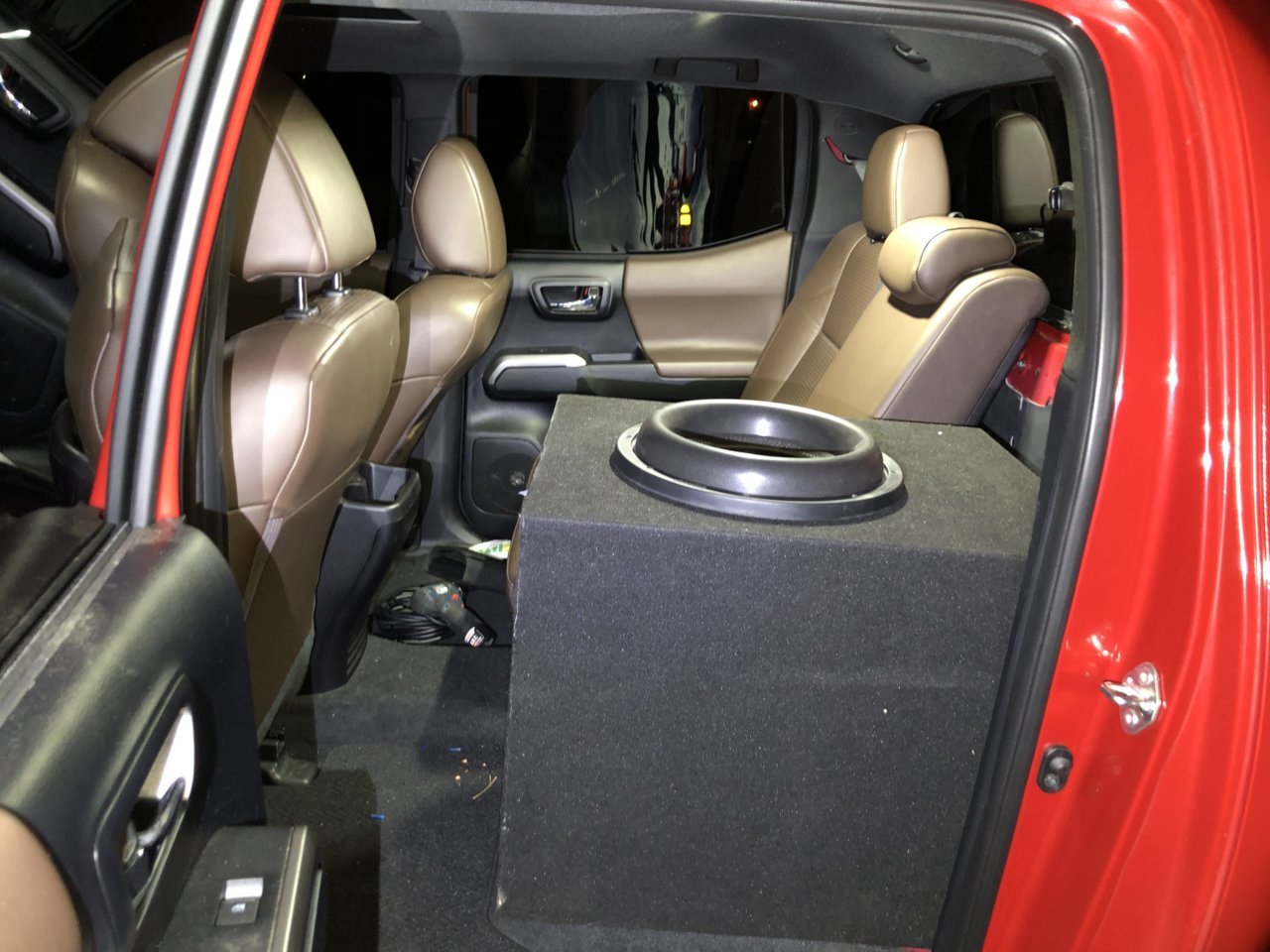

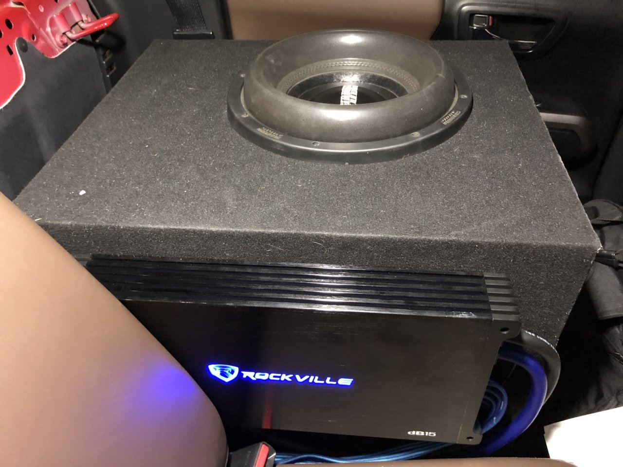

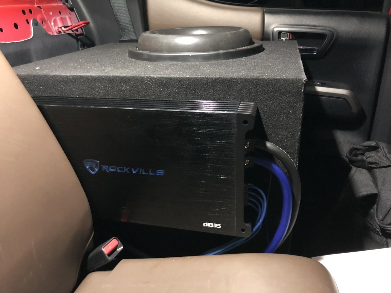

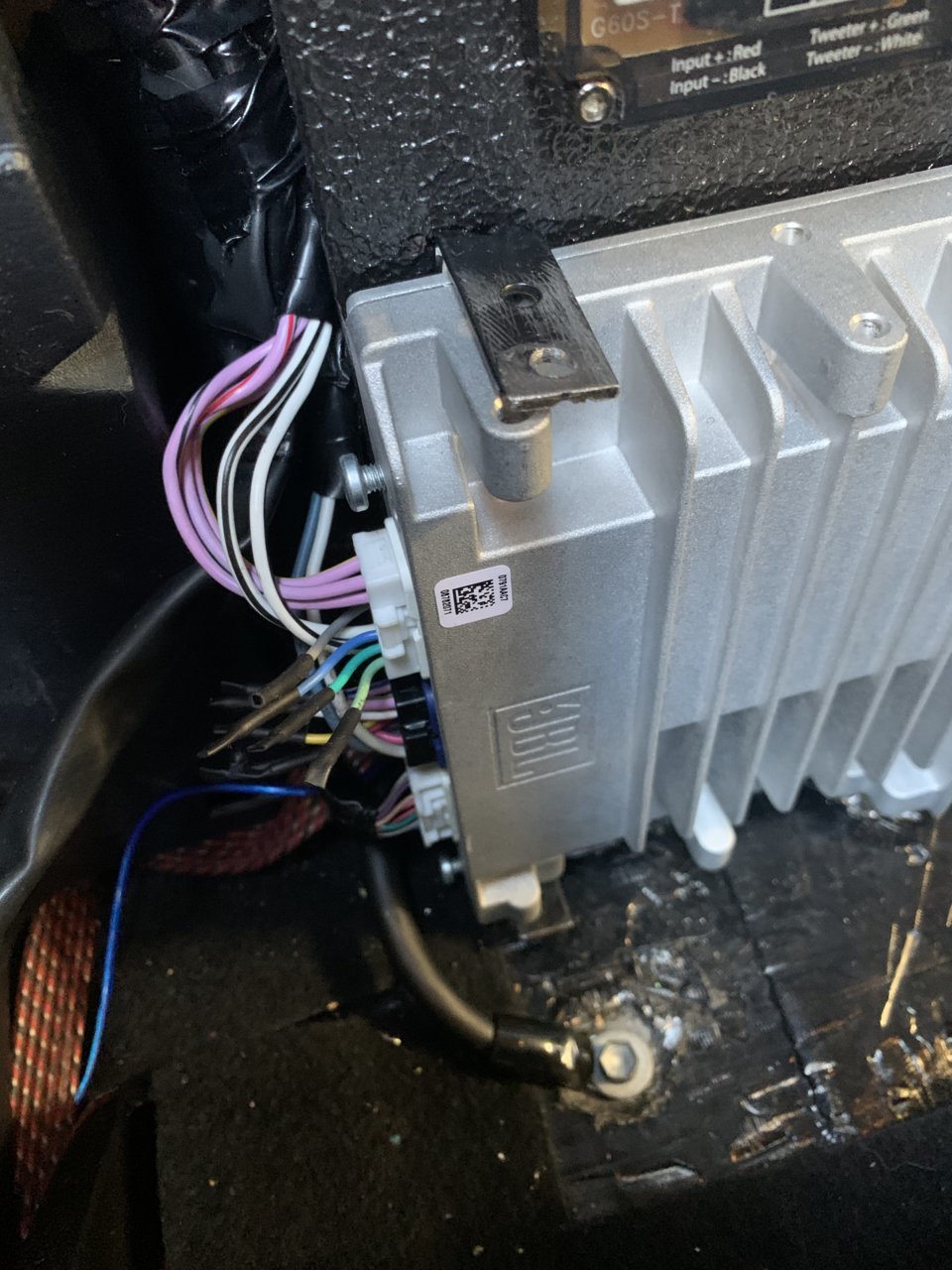

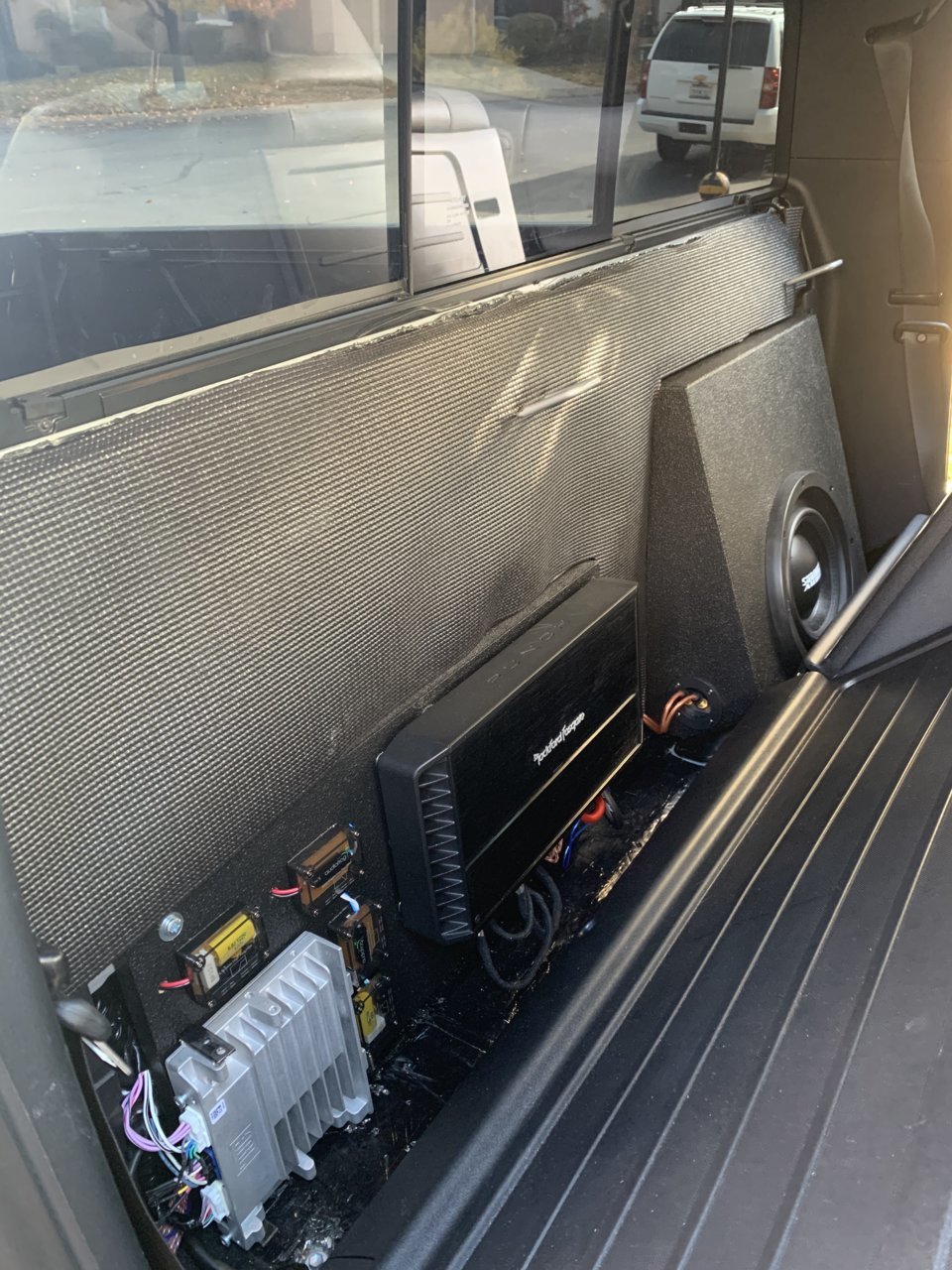

    Figured i would share my Install with yall.... Sundown Xv.2 12inch (4Ohm) (Wired down to 2Ohm).....
    Helpful hint for anyone installing an amp in a 3rd gen tacoma with JBL; the the thin grey wire on the JBL Amp is the Power signal wire to tell the amp to turn on with the Radio.

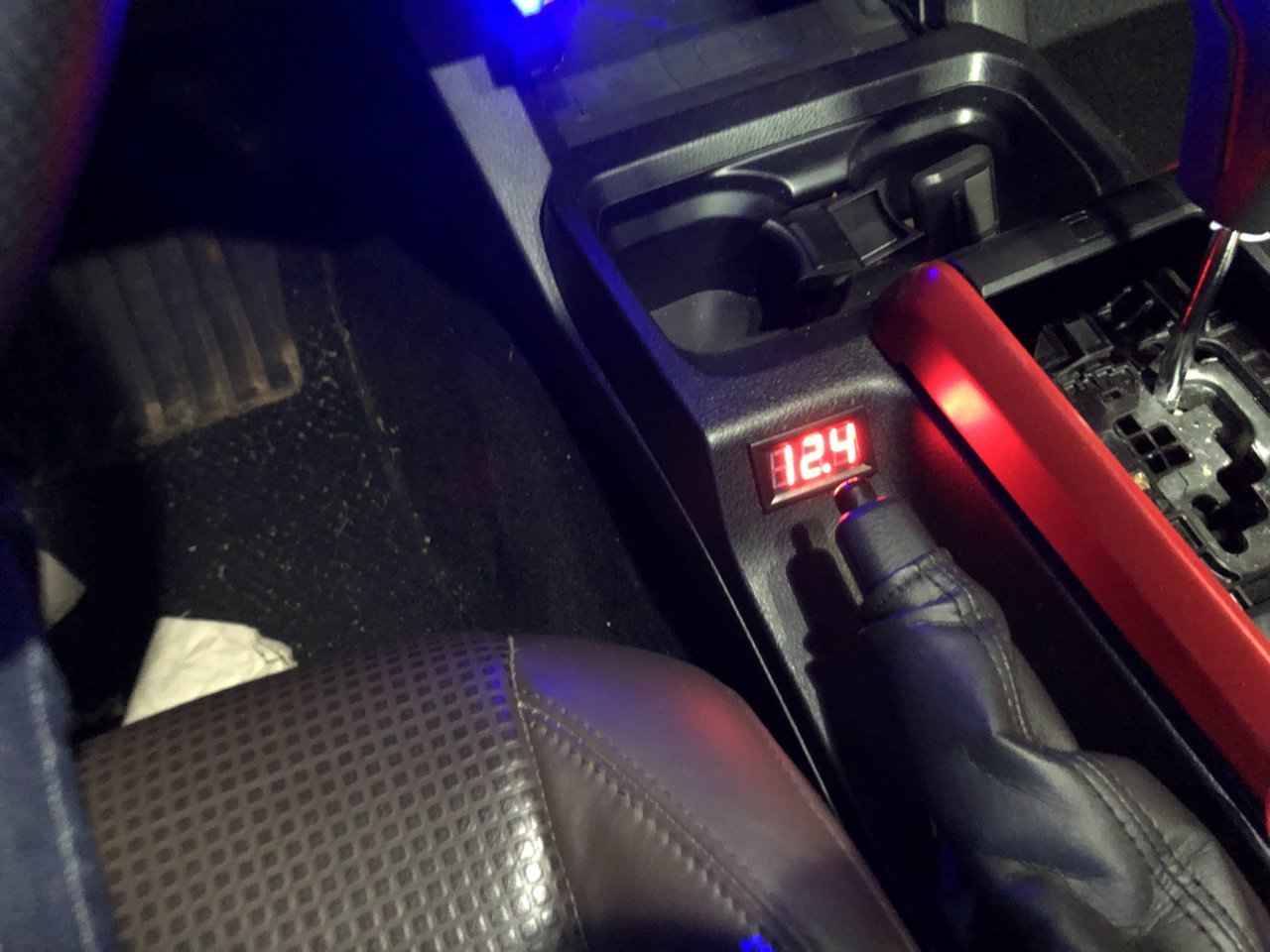

    Sorry for the mess lol and the gear shifter piece missing, I'm trying to paint the grey trim on the interior barcelona red. and the lil voltmeter came with my sub from Down4SoundShop.com

    Where is it located? I did a brief search but didn't see mine, and plan to replace it and the speakers in the near future.

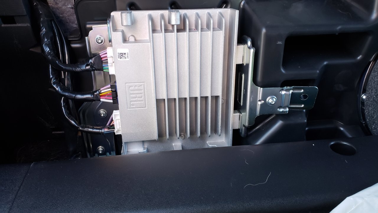

    pull down the passenger side back seat and you will have to remove the plastic cover to see the amp and the sub and good luck replacing the amp tho. The Amp is a digital processor too so you can't use the radio volume control if the amp is not present.

    not true on the radio volume, you can bypass it and it works great. amp is next to the sub behind the pass seat.

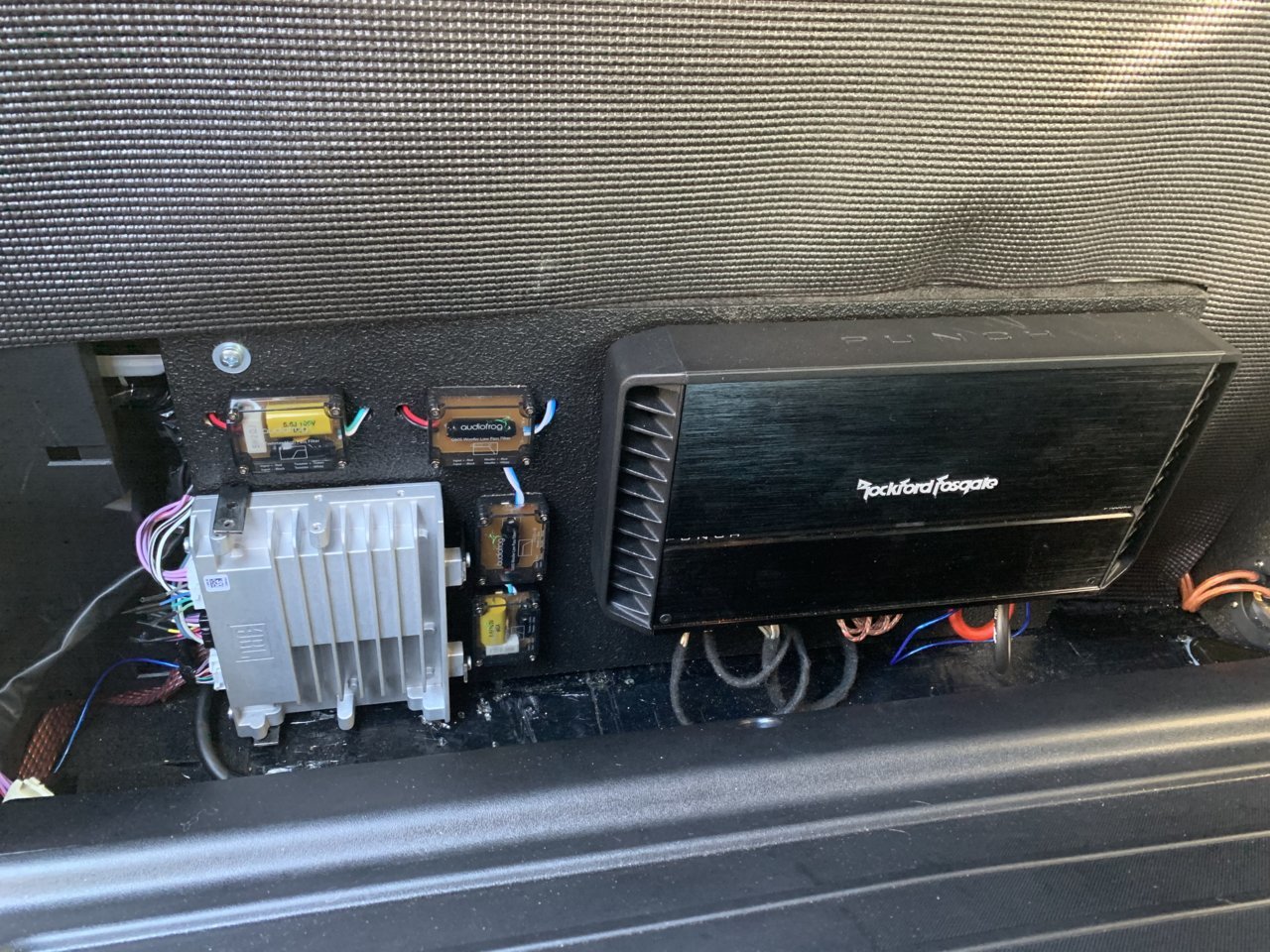

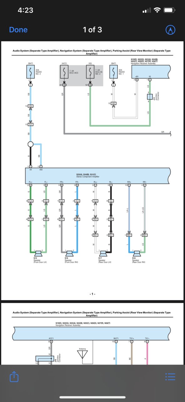

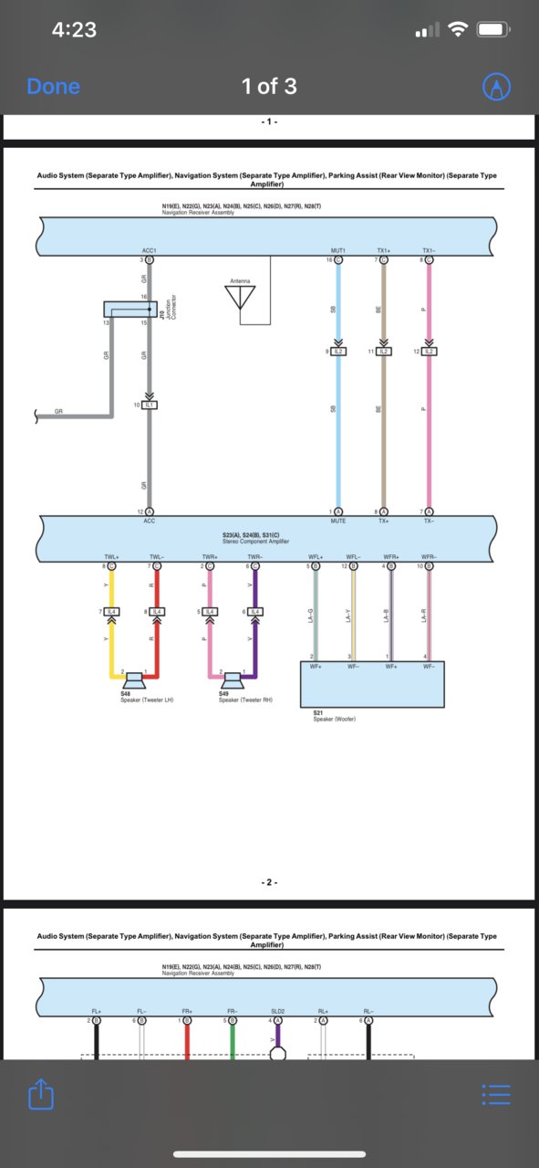

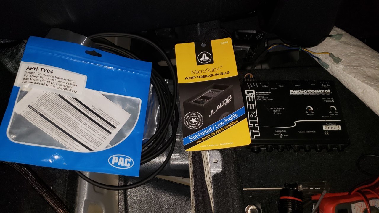

    The AmpPro is the best way to go for our JBL system. It simplifies everything and makes your life so much easier. By chance do you remember exactly which wires ran to the tweeters, front 6x9's, and rear coax? I found a wiring outline at one point but I can't seem to find it

    the colors were correct to the diagram. But to double check just use a AA Battery to check polarity and that it’s the correct speaker (watch YouTube if you don’t know how to do it)
