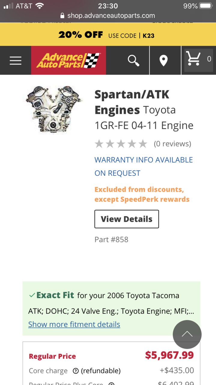

    I would suggest a remanufactured one, if the funds are available. It comes with a decent warranty and parts are new.
    By the time you get it pulled, broken down, machined, put together and back in the truck, you'll be around the price of a remanufactured one..IMO
    It's always a gamble with junkyard engines plus the warranty is only a few months long or so.....but sometimes it pays off.

    sure are pricey 0_o
