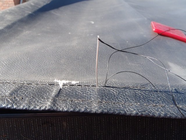

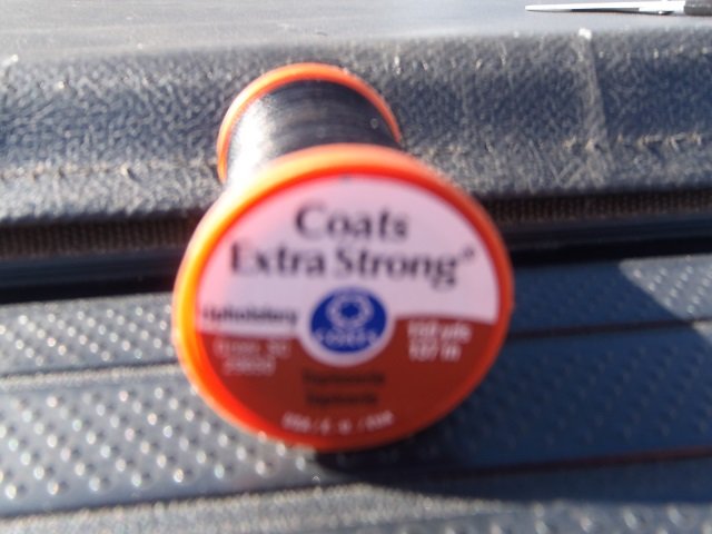

    I have been repairing my tonneau cover's stitching.
    I'm using this from AC Mores

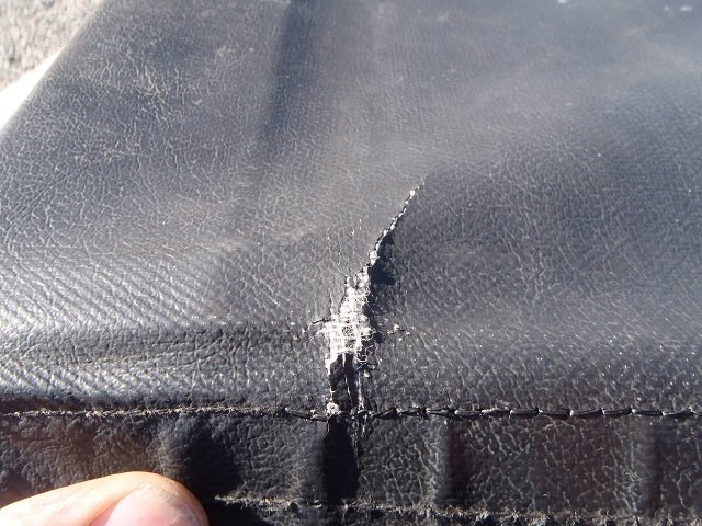

    What if ....I was thinking ... (I know a problem) what if on this
    If I use this?
    IT says : http://www.starbrite.com/item/liquid-electrical-tape
    Has anyone use this for this type of fix?
    I guess I have nothing to loose :notsure:

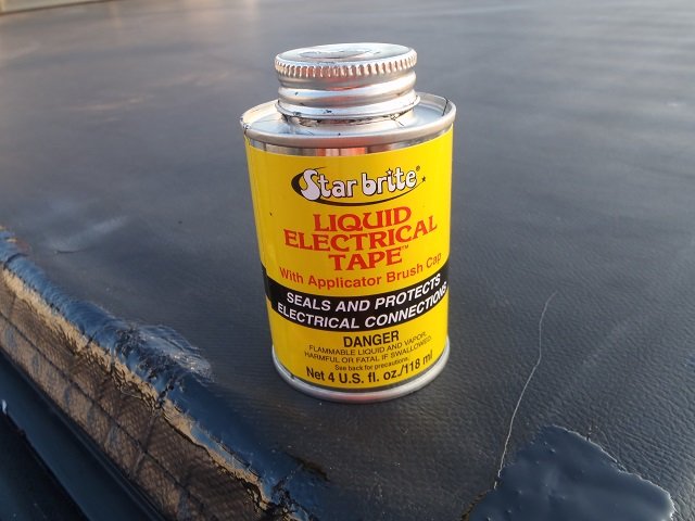

    Continuing working on my tonneau cover.
    I'm sealing up the treads I installed the other day with this.
    I did wipe it down with some alcohol!
    I'm also putting this on area's were we see that the vinyl has come off exposing the fabric below.
    Lets see how it holds up shall we!

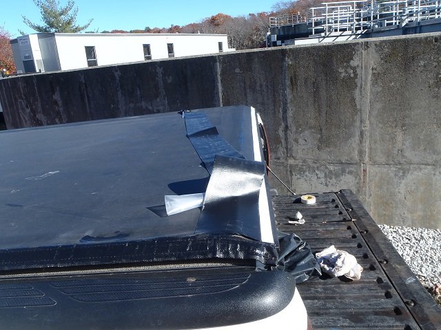

    For the end over the tailgate were wood sits sometimes I added a strip of
    How it looks before!
    Cleaned it up and added a strip of tape to help guide me !
    Steady.......
    Boy that tape really helped!

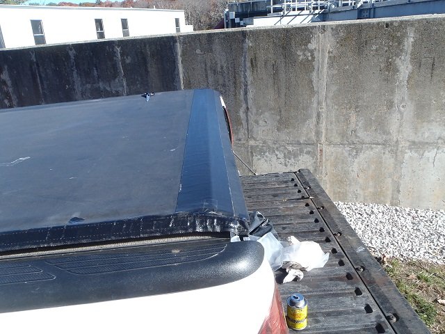

    This is how it came out!
    This will sit in the sun today and bake, ..... it's in the 60's!
    I'm good with it lets see how this holds up

    The rethreading has held up tremendously !
    The liquid tape is good in most locations.
    The tape on the tailgate area has held up with signs were some wood has been sitting on it ( transporting long pieces)
