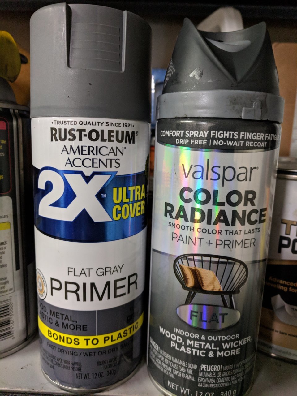

    Tips. Paint color usually turns out lighter than youd think. I had a cement grey (left can) that turned out white. And a charcoal grey (right can) that turned out cement grey. (see can pics). If you want dark grey, you'll need black with primer. If its not what you like, dont worry, you can paint over it.
    Also, if you look real close at your dash before you paint, youll find the colors are all little shade different. This is good. Look at your side panels, then top dash, then glovebox. Theyre all different. This is good. As long as you choose a color that matches the group or the outside of your truck it wont matter. Mine is lighter than factory color, but nobody notices, since its in the same group. I can barely tell its been painted.

    Original color is stone. Its on the doorjam label.
    Can is called Valspar blindfold. I believe I got it at Lowe's.IMG_20190729_133113.jpg
