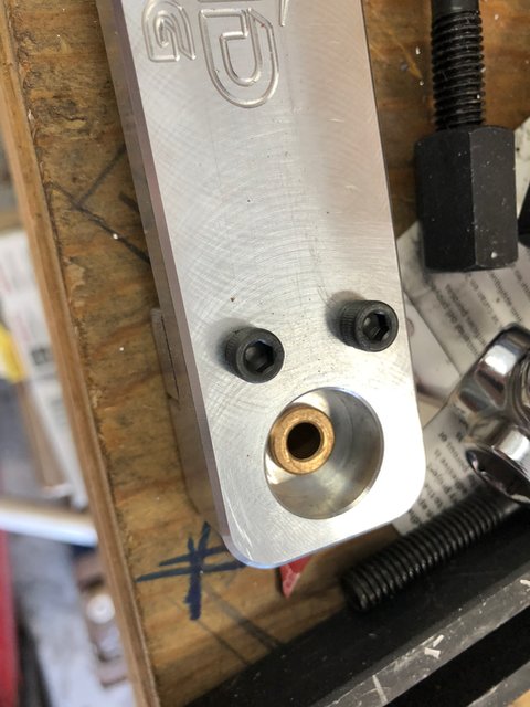

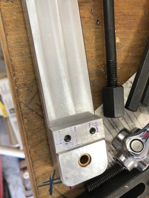

    On a related note, I bought one of the OGE battery hold downs (for a Northstar AGM, stock size, single battery). The hold down was too wide for the battery, so I ended up machining a spacer to take up the slack and then attached that with a couple of hex screws. Then the tie down holes were way too big (3/8 IIRC). I got some brass 3/8 x 1/4 bushings for those and then used some steel round bar to bend and thread custom tie downs. Made them a little long to eventually accommodate a different battery, so I topped them off with some acorn nuts (stainless). I'll take some finished install pics when I have a minute.
    Areas for improvement --
    1. Counter-bore the holes to the flanged bushings sit flush and loctite them in place.
    2. Countersink the holes for the little hex screws.
    3. Instead of holes in the OGE bracket, mill slots so the spacer has the ability to adapt to different battery sizes.
    (Could have done this on the mill, but I was getting the truck ready for the dirt, and time...always time....was short).
    4. Demo this on a drill press. I used my cheap little HF mill, which was accurate 'enough' to mill the spacer to dimensions and accurately drill the needed holes. I know a drill
    press can do this job, and more people have one of those than a mill of any sort.
