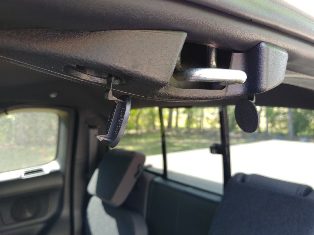

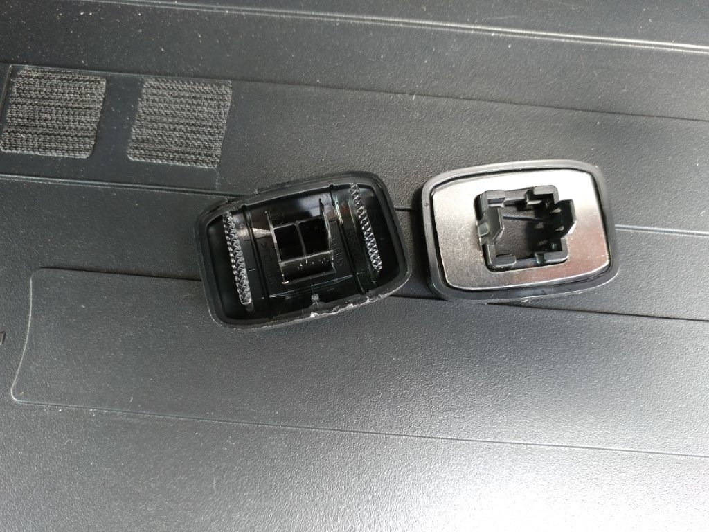

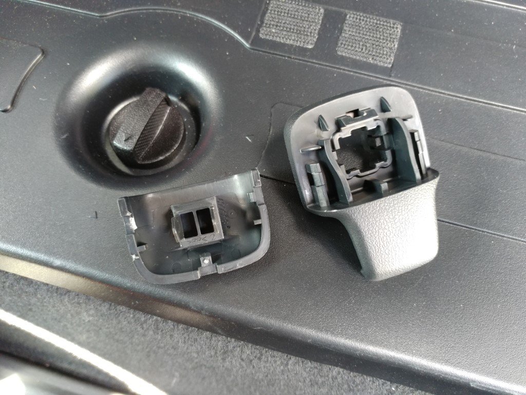

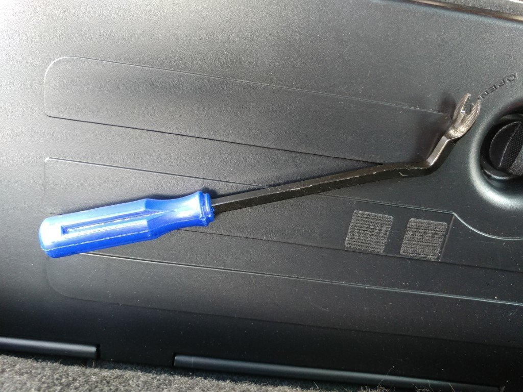

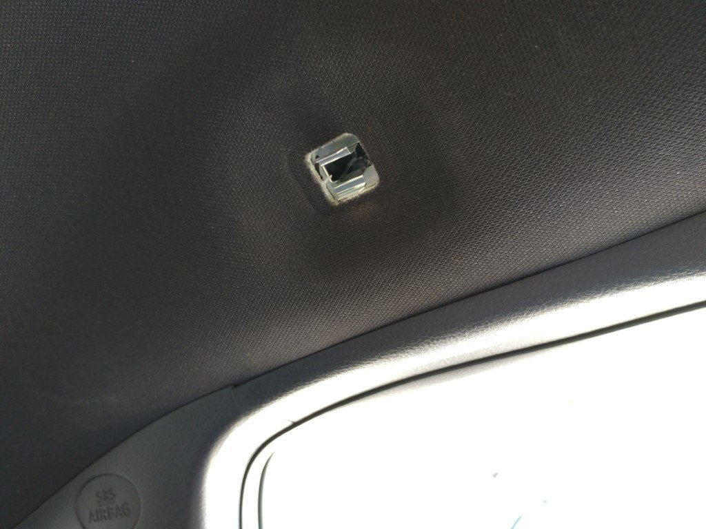

    I know this thread is dominantly in regards to 2nd gens, I did use some of the 3rd Gen information posted in it for my headliner removal / sound deadening project.
    Some of the 3rd gen people mentioned they had issues removing some of the "headliner clips / caps" and in some cases damaged them. I took mine off (2018 Access Cab) with out too much problem. I have attached some photos below to give you a better idea what I found. The clip removal tool in the image was immensely helpful.

    Looks like you broke a tab. (Pic#5) Knowing where those are is half the battle.

    Hmmmm, maybe and I didn't even realize it. It snapped back into place okay and has held up since (i.e. has not popped off). When I look Ican't tell the difference but the interior is so dark in that truck it's like a big black hole... :notsure:
