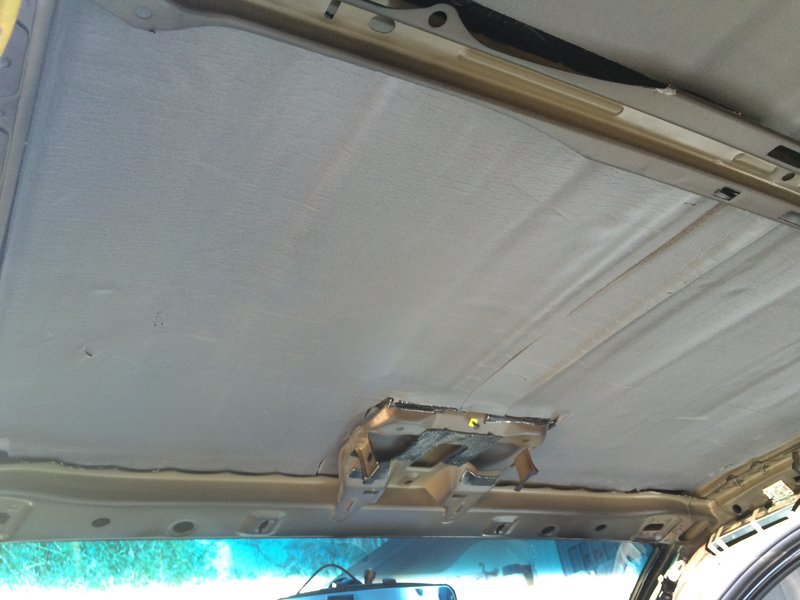

    The project was completed on page 4 of this thread with amazing results. Here is the text from that page for those that don't want to read all the way through. Although I would suggest at least browsing since there was a lot of helpful information provided by various members.
    Update:
    I finally got around to finishing this project this weekend which was perfect as it's been unseasonably warm for February in SoCal. We were in the high 80s this weekend and expect to see low 90s this upcoming week.
    The first step was to drop the headliner. There is a youtube video that briefly goes over how to drop it on 2ng gens. I feel that the video missed a few things that I can shed some light on hopefully. Unfortunately for viewers at home, I tend to get caught up with my projects and forgot to take pictures during some critical steps. I'll try to describe them here as best I can.
    There are several things holding up the headliner and they're easy enough to figure out if you take your time. Most have exposed or hidden fasteners with the majority being 10mm bolts or phillips screws. The ones that don't are the visor clips and coat hangers on the rear of the headliner in double cabs (not sure if AC or RC have these). They come out by turning them 1/4 turn counter clockwise and just pulling them out. They have small retaining clips that keep them up there, but the hidden sheet metal is keyed so they come out easily.

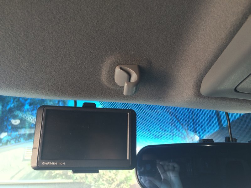

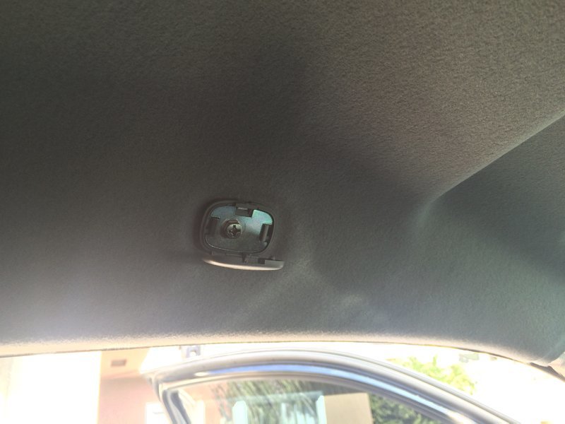

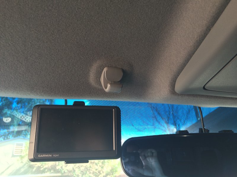

    Next is the sunglass holder. Easy enough. There is one phillips screw in the rear holder. Remove that and pry with your fingers at the front of the plastic and it should pop right out. There are retaining "fingers" on the rear of the plastic trim that keep the sunglass holder in place, but only clips at the front. Don't forget the wiring harness for you map lights. 2 clips there.

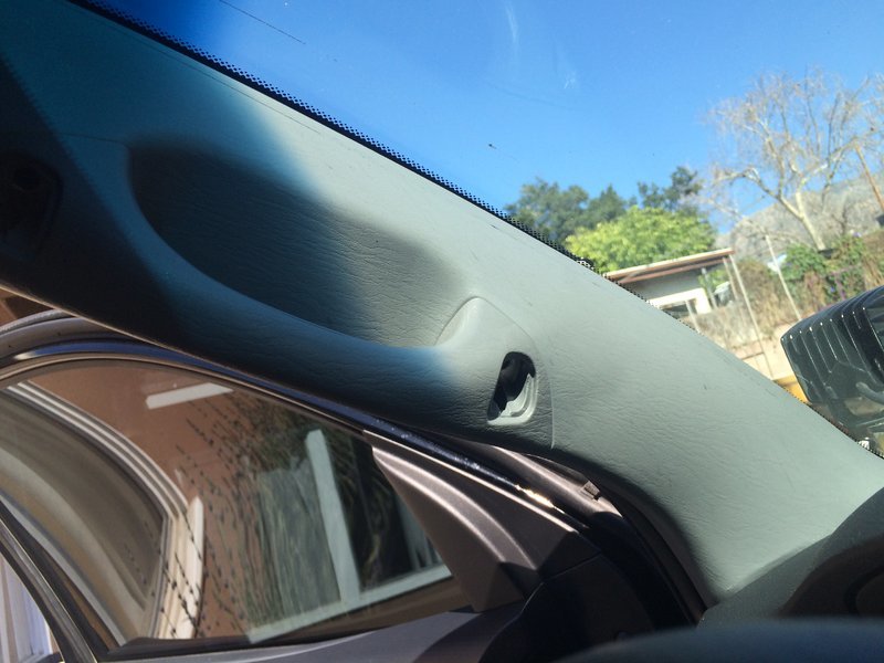

    A-pillar on both sides has 2 10mm bolts behind the small covers. Pop them out and unbolt the two and you should be good.
    These little clips along the side of the headliner that are labeled "air bag" do not contain and air bag. They hide two more 10mm bolts (one per side). I used a small pick tool to pry the cover open to access the bolts.
    Here's where I got ahead of myself and didn't take pictures. The side panels between the doors of a double cab and the corner panels in the rear of the cab (where the seatbelts are attached). These things are kind of the hardest part of this whole process. They are held on by plastic clips and two hidden 10mm bolts at the bottom of each of the 4 panels. To get to the bolts, you have to remove the lower section of each trim panel. To remove that trim panel, you have to pull away the door weatherstripping. To pull the weather stripping, you have to remove the sill plates all around. Sound like a PITA, doesn't it? Don't answer that, it was rhetorical. It's a PITA only because its a multi-step process. If you take each one at a time, and go slow, you should be fine. Once all that stuff is done, the headliner should basically just drop out of place. You should be looking at this: A whole bunch of notching but bare sheet metal.

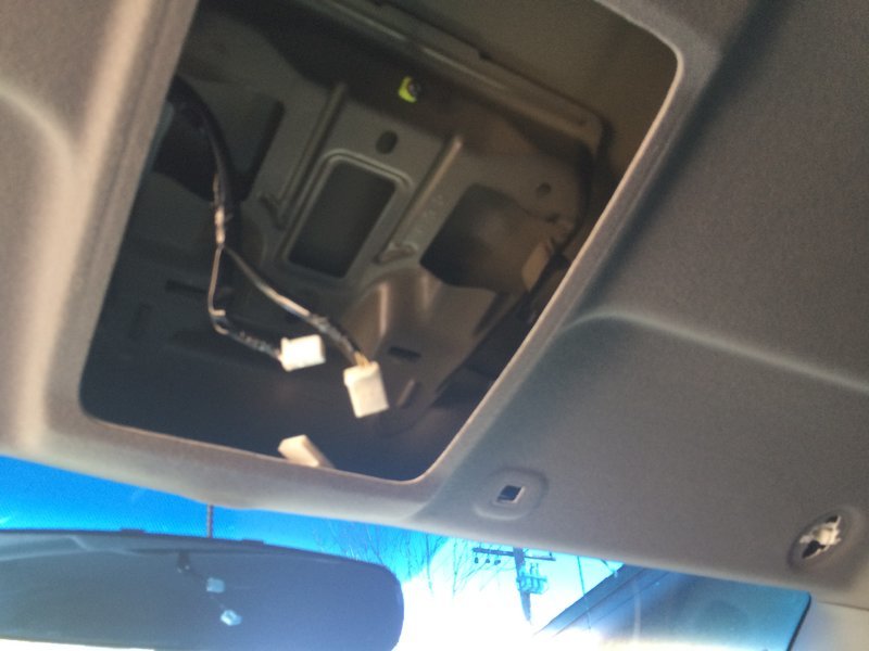

    There are some wires attached to the headliner for your map lights, dome lights, etc.. Be very careful with these as they are super thin and glued or taped in place. The glue is there to keep the wires from vibrating and rattling inside your headliner. (Ask me how I know. Never mind, don't ask- also rhetorical.)
    While I was at it, I also removed the rear cubbies so I could follow the process on the rear of the cab. No real trick here. A few 10mm bolts and they pull right out.

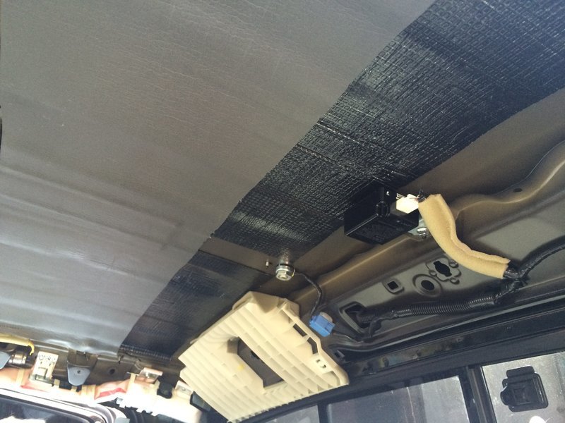

    Now the good stuff. Here's what UPS dropped off:
    The foil backed sound deadener:
    [​IMG]http://www.amazon.com/gp/product/B00PCLPXXQ?refRID=96SZR7392TRPKZY8QTJ3&ref_=pd_bia_nav_t_3
    And a roll of foam heat insulation:
    [​IMG]http://www.amazon.com/Noico-Automot...xgy_263_2?ie=UTF8&refRID=068B8ZE8F1Z422ETHHTZ
    While you're at it, get an application roller.
    http://www.amazon.com/uxcell®-Deade...263_img_3?ie=UTF8&refRID=0XMPB67HVDS5E5RX1RK8
    For an extra $4.50, it pays for itself by saving your hands from getting beat up when pressing this stuff into place. You want a tight bond and there really isn't a substitute for the roller. A little known fact is that you can use the rounded tip of the handle to press the deadener into tight curves in the sheet metal. Anything with more of an edge would tear into the product and make your application look like garbage.
    It'd be a good time to mention that just as in anything, proper prep for installation is key to prevent product failure. Before sticking down my first layer, I cleaned the roof with household all purpose cleaner and did find a little dust had made it's way up there. Probably not enough to affect full adhesion, but just to cover my ass, I gave it a quick second pass with alcohol to remove any residue left by the cleaner.

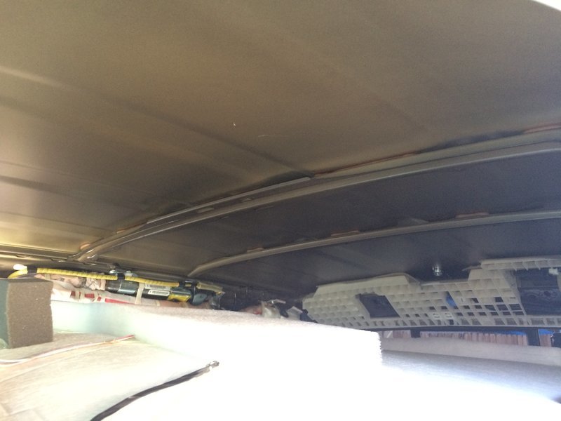

    And I got excited and did the whole roof (both layers) before I pulled out my camera for pictures again. Here you can see the black foil backed sound deadener and the lighter grey layer is the heat insulation. BTW for people looking to do the TPMS delete mod. I believe the little black box there on the rear of the headliner is the TPMS module. Disconnect that and no more TPMS light forever! I'm pretty sure I read that somewhere on here. If it doesn't work, don't blame me- you should've done your research instead of listening to strangers on the internet.

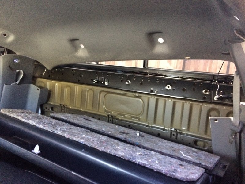

    Not sure if you can see it here, but I also went as far as sound deadening and heat insulating the metal bracket that holds my sunglass holder. For anyone that has put on their sunglasses after your truck has been parked in the sun all day and burned the bridge of your nose- here's your chance to fix this issue.
    Once you get as much coverage as you can go and put your truck back together. Pat yourself on the back for a job well done. Call your friends and amaze them with something that they will never see and will never understand why you're so excited about it.
    I'd say total I spent about 4-5 hours (I wasn't really keeping track) doing this by myself. A second set of hands would have made this go faster and possibly ever removing the seats out of the truck. I spent a lot of time running around my truck looking for that one last clip or bolt that I missed. Hope this helps you guys that are planning to do this. So far, with one day of driving, you can definitely tell the difference with the sound deadener. This project is well worth the effort involved. As far as heat reduction, I want to say I felt a difference today, but that's more of a "butt-dyno" approach. I will be doing some more scientific testing in the near future with another members truck in similar configuration. I'll get temp readings and everything once we both have time to park our trucks out in the sun.
