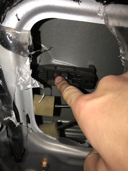

    The next step is to cut about a 6" hole in the clear plastic liner (I used a razor blade) to fit your hand, and tools into the door. Next you want to use a T30 star bit with an extension and unscrew the bolt in the spot pointed to below.

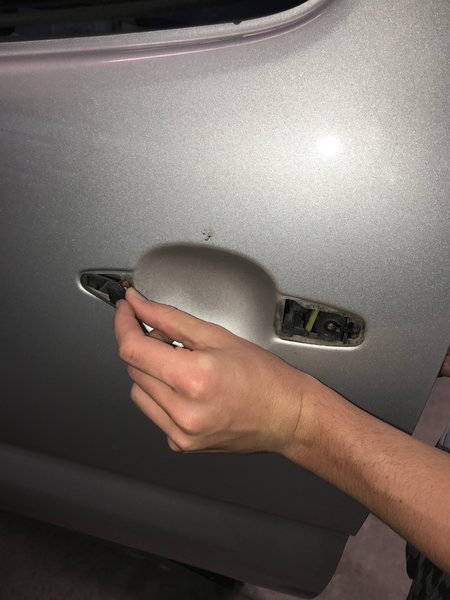

    Once the screw is removed, use a small flathead screwdriver to pry off the small cap on the outside of the door.

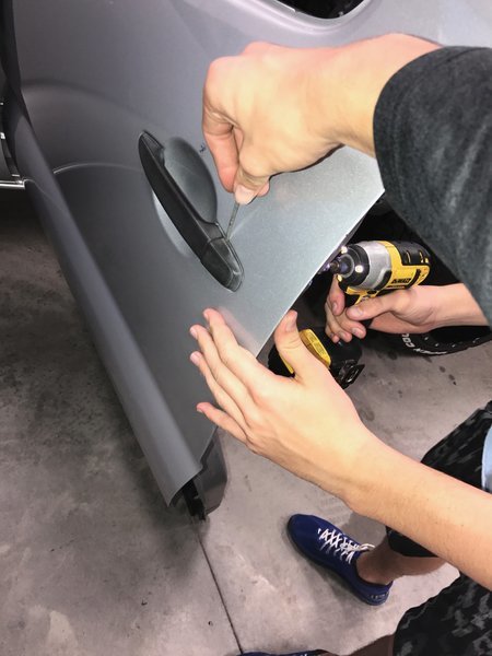

    Next, slide the handle towards the back of the truck as pictured.

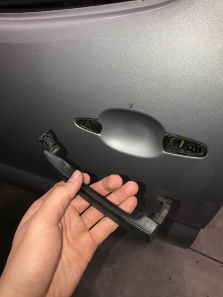

    Once the handle is slid backwards, pull the part of the handle towards the rear of the truck out.
    Once the rear is pulled out, simply slide the handle backwards again to remove the front part.
