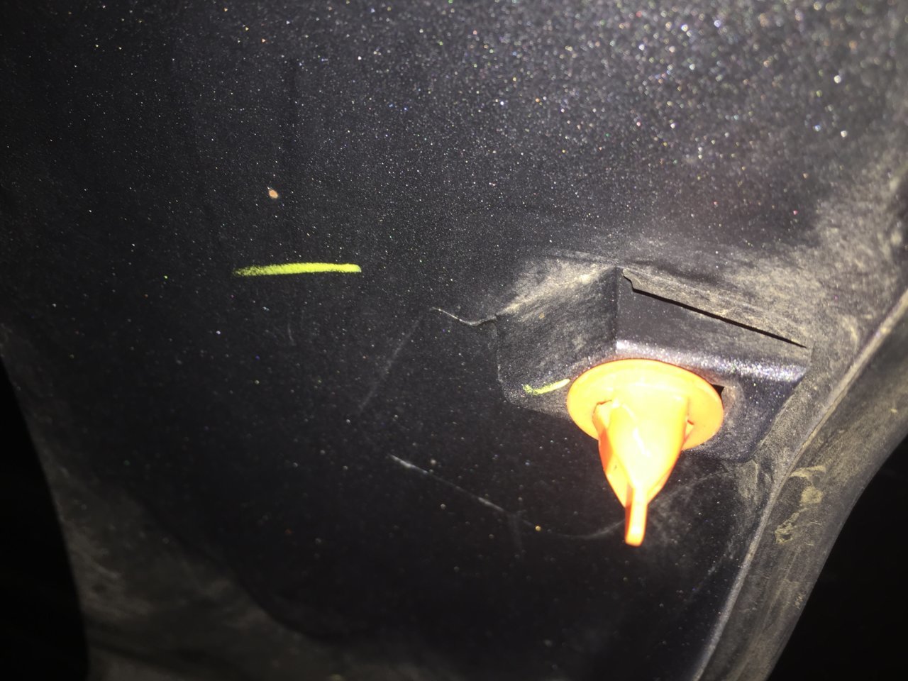

    image.jpg Anyone know the best way to remove clips from the flare? Really trying not to break the little standoffs

    2005 4.0 6spd 4x4 Dbl Cb short bed
    the little plastic clips that hold the flares on will definitely break.
    i can't remember the part number, but i recall a blue type and and orange type. you will need to buy replacements
    also, the tabs on the flares that hold the clips will break too
    I'm probably just going to throw my flares away at some point. epoxy putty is holding all the plastic bullshit together now anyway

    rotate the clips 90 degrees and they will come off
