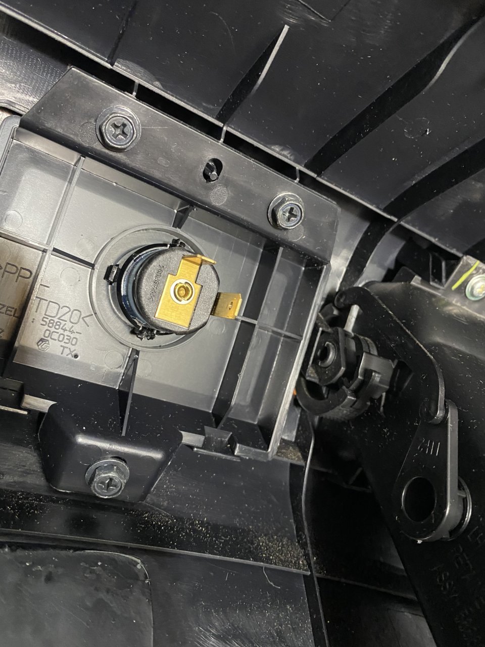

    This might help (starting at 06:43 timestamp)...

    I have the radio out, but still don't have access. In the video, he puts his fingers down through the hole I'm pointing to in the picture to unhook the cigarette lighter, and put on the lock nut. I don't have a particularly large hand and I can't even reach the back of the cigarette lighter through that hole! I can barely touch the one on the right.
    He didn't pop out the panel that contains the AC vents, but I'm tempted to. I can get the The right side loose, but the left side doesn't want to come out, and I don't want to force it, as there's obviously some ductwork attached. This is so frustrating! By the way, I had full access to that hole by simply removing the climate control panel. The radio didn't need to come out!
