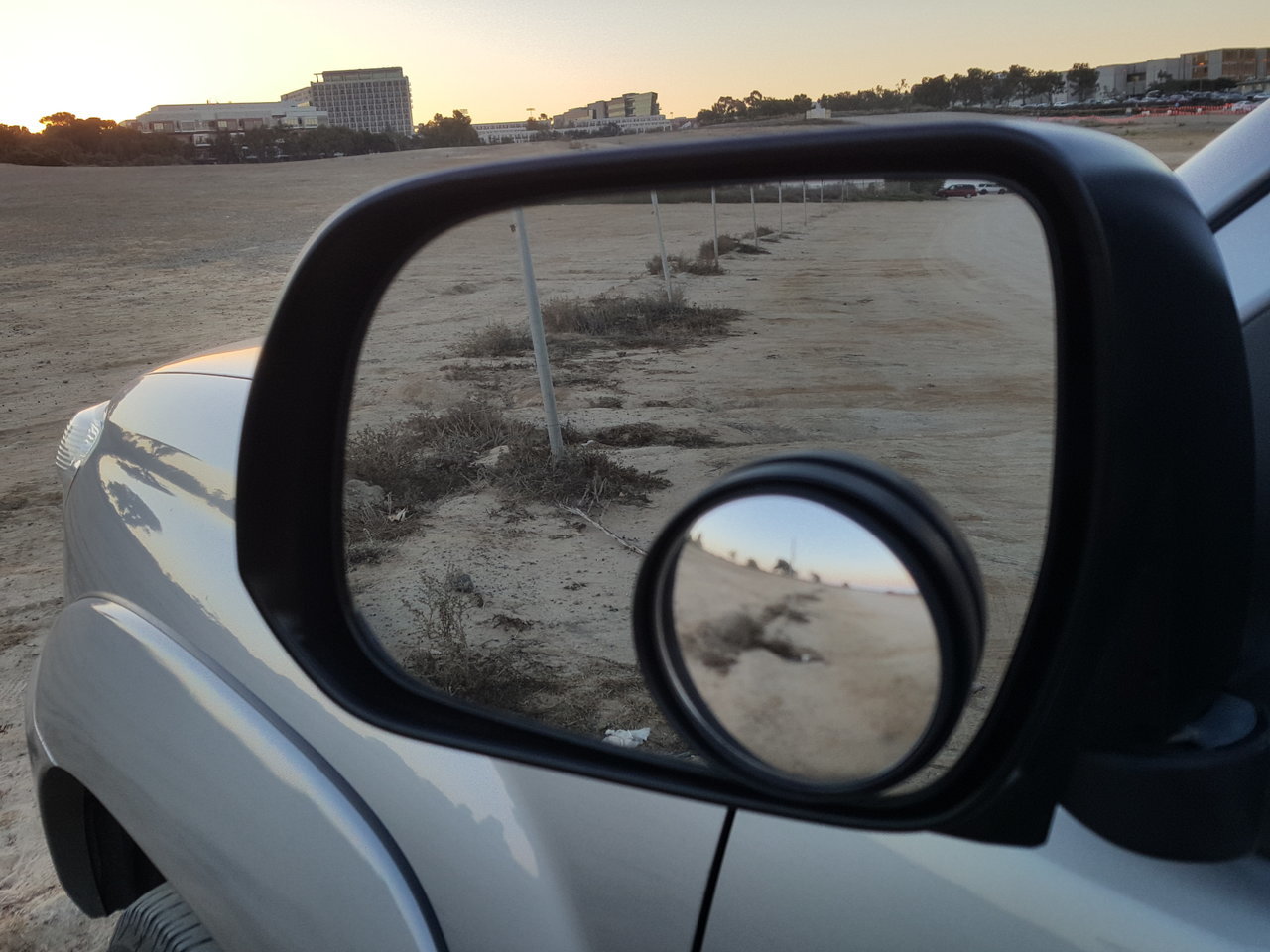

    Hi Guys,
    How can I un-stick and remove this blind-spot mirror , without the residue or maybe replace it with a square type one?
    Thank you so much!20171006_065311.jpg 20171006_065317.jpg 20171006_065333.jpg

    Just pull it off...if theres left over residue on the mirror wd40 and a rag will take it right off
    Edit: are you trying to re-use it?

    I've heard of people using fishing line to saw through double sided tape on emblems. Might try that, if the mirror doesn't pull off easily.

    Use a hair dryer or heat gun to warm the adhesive first - it will come off much more easily.

    If you’re careful you can scrape residue off with a paint scraper knife. This can leave scratches though.

    As mentioned above, fishing line and a hair dryer would suffice! Maybe some goo-gone or similar to remove the left over residue too.
