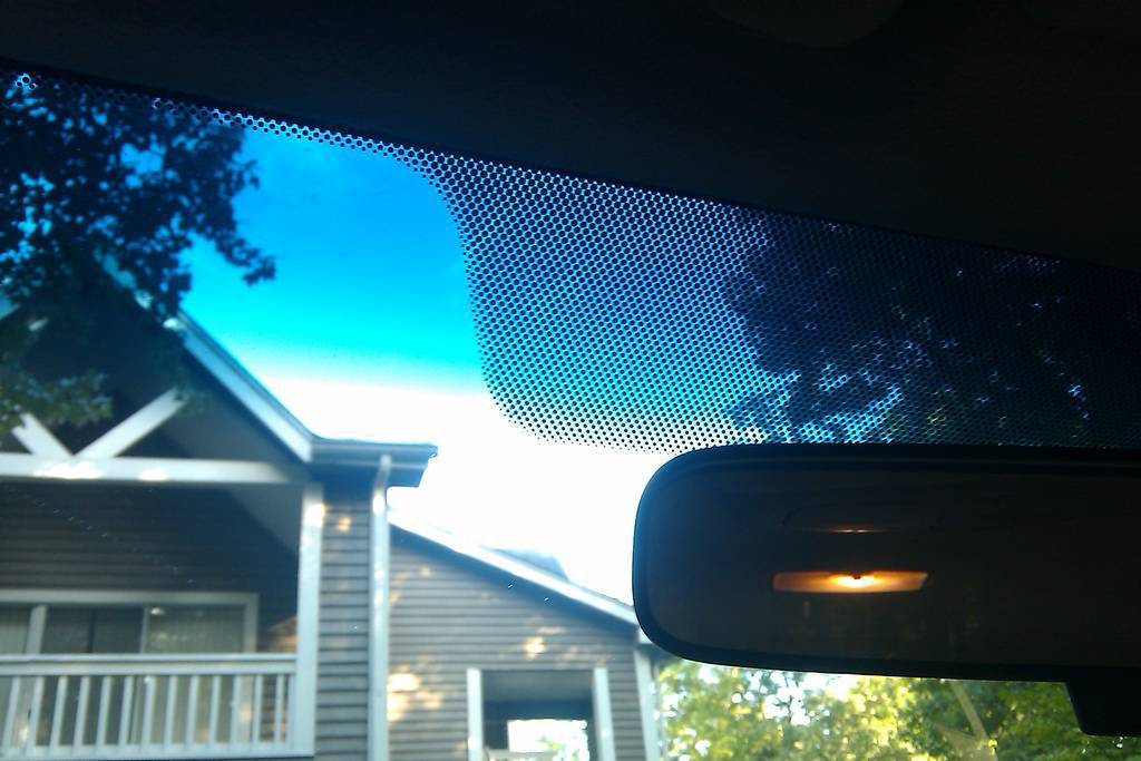

    I had a dash cam wire clip that was mounted onto the upper part of my windshield.
    When I removed it , it left behind some adhesive residue. My problem is that the adhesive is stuck onto the part of the windshield that has a light factory blue tint and some black dots on it. If I use goo gone on it, will it mess up this area? Here's a pic taken from a tacomaworld member to show you the area.
    Thanks

    Have you tried a basic window cleaner?
    And....I mean....spray it, let it soak.... wipe. Spray it...let it soak...wipe. It might take a while but at least you're using window cleaner.
    I can't comment on goo gone. Personally, I'd just use window cleaners and some patience.

    I paint guitars as a hobby and alot of times i need to remove a ton of stickers
    Before i paint them and WD40 always does the trick. Spray a little on a rag and it should come off.
    But just like ^^ said i would try window cleaner first

    I would have no problem using goo gone as it's a citrus based cleaner. I would try window cleaner first then goo gone then wd40. wd40 does work well, but is more solvent based.

    Thanks , really appreciate the advice. After I come back from vacation I will use the window cleaner method. I have used window cleaner in the past to try to remove it but I didn't let it soak. I'll keep you posted.
