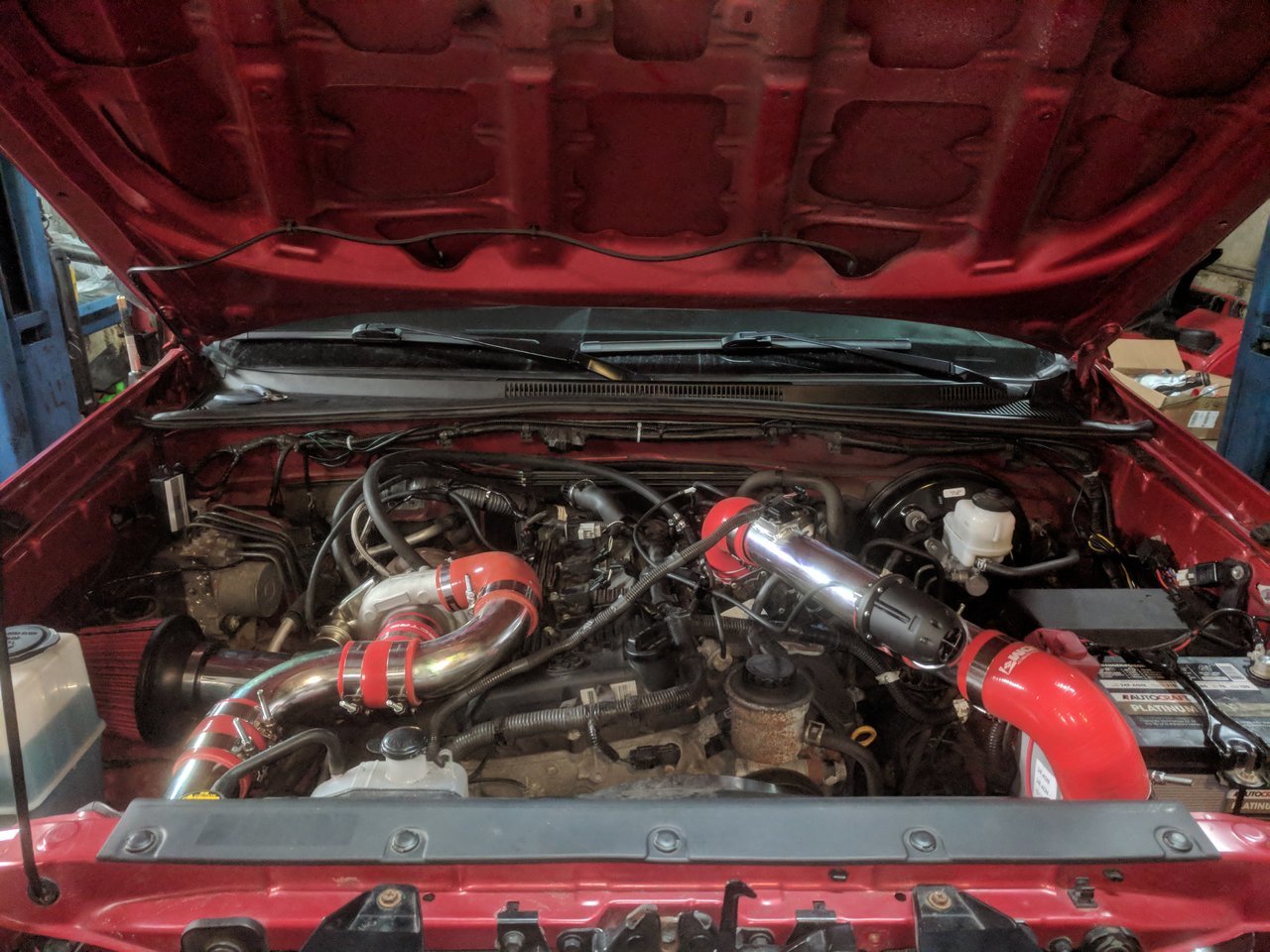

    The pillar is a Lotek pod for the 05-11 Tacomas (even though I have a 2013- it fits without issue)
    The turbo setup is a GT2871r on 6psi for the time being.
    Stock injectors (289cc)/pump until spring time, then I'll be upping them to run E85.
    Tuning is handled by an AEM FIC-6, which bypasses the MAF sensor and uses an onboard MAP sensor (more reliable and handles more boost)
    The manifold & downpipe I purchased from an overseas supplier. Everything else was bought individually. OZBoost makes a kit, but it's absolute garbage so I just sourced the manifold from their supplier.
    Anymore details you'd like to know, just ask!
