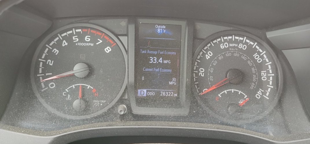

    Just scratched mine (again/more) trying to gently wipe dust away using a lintless KimWipe and distilled H2O. The scratches are officially an annoyance. Is there ANYTHING to be done short of replacing the glass?

    Glad this thread popped up. Not only was mine already scratched the day I drove it new off the lot, there's a trail of dust under the odometer reset stick, and now there's now big crack creeping up the center of the glass. WTF, Toyota?
    My first car (Toyota Celica GT) had the gauge glass angled downward. No glare, no dust. It got a little scratched with my clueless 16 year old cleaning methodology but I got some plastic polish and made it look good as new. It wouldn't have been a big deal for Toyota to A. Angle the glass so it doesn't catch every single dust micron and B. Put some sort of coating on the cluster. Not gonna even get into why it's cracking now but... whatever. Thanks for this thread. Gonna order a new glass and the Screen Protech.
    Sidenote, have you guys figured out how to keep dust out of the odometer reset stick? That drives me nuts as well. Like I love this truck and they're famed for their build quality but I'm tired of seeing this crappy screen.
