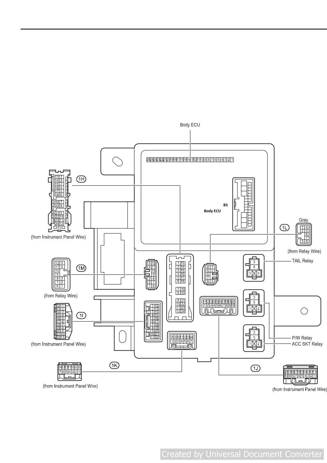

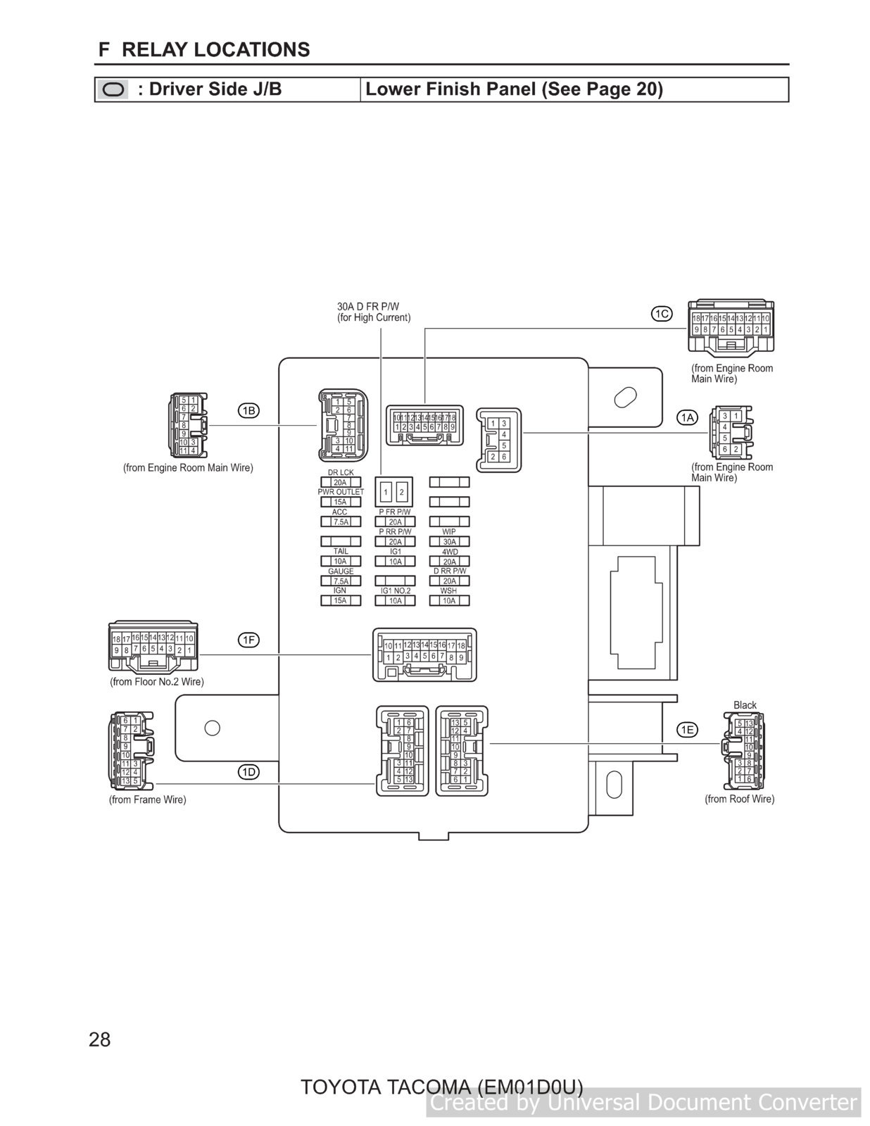

    Did you ohm them out? Body ECU/Driver's side Junction/Fuse box connector diagrams below.
    I guess it could have, you could take the receiver module apart and look for cracked solder joints.
    I guess it could be but I would think the panic would still work even if the switches in the door weren't working properly.
