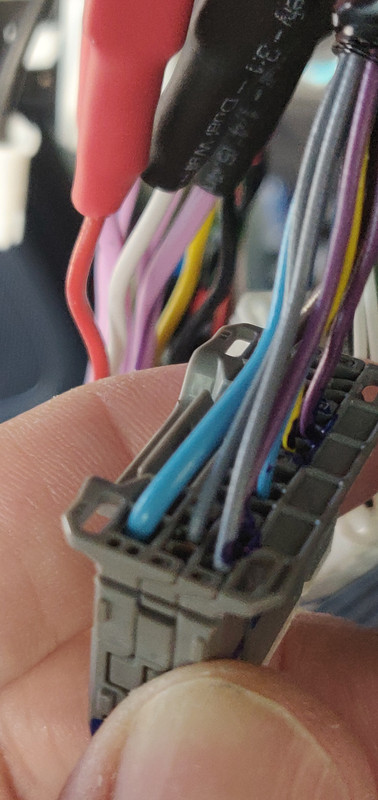

    Find the blue wire on the radio adapter harness labeled “power antenna” . Thats the remote turn on lead for an amplifier.

    Can you post a picture of the wire side of this connector

    Yeah something like that is ideal, or tapping into the cig lighter wire

    Here you go sir. I think I will try the add a fuse way @joeypdx , I think that should be a lot easier but I will be interested to know which wire should we use (if you already know) for personal knowledge :)

    As a future reference, it’s one of these two grey wires. I’d have to find the diagram to know for sure. Then always test it with a meter before you start splicing
