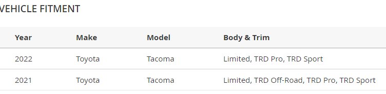

    Hi All,
    Wanted to confirm if this remote tailgate lock works specifically with the '22 TRD OR DCSB.
    Not sure why but all the Toyota parts sites say it doesn't fit:
    Just wanted to double check before I pulled the trigger on the purchase. Thanks for the help.

  2. Sep 21, 2022 at 2:57 PM
    Siblue
    Siblue Well-Known Member
    Dec 2, 2014
    #143489
    3,103
    So Cal
    22 Tundra
    That’s the part number I have.
    I’m removing mine if you want it.

  4. Sep 21, 2022 at 2:59 PM
    TRDsport253
    TRDsport253 Well-Known Member
    Nov 15, 2009
    #25945
    1,740
    Edgewood, Wa
    2021 TRD sport 4x4
    TRD Wheels TRD Skid plate
    I have the same kit. It should fit. Just make sure its for the DCSB and not the DBLB.

  5. Sep 21, 2022 at 2:59 PM
    Siblue
    Dec 2, 2014
    #143489
    3,103
    So Cal
    22 Tundra
    S and L specifies the difference

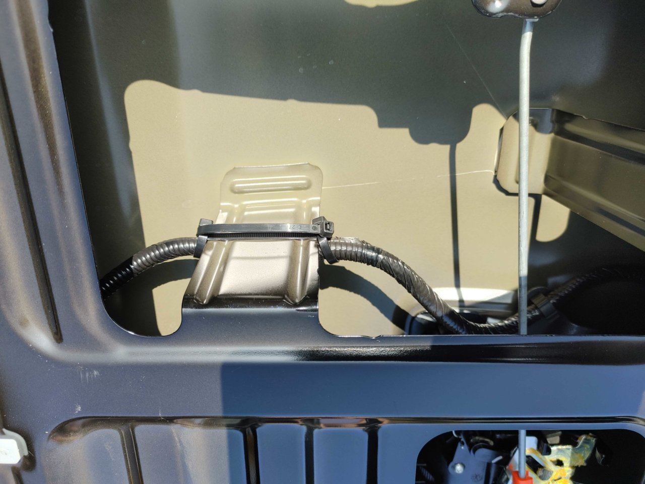

  13. Aug 29, 2023 at 5:47 PM
    nier1947
    nier1947 New Member
    Oct 22, 2022
    #408597
    2
    mrbperboss[OP] likes this.

  15. Sep 1, 2023 at 7:26 PM
    nier1947
    nier1947 New Member
    Oct 22, 2022
    #408597
    2
    @nucl3ar Thanks. I went with a bit more of a bootleg, "this won't rust but I hope it lasts," route.
    mrbperboss[OP] and nucl3ar like this.
  16. Sep 2, 2023 at 6:42 PM
    #16
    nucl3ar
    nucl3ar 2021 White Tacoma Limited 4x4
    Apr 24, 2021
    #363756
    93
    Raleigh, NC
    OVTune Meso Total Tail Stage 1 tail lights BAKFlip MX4 Tonneau Cover
    Very clean! Creative idea as well. I may have to open mine up and copy you haha.
