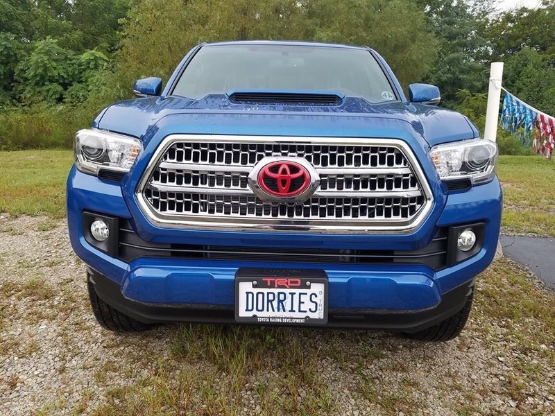

    I love this new Tacoma and check out the fancy logo on the windshield, and red logo...
