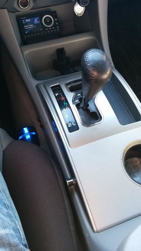

    I put mine in my center console.

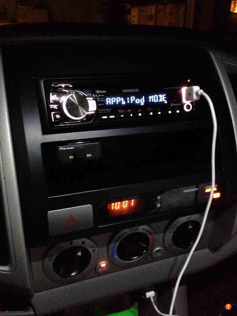

    I know this is bringing this back from the dead but I finally got around to screwing with my Alpine bass remote knob and found a home I'm happy with finally. I had initially mounted it out of sight and out of mind in the tray beside my left knee in the dash but after a few weeks I found that simply wasn't convenient. I had to shift around a bit to get the door open and reach down to get to it...wanted a simpler "at hand" way to adjust on the fly. After taking apart the case on the knob I found it was just about perfect size to fit in one of the block out plate locations on the dash. I didn't want to permanently modify the dash so the fact that it fit was a bonus. I took a dremel to the back side of the blank plate and made room for the switch to fit...took some time to get just right but I'm very happy with the results.
    The plate fits back in and will be easy to replace when the truck gets passed along. It's within easy reach and can't really be seen from anywhere outside the truck or inside if you aren't in the drivers seat. My left hand can fall on it naturally by resting on my leg so ergonomically speaking it's perfect. I dig it.

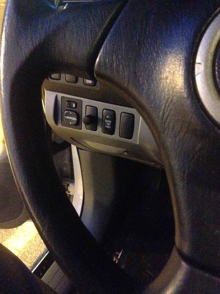

    I put mine in the cubby to the right of the steering wheel, its hidden and easy to reach.

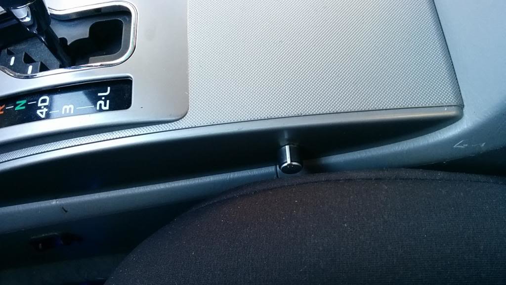

    BUMP- old thread but seems like it was a great one!
    what do you all use to mark the bass knob level (assuming it doesn't come with a stock white line?) mine just had a groove in the bass knob and I got a very fine white paint pen and marked it but then started thinking about possibly a glow in the dark paint line to see at night bc i can't see it (have it to the left of steering wheel in a blank). just curious if anyone has done this or has ideas on how to get an illuminated line look for the bass knob or an even better idea possibly. thanks! **please see my knob below ! (yeah I know how that sounds):yes:
