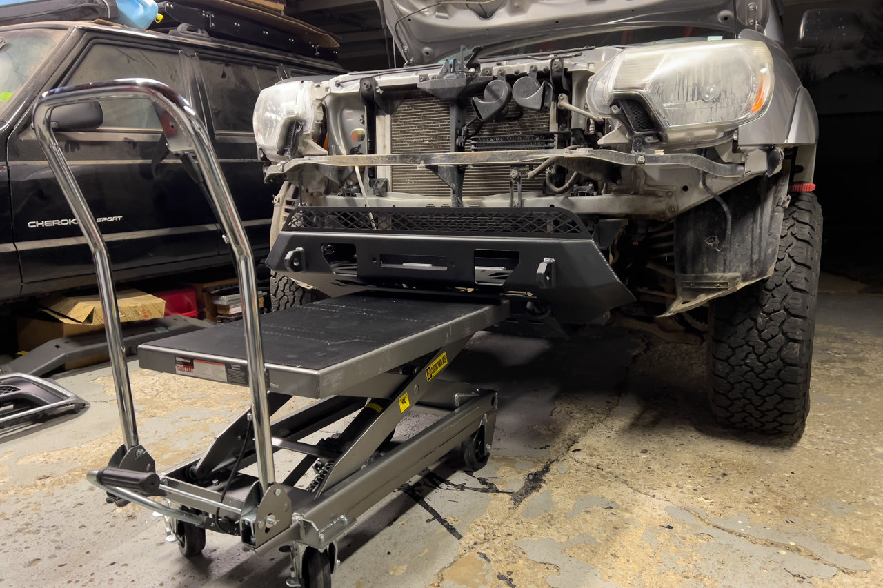

    Well I was originally going to wait until spring to install mine because I have new headlights and fogs that also need to go in, but bumper was taking up space and I decided to do it last minute with a snowstorm bearing down. Just couldn't wait any longer to see how it looks and I'm 100% happy with it.
    Couple notes maybe to help others in the future:

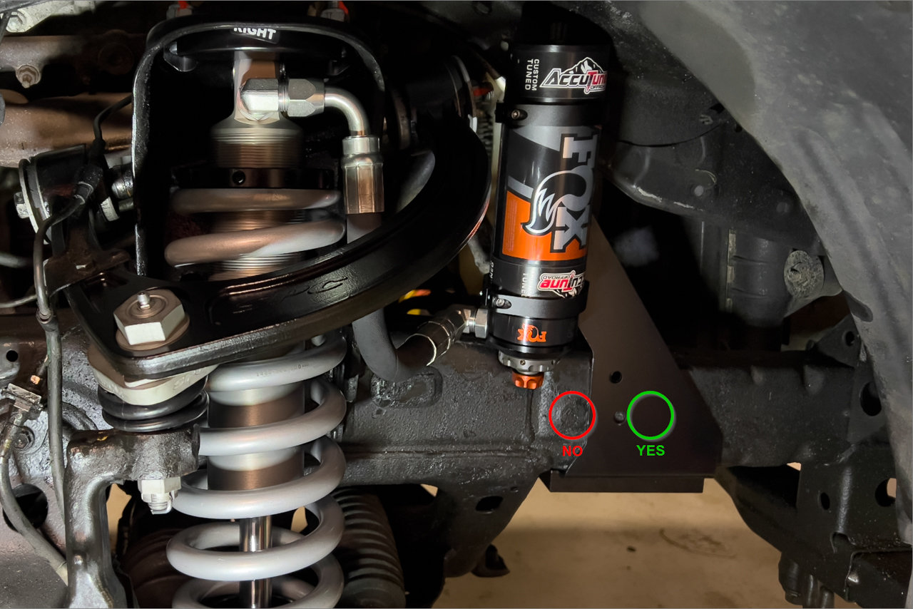

    I left the winch off for now because I mistakenly thought the support braces mounted to holes behind my front shock reservoir mounts. That's my fault for not looking closer. Turns out the actual holes are behind my particular res mounts and need some drilling. I had no time and weather is going to turn real bad here soon so mine has to wait until spring. Plan accordingly and test test test if you have mounts like this.

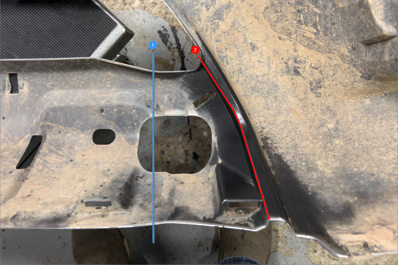

    I cut the center plastic section with a Milwaukee M12 rotary and a cutoff disc which made short work of things. First cut was just to remove the bulky center part. Then I made the more precise cut along the red line shown below. Like the instructions say you can always leave more material on at first and trim it back later but it's much harder to add material back! Don't stress much on this, it isn't hard and the bumper itself will hide most of your mistakes.
    Harbor Freight hydraulic lift cart also makes short work of lifting the bumper if you don't have that fancy body shop bumper like @stoltz23 (but that bumper lift is definitely a sweet tool!).

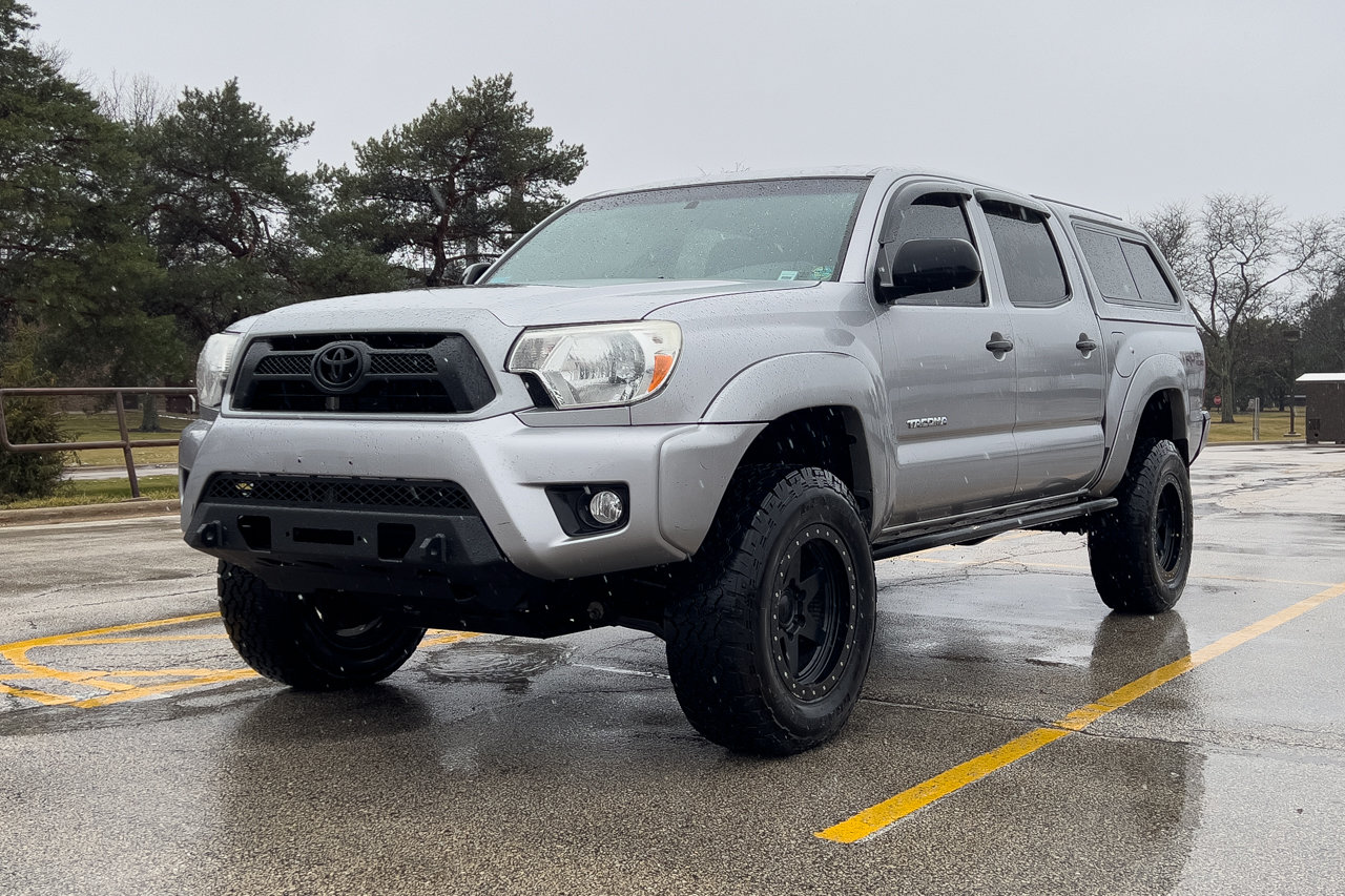

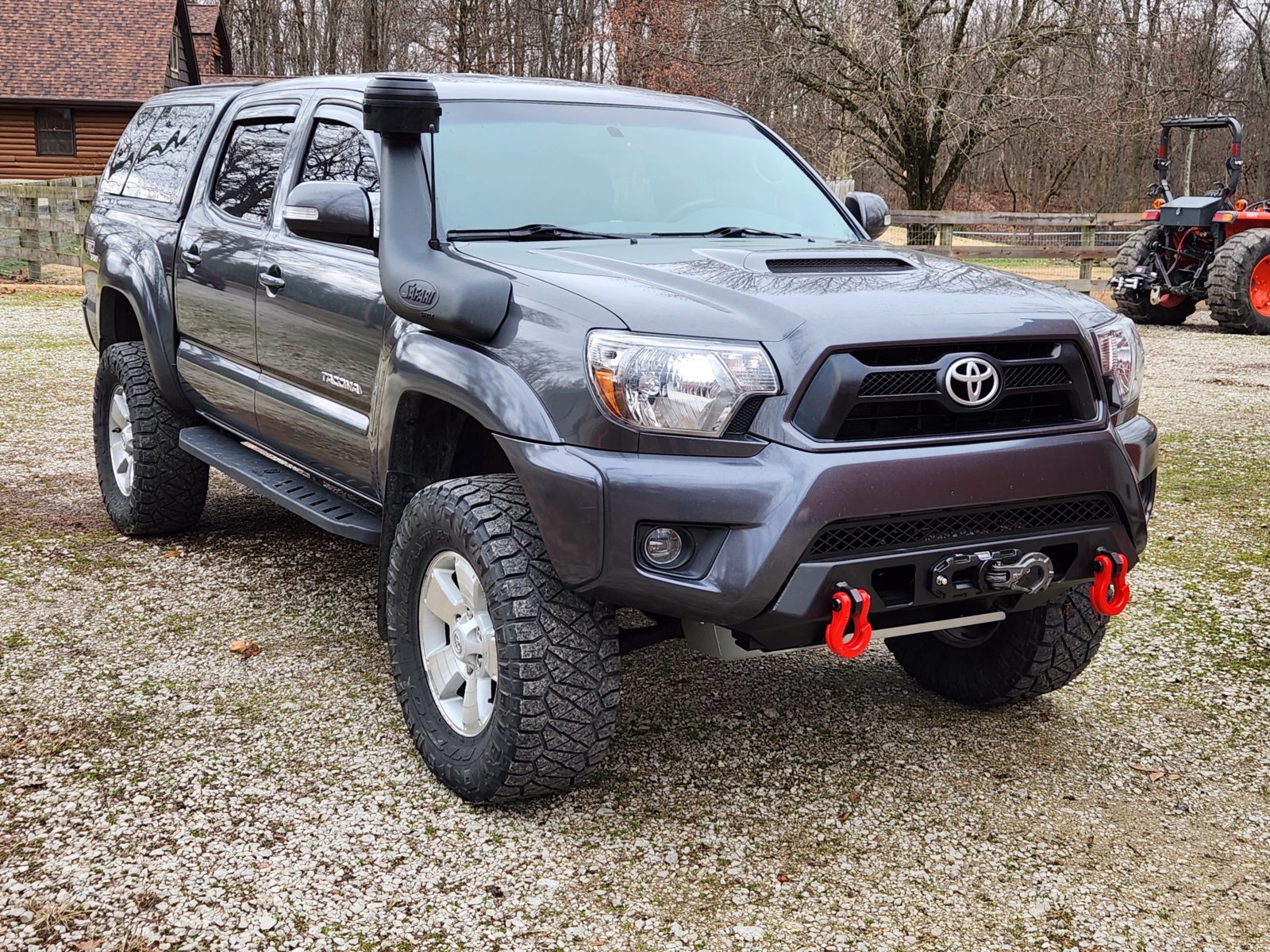

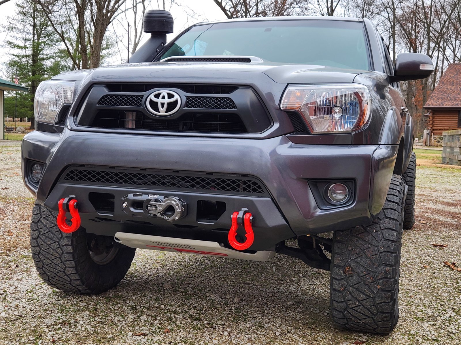

    Was able to get a better photo of my stingray bumper out in real life, wanted to share back here to keep this thread going and encourage others to hop on the next round of group buys. Lots of compliments on this bumper, definitely the most unassuming "OEM Plus" model you can buy hands down. I'm still waiting on a few parts and for spring/summer to arrive so I can install my winch but it will be in there soon.

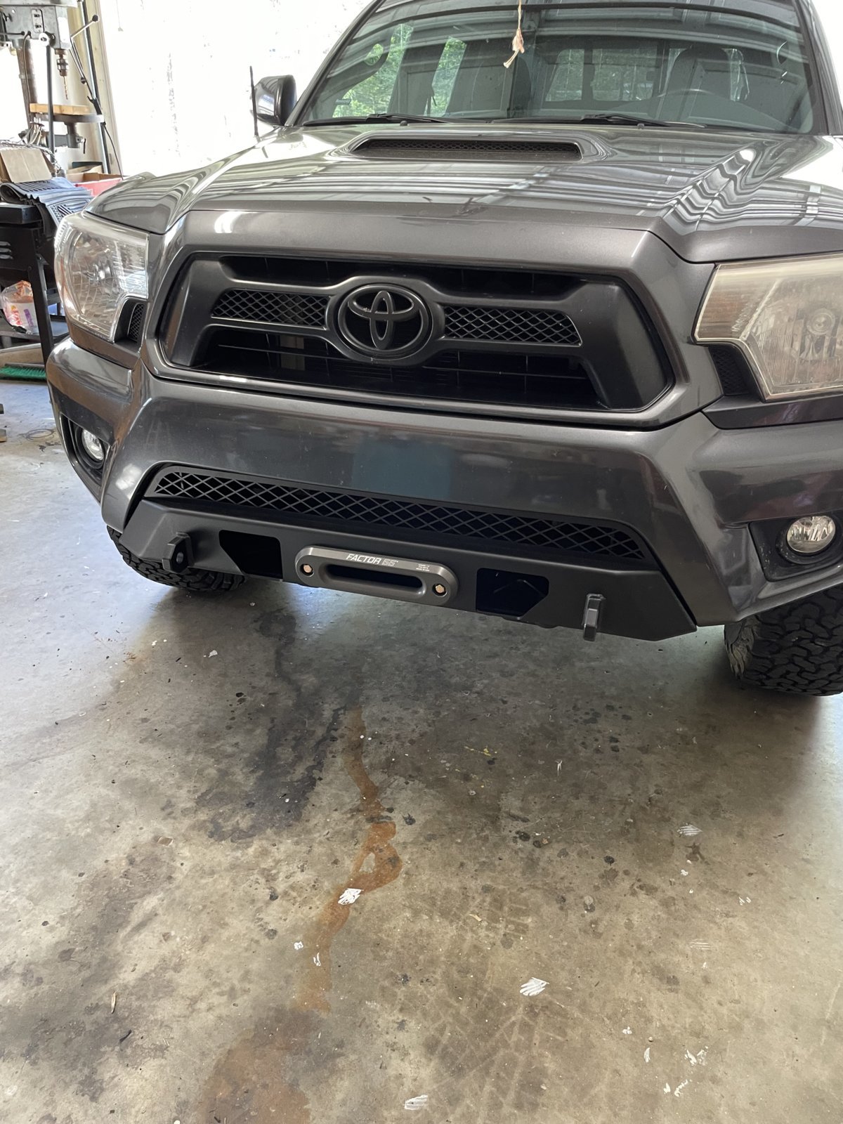

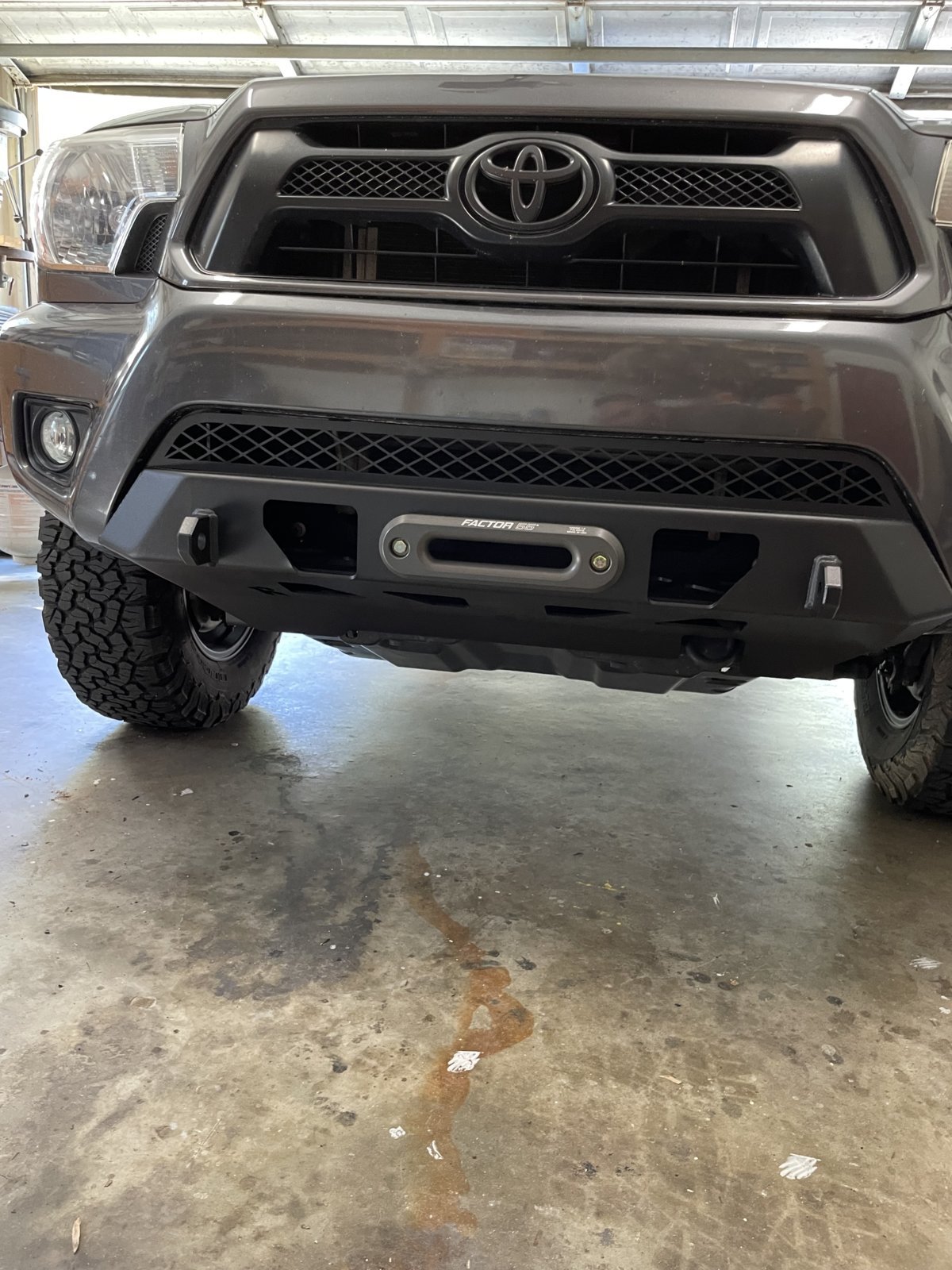

    Not the greatest pictures but I finally got my bumper mounted. Now just need to get my lift so I can mount my EVO. IMG_5323.jpg

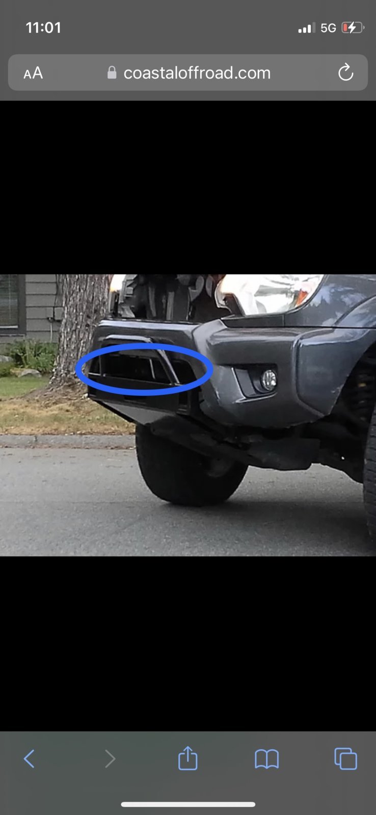

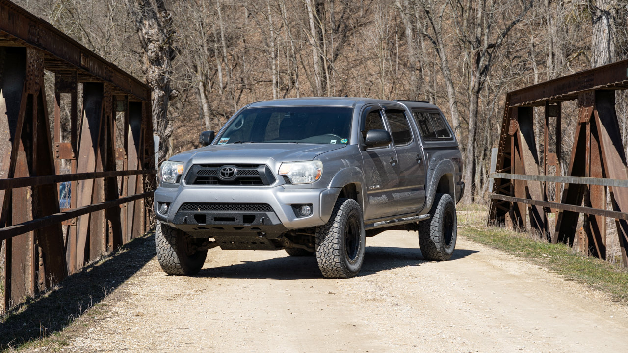

    So if you look at this picture you can see the area I have circled is open completely open. So depending on how you want to cut your bumper you can give yourself an access hole to access your free spool lever or just have it wide open like this person did.
    I do agree though, Coastal has been slacking on their pictures on their website which is something I’m working with them on. If you reach out to them via Instagram I’m sure they have a few pictures that are much better that they can show you. If I get in contact with them before you do I’ll ask for some
