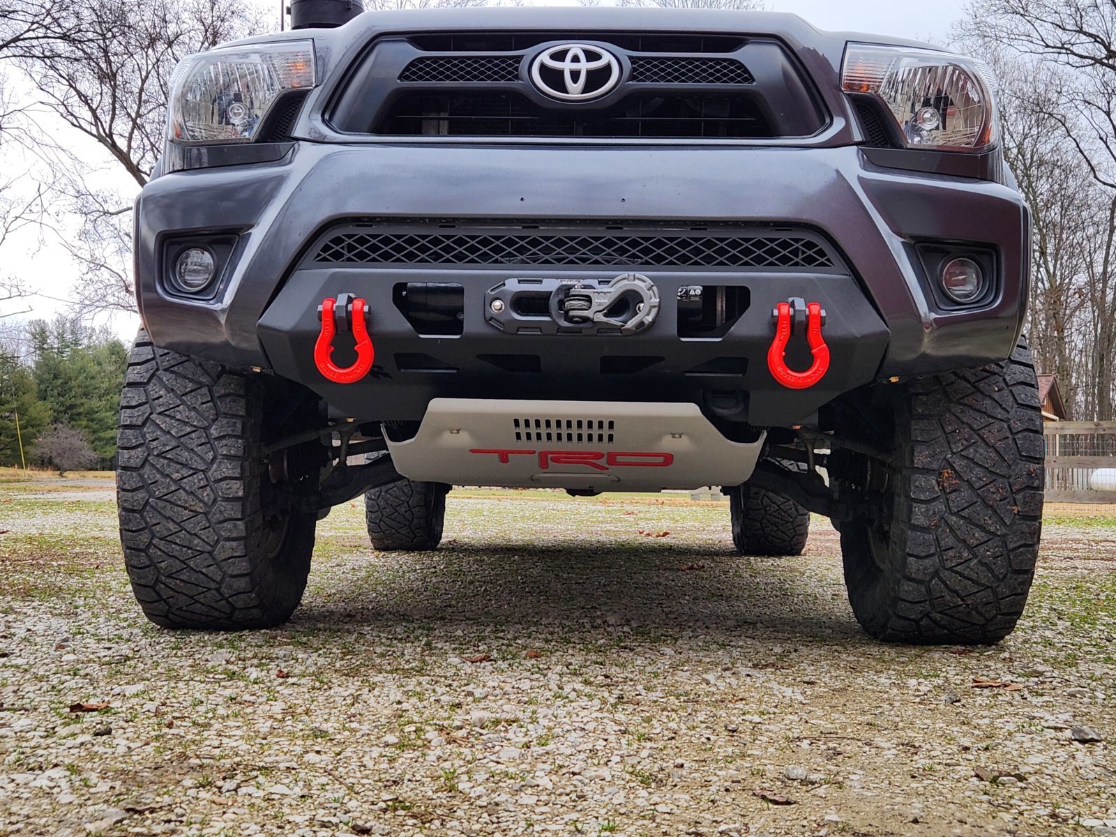

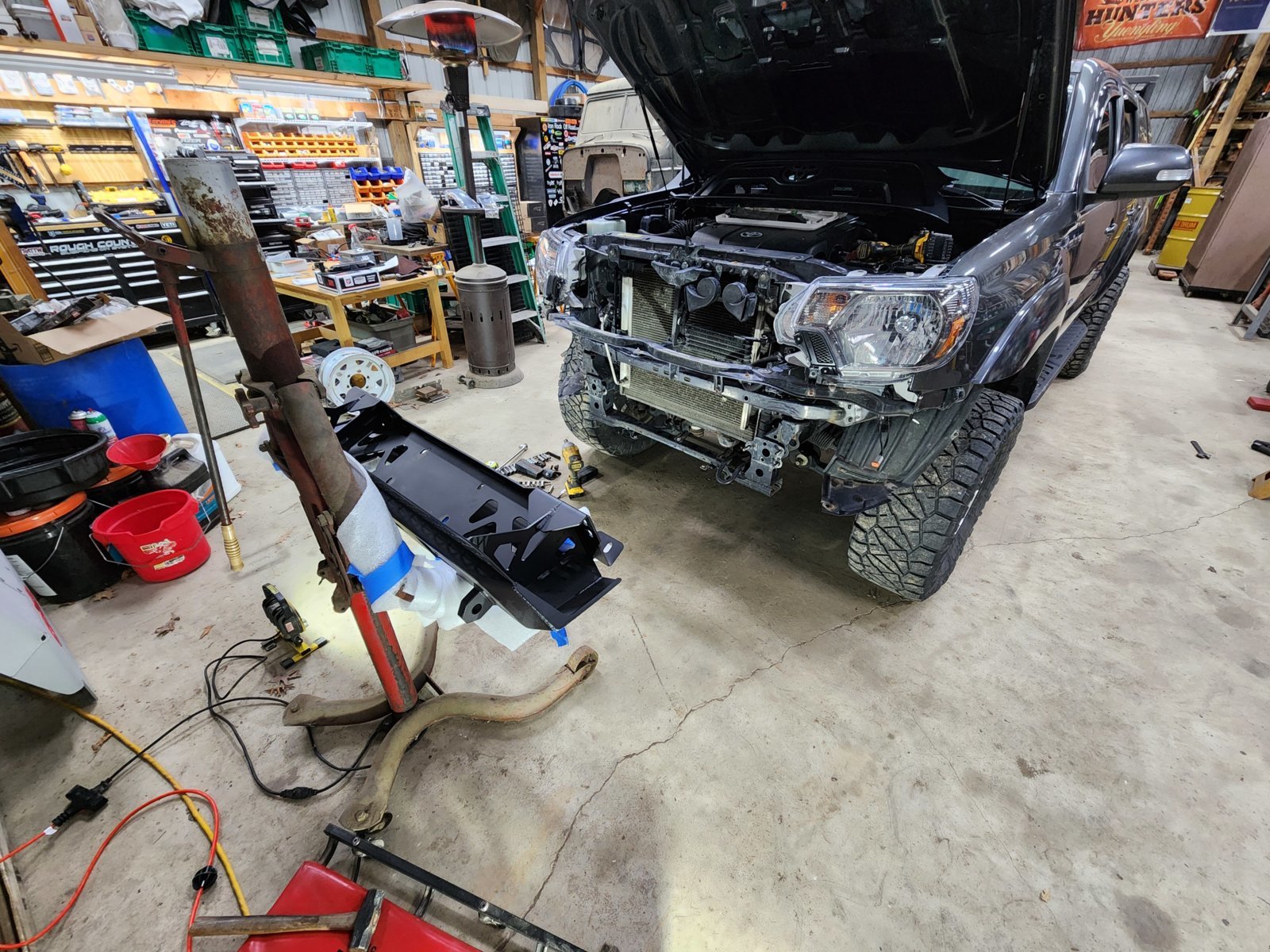

    Working on installing mine today. Old school milkwakee bumper jack sure made any work of any lifting.
    Kolter45, EMR, wi_taco and 2 others like this.
  15. Dec 31, 2023 at 12:33 PM
    #1455
    stoltz23
    stoltz23 Member
    Oct 17, 2022
    #408226
    23
    Phil
    Here is everything all buttoned up.
    Winch is a warn VR12-S with a warn epic fairleed and hook and a AEV hook isolator. Shackles are mooseknuckle split jowl. I may have them powdercoated a deeper red as in the sunlight they are bright red.
    Bumper instal was pretty straightforward. I did have to bend the factory bumper studs in a little to fit over the bumper. I showed the outside of the studs measuring 1/8" wider than the holes. The factory aluminum bumper was tight and the studs may have bent when trying to remove it also.
