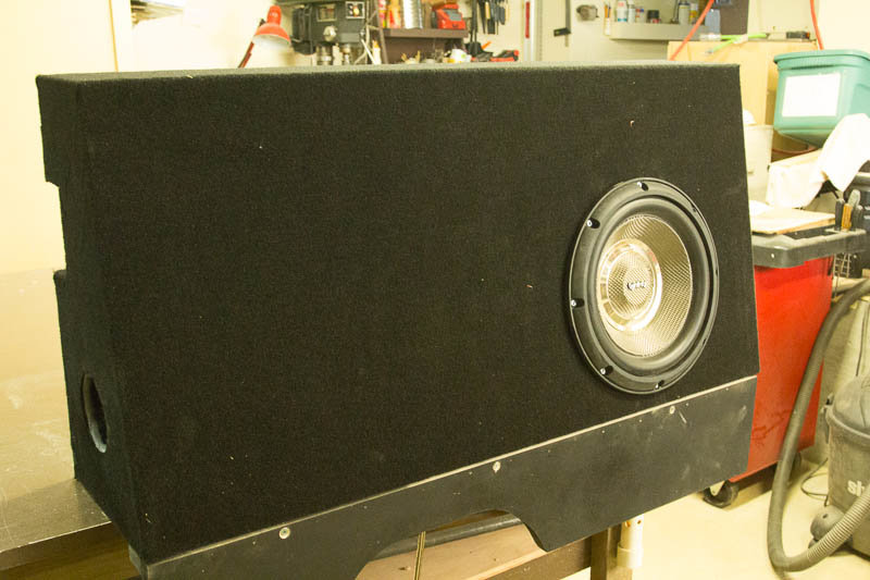

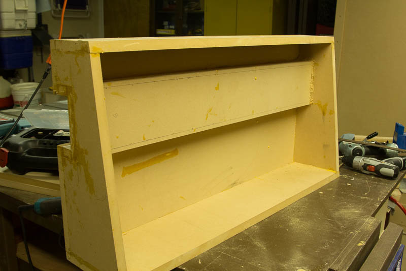

    Box modeled around Infinity, 1.5 cubes tuned to 30hz. with 3in aeroport.
    Right after I took this picture below I realized that I had put the bottom piece on wrong. So I had to rip that off which was a pain because I was using both 18ga 1.5in nails and screws. Luckily the glue wasn't dry. But still had to cut new side pieces. Wasted about two hours.
    The channel was built to fit over the child seat anchors. I had to remove the jack mount however. I added in a brace (three screws in middle of box) and used Tnuts and hex bolts for the sub.
    My carpeting sucks, I used an entire can of 3m 90 spray glue - expensive but works well. The bottom piece helps for support. 3in pvc port just filed down a little to add a little flare at both ends.
    Impressions: When first turning on.. holy crap it's so loud. Gains were set right, but I had to turn the sub volume on my head unit and my bass knob(inline attenuator) way way down. I couldn't get the sub to bottom out, where as with the sealed setups, it would distort relatively quickly on some songs. I definitely got the volume I was seeking at the slight cost of sound quality. Never having a ported box, I am quite amazed. I got a quote for about $250 for a custom box, I spent about $100 for materials.. next time I will gladly pay the money to have it built. The angles, the channel.. pain in the ass. I think from start to finish it took about 9 hours including clean up.

    I still have the box, still love it. I did make a few modifications along the way though. After a few weeks I began to wonder if my sub wasn't performing the way it should - it just sounded like it could be a little tighter and go lower. Anyway, I had the great idea of buying an identical sub and sealing the box. So I removed the port, sealed it up and added a second Infinity. I ran it that way for awhile. The sound did clean up a little, but surprisingly to me, I lost a lot of volume. Only after all of this did I break out the calculator and run the numbers on the box again. I had made another mistake and did not calculate the space the port took up. Curious, I removed the second sub and sealed up that hole. Then I took the exact same port I had used earlier and mounted it externally... and it made all the difference in the world.
    So now I have an extra sub and my box is now a frankenbox. But it sounds like I hoped it would and I have no more urge to experiment.
