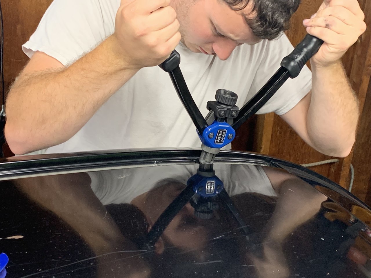

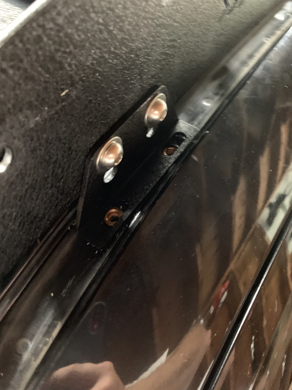

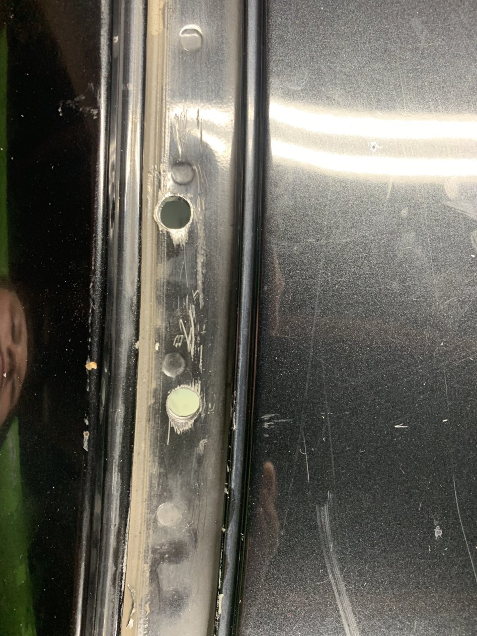

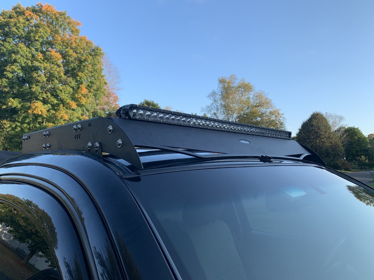

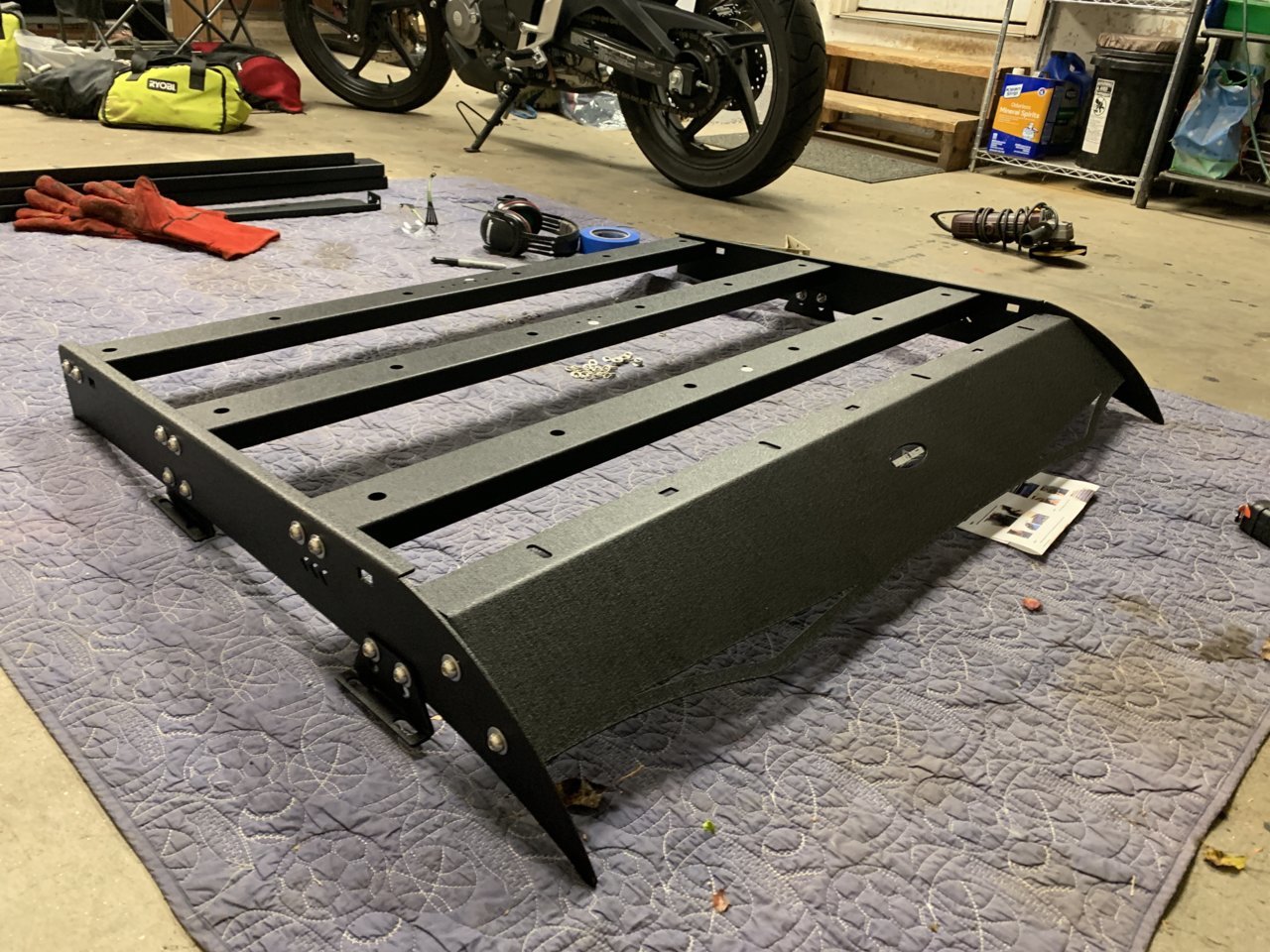

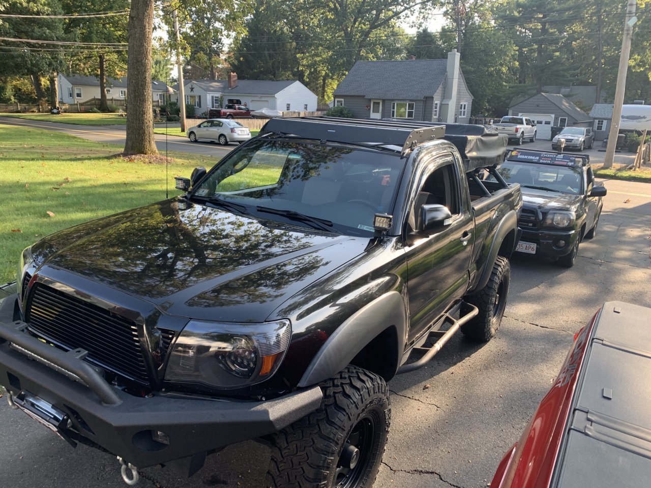

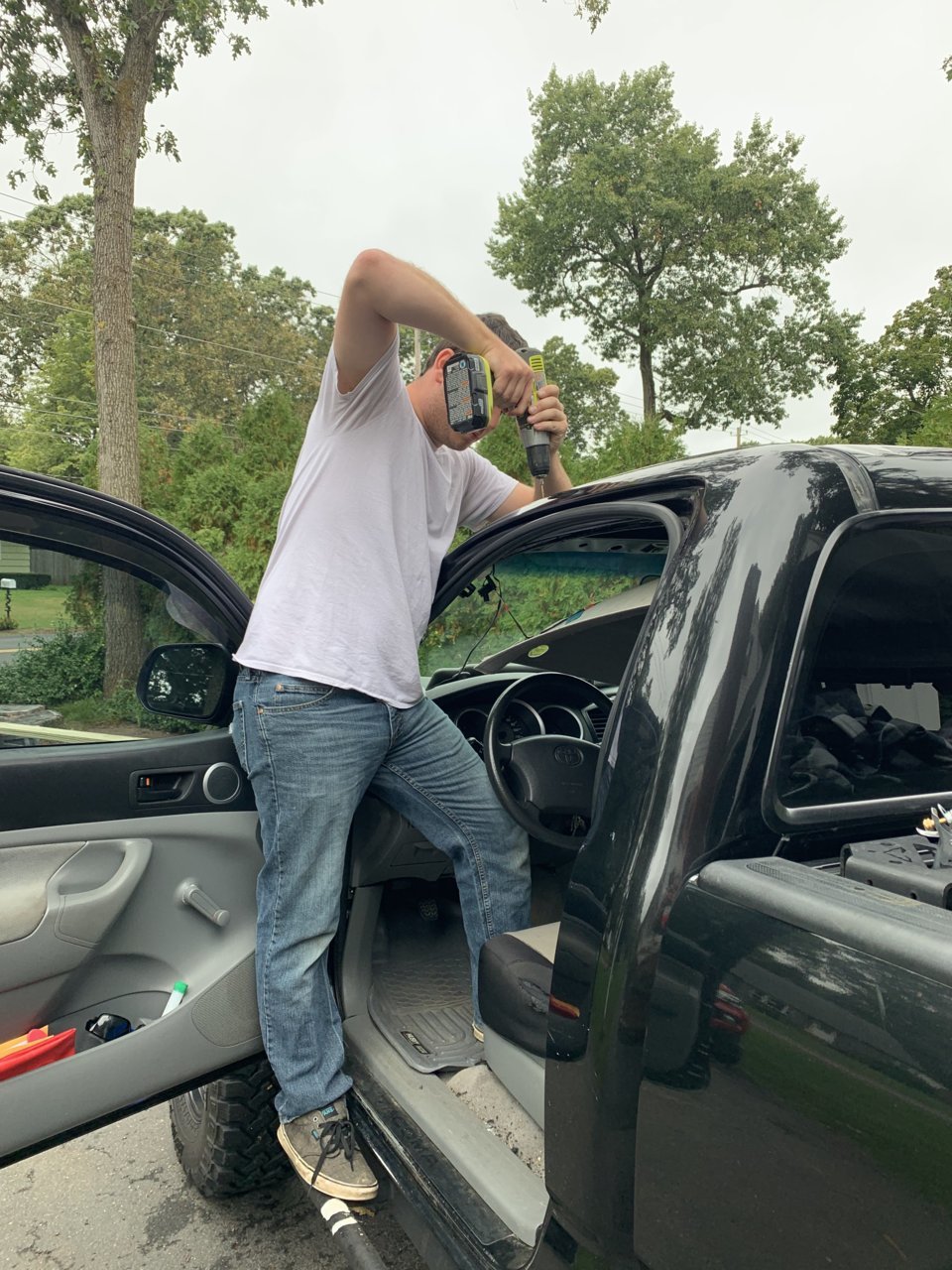

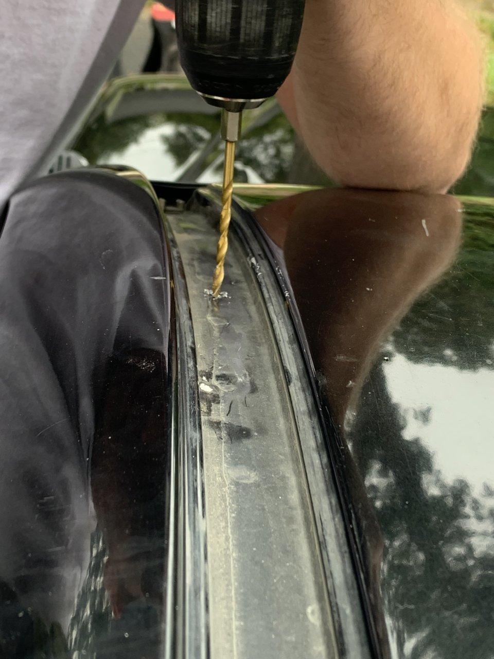

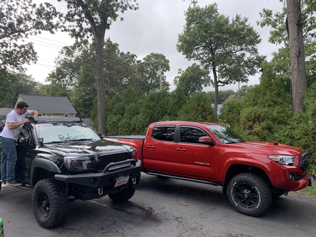

    I just did this...

    Wow... thats perfect! I guess I'm really hesitant to go drilling into my baby but that's exactly what I had imagined. I'm sure with some slight modifications it wouldn't be hard to extend it over a cap. Do you have any leaks after drilling holes? Appreciate it!

    No leaks! You will want a separate rack on top of the bed because the bed and cab will flex differently. Mine is a Hooke Road rack which I modified. You could do the same and get a second one to mount on the cap?
    Honestly install was stressful but I took my time and it came out great.
