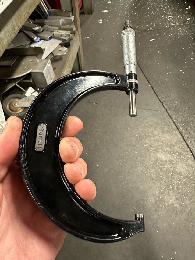

    My boss man’s dad, when he still owned the place he bought a set from 0-9”. Here’s the big boys.
    jwctaco and mtip like this.
