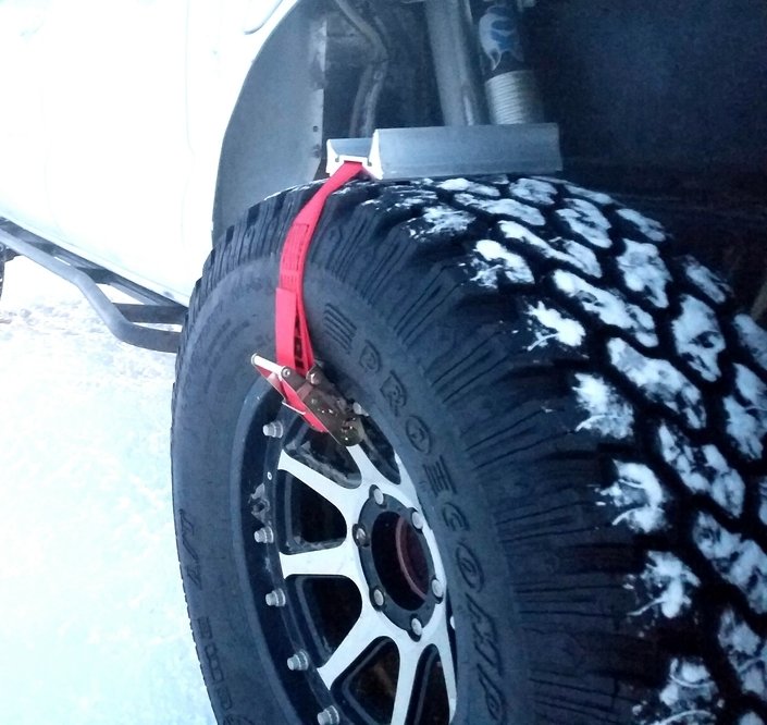

    Those of you who have seen my threads here over the years know that I am no stranger to those "temporary lack of forward momentum" moments. I like to push it, and I go prepared to deal with the consequences. While looking for a low profile set of tire chains for my wife's SUV, I stumbled upon a product that was marketed as a traction aid / recovery device that I have not seen before within the offroad scene. It's essentially a refined evolution of the age old trick of ratchet strapping a 2x4 to the tire of a stuck vehicle.

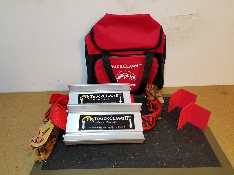

    Here's what a set looks like. The plastic wedges are to protect the rim of your wheel. Not really needed on our trucks that have enough sidewall to fasten the ratchet against. In some of these pictures I have the ratchet on the rim of the wheel because, well, sometimes reading instructions is not my greatest strength...
    They sell for $159.99 for a set (https://www.truckclaws.com/products/truckclaw-ii?variant=7323545989). They also have super heavy duty versions available for semi-trucks and what not. If you're a truck driver and travel in places with bad road conditions, I would definitely consider a set of the heavy duty version.
    The principal of the device is simple – an aluminum “claw” is securely strapped to the tire, allowing the tire to bite into the terrain as the wheel rotates. They're very light and compact for a recovery tool, weighing in at just eight pounds and sized to pack into an area the size of a small shoe box. You need about 2" of clearance around the perimeter of your tire to use these and for offroad use it is recommended to limit application to your rear axle. The clearance between my tires and my bypass shocks is much tighter than your typical suspension set up and I had no issues with clearance.
    Installation is really straight forward - I was able to do both rear tires for the first time in one minute and thirty-six with winter gloves on at -25F.

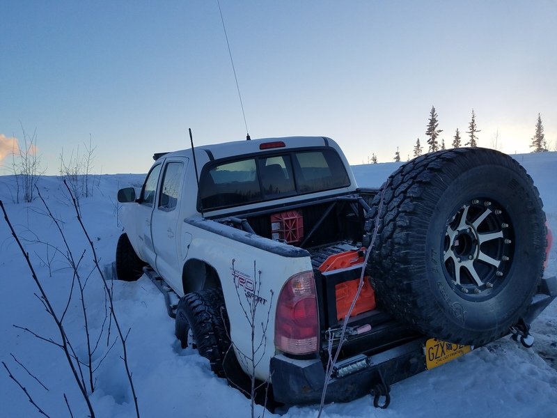

    The next location that I headed to was a short incline on a moderately steep berm covered with deep snow. Beneath the two feet of snow was a loose gravel base that requires some momentum to climb even during summer months. I paused for a moment to reflect on what I was about to do (purposely get stuck in deep snow at -25F) and backed over the edge of the berm. The results were predictable.
    Attempts to climb the berm without TruckClaws were unsuccessful, even with my front and rear differential lockers engaged. I was able to move back and forth on the flat ground, but would lose all momentum once I reached the incline. My first attempts cleared the top foot of snow from the area and revealed a loose gravel surface that was certainly no improvement to traction.
    I then mounted a pair of TruckClaws to my rear axle and attempted the climb again, this time with only the rear locker engaged. Although much more successful than previous attempts without TruckClaws, I still came short of making it back on top of the berm. I backed up again and progressed to engaging both lockers, which resulted in success! Every time I thought I was not going to make it, the TruckClaws came around again and provided a means for the tire to gain traction. The amount of snow and gravel being thrown was a clear indication of the sudden bursts of traction provided by the TruckClaws.
