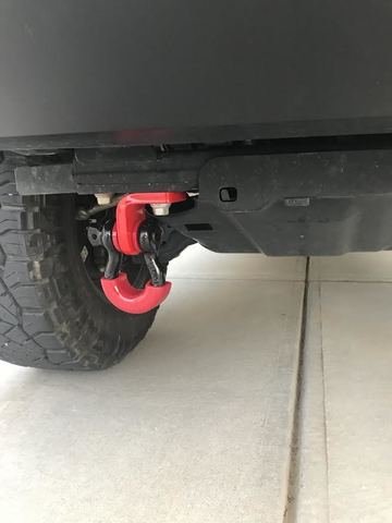

    Thanks. I'll check out that pump. I've ordered a front tow/recovery mount, my SR doesn't comes with one. Is the driver side tie down hook usefull in any way when it comes to recovery?unnamed__76432.1520988275.480.480.jpg

    It'll work in a pinch, but generally no. If you can avoid it, I wouldn't use it.
    It's just a hook, so there isn't a way for the strap to stay on the hook. The minute you get some slack in the line, it'll drop off.
