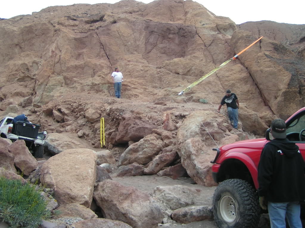

    a snatch block is essential to have for recovery other then using it to reduce load pull..can allow to use a winch and odd angles to conduct a recovery...

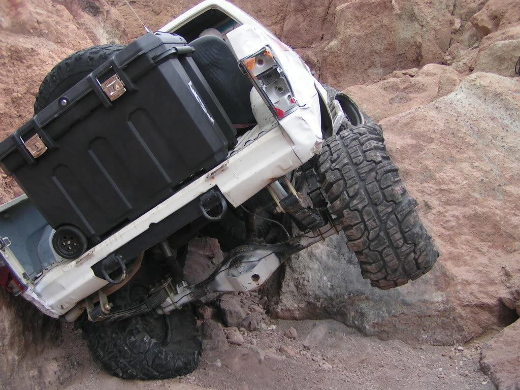

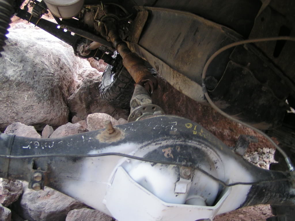

    here's my buddy Tim who attemted the "Gate Keeper" at Calico...twisted his rear driveshaft and debeaded 2 tires all withing 2 minutes...if we didn't have that snatch block, recovery would've been next to impossible..

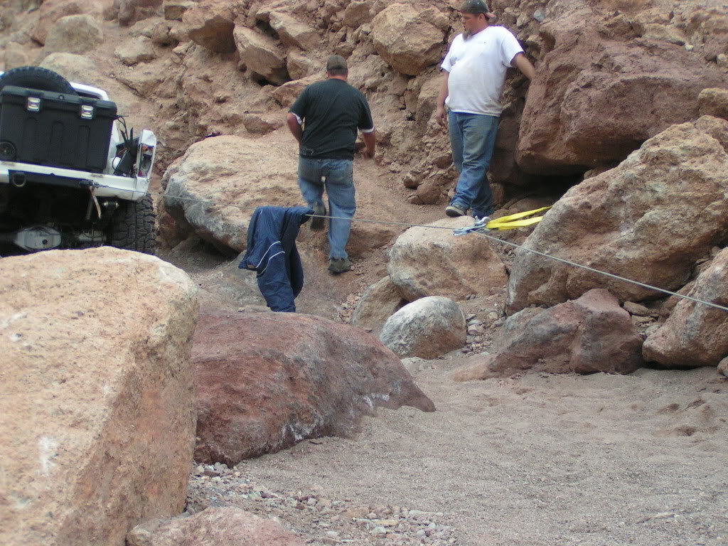

    that one particular pic was taking while setting everything up...believe me and you..everyone was WAY clear once the actual wenching haha started!
