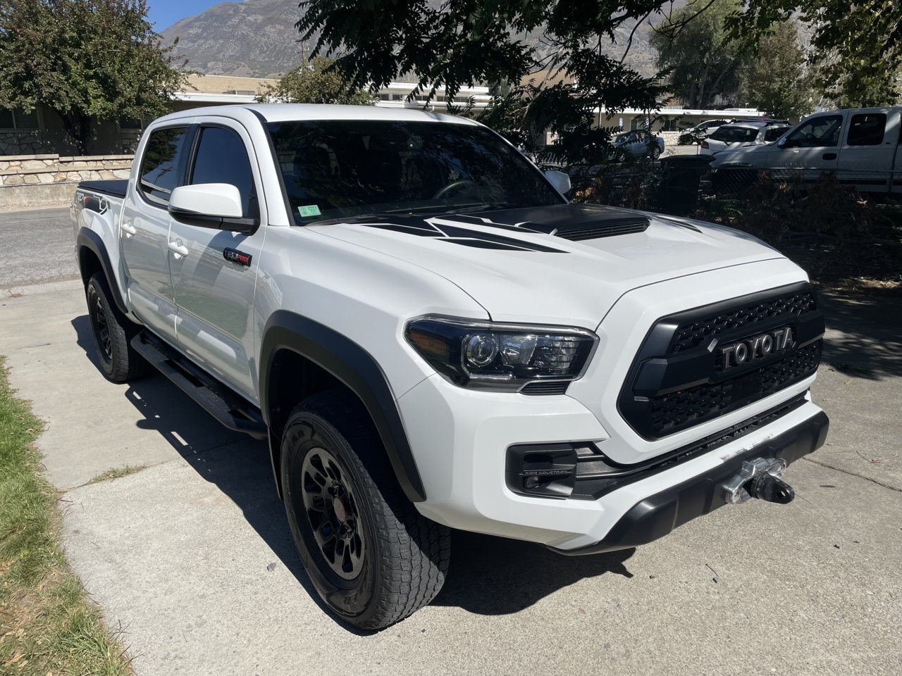

    Hello,
    I'm looking to get 2-3" of my lift on my 2018 Tacoma TRD Pro. I know a lot of people say don't or it doesn't need it but I love the look and stance. What kit and parts would you recommend for the 2-3" of lift.
    Front parts kit?
    Back parts kit?

    I don't think the kit you purchased will fit your truck. That looks like a kit for a non-Pro.
    And yes that's the gist. The springs up front are designed and tested with your specific truck in mind. And the ride would likely suffer less with an AAL over blocks in the rear.

    So with what you're recommending it'll give it about a 1.5-inch lift? I'm wondering if that's enough but If it's possible to not negate my awesome suspension I'm interested. I'm checking on the kit I purchased, I didn't see anything on there that said it wouldn't fit the pro.

    If it doesn't say explicitly it's made for the Pro it won't fit. Your truck has 2.5" shocks and requires different parts from all other trims. I could be wrong here and I'm sure someone will tell us if so.
    The Pro is already an inch higher stock so a 1.5" lift gets you 2.5" over a stock OR for example
