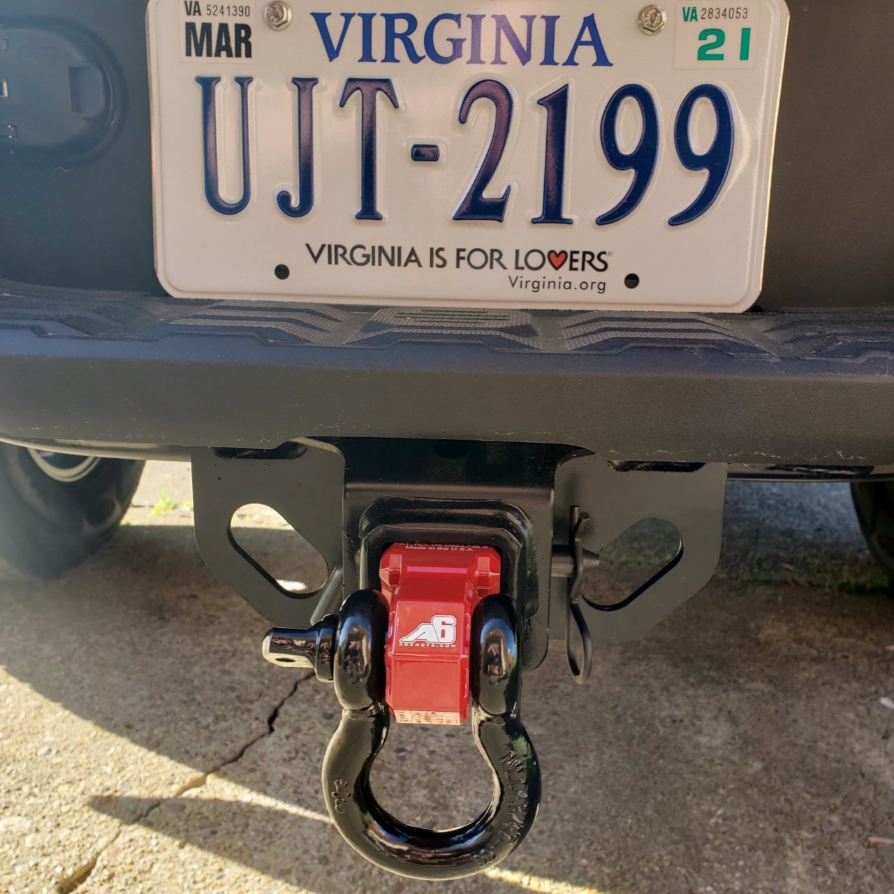

    Recommendations for using a receiver hook ( ) vs a receiver shackle ( ) whether you are the recoverer or the recoveree? Assume a d-ring shackle with a higher rating than the one shown in the link, so that we're comparing apples to apples.

    When it comes to safety equipment I generally stay away from harbor freight. In regards to hook vs. shackle, a closed system(shackle) is safer than an open system(hook).

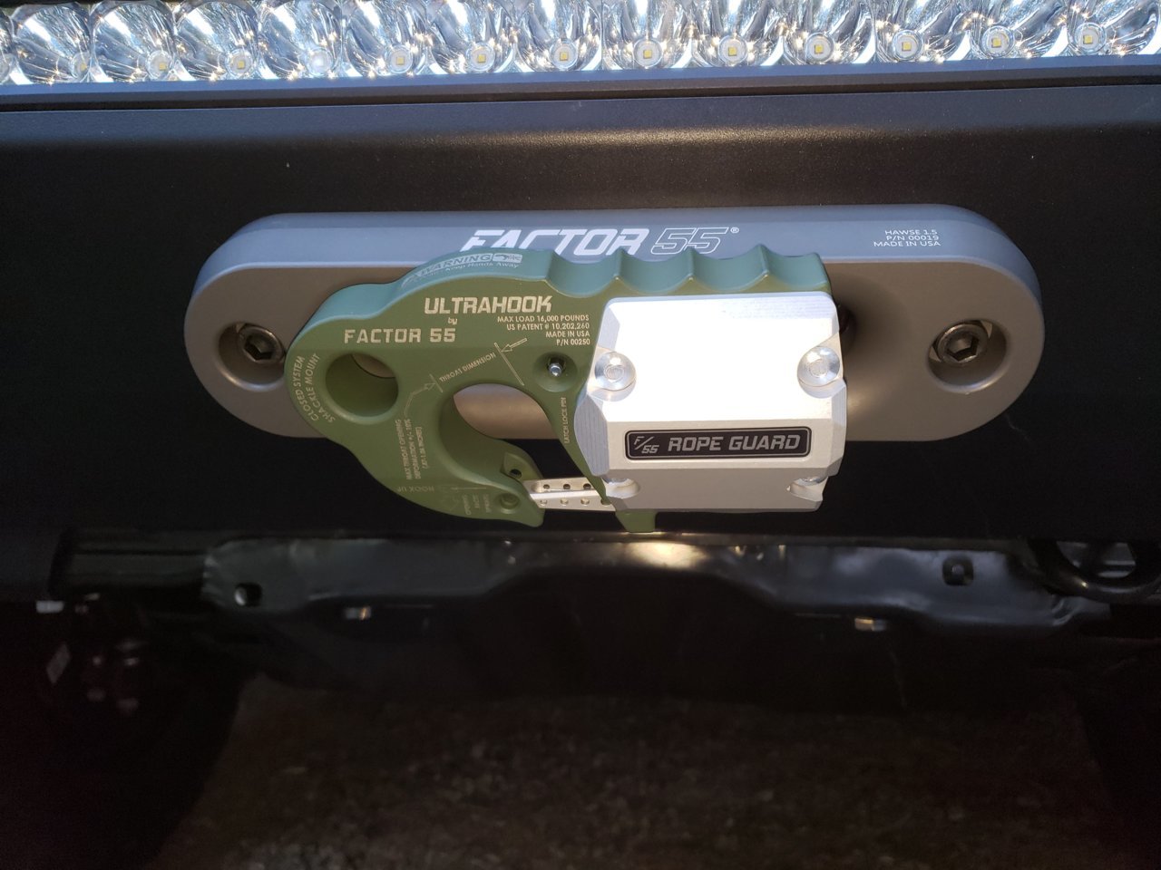

    Have you checked out Factor 55? They have some interesting information about closed system winching https://factor55.com/closed-system-winching/ .
    Shellshock and doublethebass like this.

    I have a hitch receiver with a shackle. I never thought of using just the pin.
    Seems it would be just as strong for a straight pull, but what about at an angle where the strap contacts the outer edge of the receiver? Also the shackle is probably easier to attach/detach a strap from? idk
    EDIT: also, assuming you have a 2" receiver, how is a 3"+ strap going to fit without folding that might reduce its strength? Just being a devils advocate.

    I would get something like this instead,
    https://factor55.com/product/hitchlink/
    The fact they load test the thing I think is good assurance. Secondly, buy a USA made shackle and you should be good to go. If you buy a tow strap, again buy something high quality, I've used the harbor freight strap and under load you could hear it stretching and tearing. Snatch strap is probably better since they are made to stretch.
