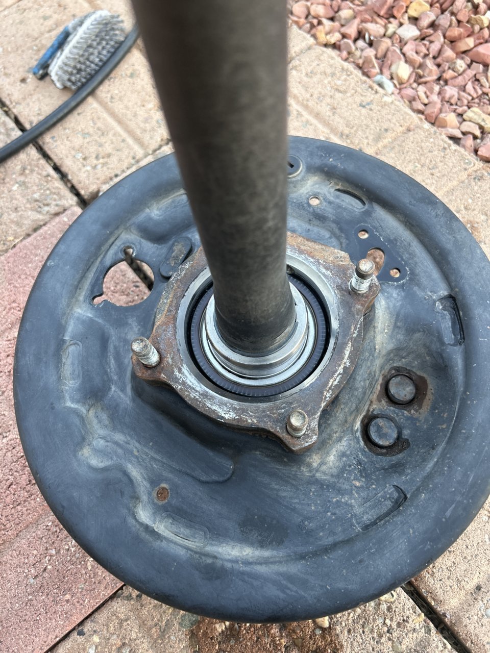

    C23B2270-7CF6-4C36-8021-CD7DA3C8090E.jpg 3C35E63F-3A15-4EA6-95EC-C563C2DB5A24.jpg C23B2270-7CF6-4C36-8021-CD7DA3C8090E.jpg 3C35E63F-3A15-4EA6-95EC-C563C2DB5A24.jpg So my wheel bearing is fine I think. I only need to replace the retainer ring which does come off by itself. I don’t have a press tho and I’m worried about using the torch method and a marble and spinning the shaft while heating it up. Because I’m pretty sure that tone ring is plastic material on the inside and outside. You can see how he puts the marble side down on the ground and heats up that retaining ring while continuing to spin the axle with a pick or whatever he has and letting the heat do the work. That’s all well and good but I fear that would mess up my tone ring.

    I’m talking about this guy right here.

    To get that off you need to remove the clip.
    You can just see it in your picture.

    I don’t think you’re going to remove that without taking the whole bearing assembly apart, at least not without damaging the bearing.

    how do you figure? Behind that seal there’s a abs tone ring, and I believe behind that is the bearing

    According to this video. You’ll need a press and a jig.
    Or if you get creative, a grinder and cutting wheel, and a long piece of pipe.
    That’s not at all the right way. But it the way things get done if they have to be done right now.

    If the gear lube is in your brakes it must’ve leaked past the bearing likely washing the grease out and ruining it. I’d replace it. Just went thru the same thing actually

    You can get that off with an angle grinder very carefully. Put a 6 inch death wheel on and score into it half way at an angle as you go around. Then do it again 180 . Put a cold chisel in the Crack and whack it and it will pop. But if you think that is bad you should do the bearing too as well as the axle tube seal. Chances are the bearing is whooped and running just out of center causing the groove to get worn in retainer and gear oil will pass by it along with the sealed bearing cause it as well is running out of center.

    this is what I’d say as well. More trouble than it’s worth to try to remove just the retainer. Replace everything in kind if the fluid leaked into the bearings it is on borrowed time.

    Take that assembly to a shop with a new bearing and retainer. Have them press new stuff on. Also there could be a groove in the axle shaft where the seal rides. That would require machining, or a really careful sanding to get it smooth.

    Forgot to mention, if you can't find a the tool or a shop that has one it can be made fairly quick with a hole saw and drill and welder. You want basically the flange out on the axle tube out 1/4-3/8 plate with shc40 pipe and some flats on the top for the press table/base. Or a rusty axle housing and chop the tube off.

    Won't be a groove in shaft because the tube seal runs on the retainer .
