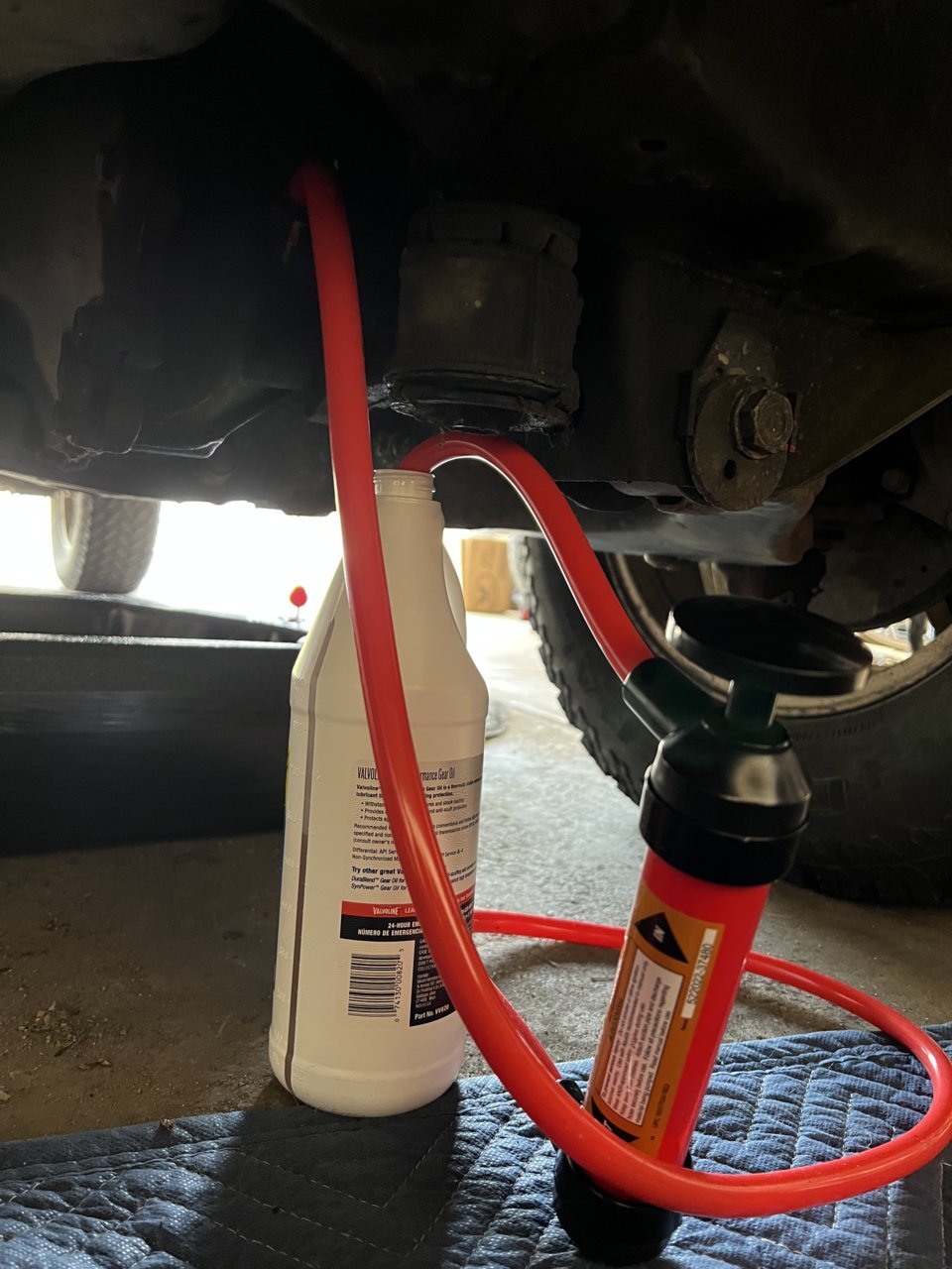

    I just did this on my 99! I picked up this 75w90 for sale from napa. A $6 harbor freight transfer pump made filling the front diff a lot easier, the filler is a little more tucked up in there. You’ll need to remove the skid plates. The transfer case and rear diff were easy. Make sure you open the upper filler plugs *first*, as good practice. Pick up some crush washers from your Toyota dealer and you’re good to go!IMG_2630.jpg IMG_2623.jpg

    cool! I was wondering how to get up in the front. Thank you! Toyota wants $40 a quart for gear oil lol it’s gear oil, not crude oil.

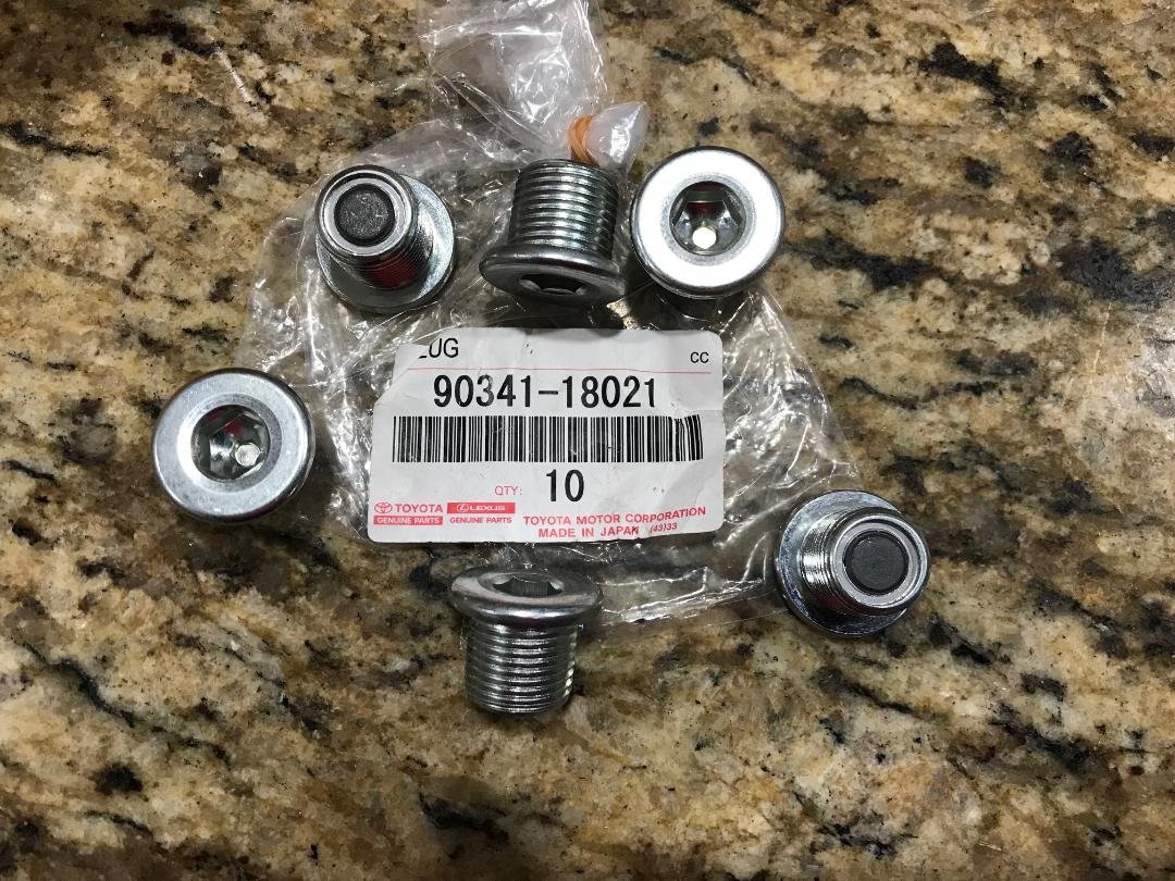

    The front and rear diffs. on the 1st gen Taco have factory installed magnetic drain plugs. Toyota sells both Hex and Allen head magnetic drain plugs for the R150F manual tranny/Tcase for just $3 or so each. They were not installed by the factory on our 1st Gen Tacos but were installed by the factory on the higher priced Toyota/Lexus vehicles & are very worthwhile IMO. In 56 years of wrenching, I have never removed a magnetic drain plug that did not have at least some gooey "fuzz" (aviation mechanic term for magnetic particles) on it.

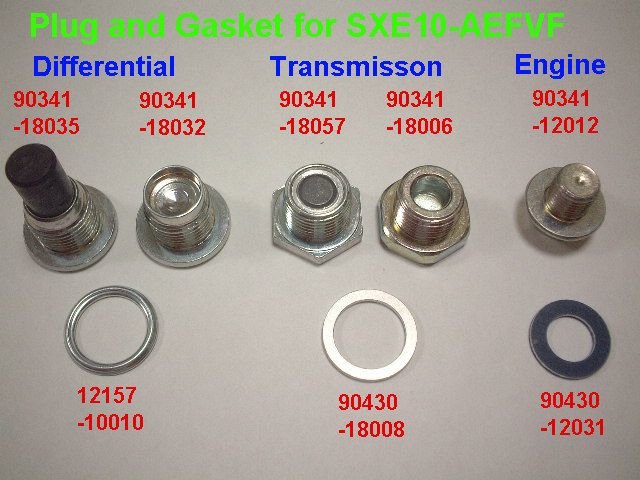

    EDIT: Below are some of the other standard and magnetic OEM drain plugs along with their respective gaskets. Pic is not mine and I don't know who to credit for this useful info.
