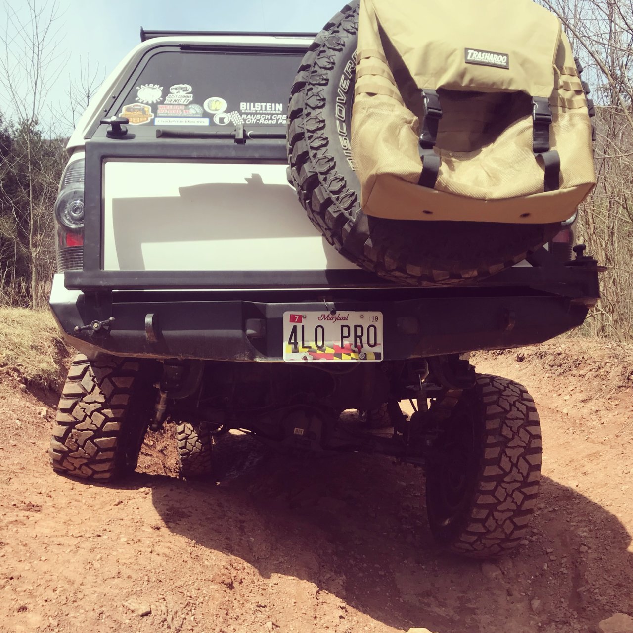

    Keep in mind you’ll be limited to a 10” shock in the stock location, unless you want to seriously sacrifice uptravel. I have the bilstein b110 (a 10” shock) and really like them. This is with Dakar’s and b110 and nothing else, and shocks are still my limiting factor. You’ll be capable of even more droop because of the shackle flip.
    If you really want to take full advantage of the flex, you’ll want to relocate your rear shock and run a 12” or 14” shock. The archive garage relocate is capable of a 14” shock, whereas the bamf one is only good for 12”.
