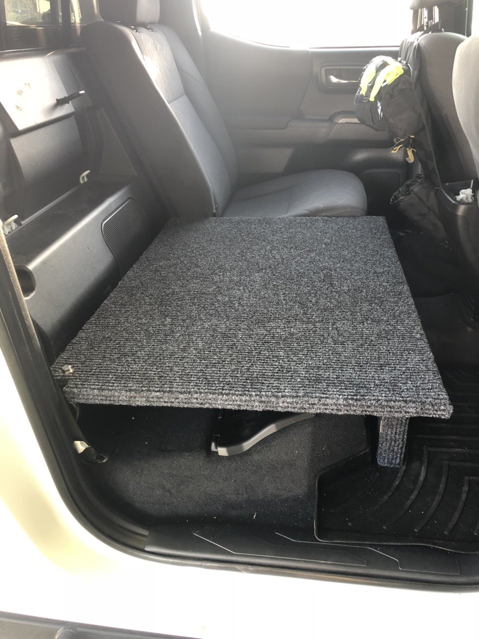

    Since deciding on rebuilding my bed storage/sleeping platform and getting a fridge I was intent on putting the fridge in the rear -- though quickly realized that would significantly cut down on my storage space, and bigger issue -- sleeping space since I typically go camping with my GF.
    Although it'd be nice to have 3 rear seats...reality is I think I've only had more than 2 passengers in my truck on 2 occasions in over 30k miles.
    Hence, pulling out the rear seats and building a quick storage platform. I used the existing hardware that the seatbacks use to fold as an anchor point (it also doubles by allowing access to the under seat compartment). I then made 2 supports with 2x4 (one in center and one on side). I made these supports positioned directly in front of where the stock seats bolt in (so I can rig something up to secure this more heavily if need be). I did this in an afternoon with scrap wood and hardware I had lying around.
    Last pic is my Dometic 75DZ, brand new (for sale: Brand New Dometic CFX-75DZ + Slide + Cover ) -- if I want to use a fridge slide I'm going to need a narrower fridge to accommodate the fact that the door doesn't open fully to 90 degrees relative to the body.

    Resurrecting an old thread. After almost 2 years of just dealing with the huge fridge in the back seat I broke down and built my own fridge slide...so yes you can fit a CFX-75DZW in the back seat of a double-cab tacoma with a slide...unlikely to find an off-the-shelf option though.
    I did have to modify the platform slightly for the fridge slide since the fridge slide works by putting the "drawer" on top of the slides I basically had to drop the height of the platform by about 2-3" and used some spacer and a longer nut to make it work.

    32" locking drawer slides (Ryadon brand)
    32" length 3"x2" aluminum angle
    scrap wood for the base, dressed with aluminum angle
    stainless footman loops to run lashing strap to secure it
    spare 1" tubular webbing for handle (I use this for all my handles on truck storage drawers as well)
