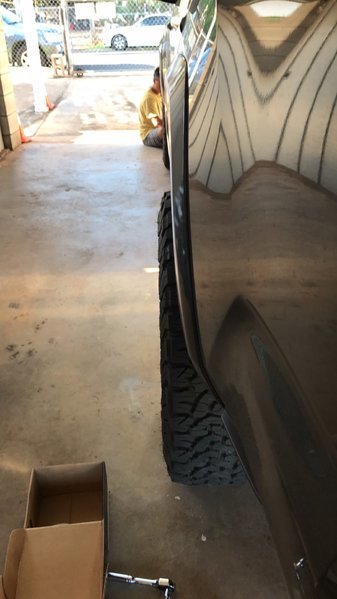

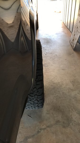

    I lifted my truck with the toytech 3" lift kit and I just put on spidertraxx 1.25" spacers. I have 275/75/17 tires on the OEM trd pro 4runner wheels. After putting the spacers on, it's really obvious that the passenger rear wheel sticks out a good 1/2" more than the left side. The spacers are the same size. It was probably like this before and I didn't notice it until after putting the spacers on.
    Anyone else have this issue? How can I fix it or do I have to buy different size spacers?
    Rear left.
    Rear right.

    Your truck also sits lower on the drivers side.

    There was another thread on this, can't remember the outcome. Have you checked your bed alignment? Going against bodywork for any alignment or lift is a mugs game, you need to measure to the frame. Check to frame, then you'll find out if it's axle or body problem.

    Bed alignment is off

    Like @smitty99 said. 3rd gens are known to have beds out of alignment. You notice it now because the wheels are sticking out. Check gap and alignment between bed and cab on both sides. Mine is off and will fix myself soon.
