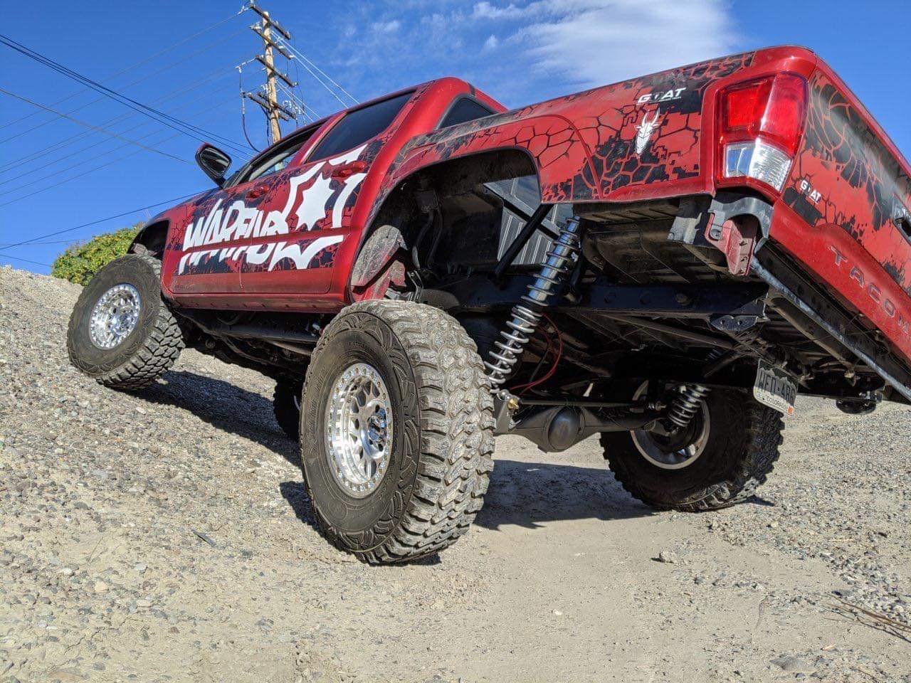

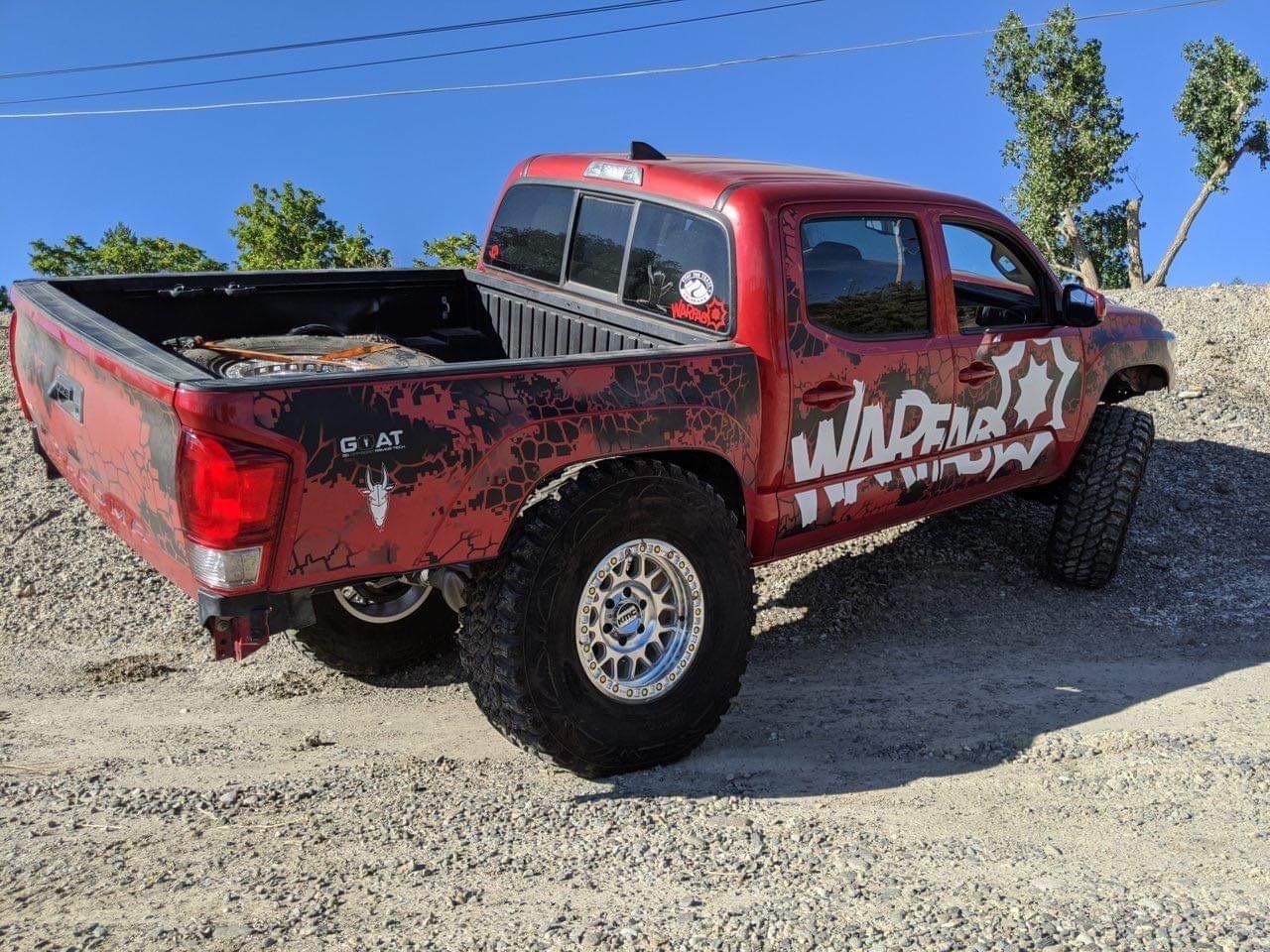

    42F8DBF3-E718-47C8-9A17-6D4CEBEED803.jpg Ok. Need the community. Don’t want to get this wrong again. 2020 DC SR5. 35’s. 4.88’s. Arbs front/rear. Front +2 TC with secondary triple bypasses. All the usual spindle, cam tab, etc reinforcements. Not sure there is much More up front I can do there without glass and wider. Rear just finished with SUA, Deavers, 1.5” spacer and shock relocation king bypass with air bumps.
    Problem is still a little rough on the mountain, especially in the rear so going to do more, just not sure what and don’t want to do it a 3rd time with only about 1500 miles on current setup. Thoughts are bed cage and change the leafs or link it.
    Constraints with build are I don’t want to give up the bed as I pack a dead elk fairly often or other piles of crap I need it for. Don’t want glass fenders as trees won’t be kind and I just wrapped it. No decent options for gas tank relocation until someone makes one for the spare tire area.
    Planned uses for me. Winter travel in deep snow chasing lions. Spring snow chasing away cabin fever in soft clay ground and residual snow drifts. Summer travel for cooler elevation over dry dirt and rocks. Fall travel hunting sfuff over a mix of all. Most roads are narrow and rocky With pickup used 90% of TIME on dirt with maybe 50% of MILES on dirt. What is my best option, given the constraints to improve ride quality? Can steel fenders be flexed out to allow more up travel? Is there a gas tank option I haven’t seen?

    What SUA, TC? Shock tuning is often overlooked with shock upgrades and it's as important as anything you invest in while modding your truck. Even a linked rearend will ride like crap without shock tuning.
    This is the cheapest legitimate link setup (you can just go out and buy) I've seen where you keep all the stuff you wanted. I imagine you could fit stock bedsides back on.
