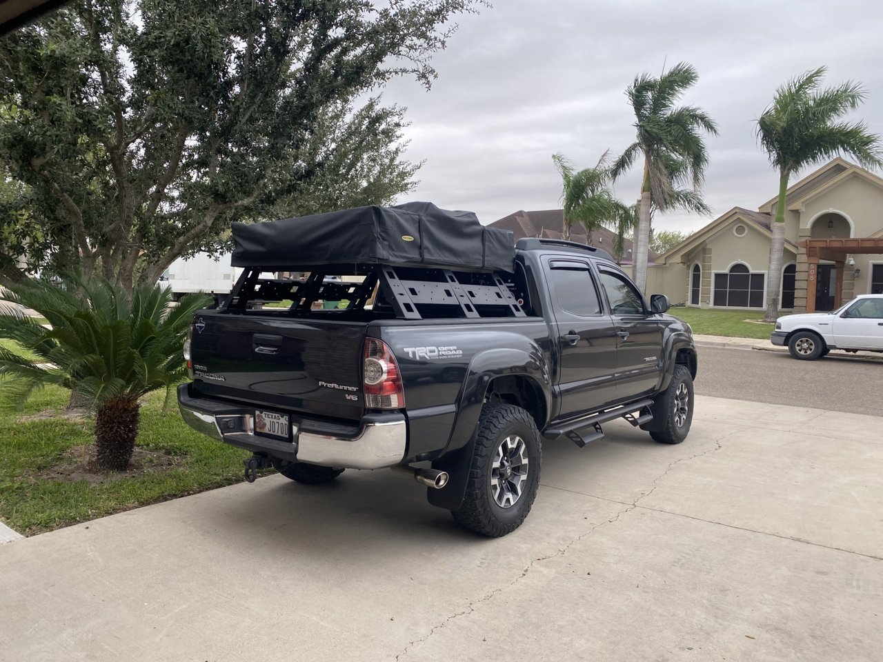

    I’ve got a 2/1.5 spacer lift on my truck and it rides dang near stock, but the truck sags carrying more than 2 cases of water bottles. I think you should go with the Deaver 1.5” AAL.

    My 2008 has a Bilstein 2/1.5 lift using an AAL in the rear, and it takes way more than water bottles to make it sag. Like someone above mentioned, your truck will ride a bit stiffer with an empty bed.
