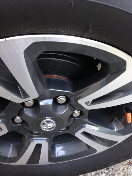

    image.jpg Just an FYI; at your next service, ask your SA to note this annoying rust area on the rear drum. If it spreads, Toyota should fix it. Both sides are showing.
    I passed by my dealer today and my SA said shes aware of it.
    It's not a big deal but at 800 miles, it's a bit early imop.

    Normal. It's bare metal. I painted my drums, leafs, exhaust, etc. a long time ago.
    Take your wheels off, get some Rustoleum Rust Reformer and paint those drums before they get even more rust on them.

    Yes...they all do.

    I'm not sure. I just wanted it noted as this model is still quite recent and I haven't had a car with drums for a while.

    I might also add that because the drums are iron and the wheels are aluminum, the two dissimilar metals will react and corrode. This can get so bad that they fuse together and make it difficult to remove the wheels from the drums.
    You might also want to coat the face of the rim that contacts the drum with a light coating of paint or some sort of protectant.

    All drum brakes that have a bare metal spot will look like this, completely normal

    Wash your truck or let it sit out in the rain overnight. Note the rust on your front rotors the next AM. Report that too. :thumbsup:
    :rofl::rofl: It's a chunk of cast iron. It will last longer than you or I. They aren't gonna do squat about the rust.
    The great news is your SA got a new item for her list of 'guess what a customer asked today?' for lunchtime chatter.

    I typically wash in the late afternoon, and see the rust the next AM, so that was first thing that came to mind. :p
    Just needs to sit a while to allow the rust to form.
    Get some of this stuff http://www.por15.com/POR-15_Rust_Preventive_Coating and gussy them up. You can use it on the un-swept portion of your rotors as well.
