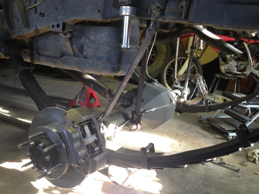

    I got about 90,000 miles out of mine. They were really expensive to replace though. ;)
